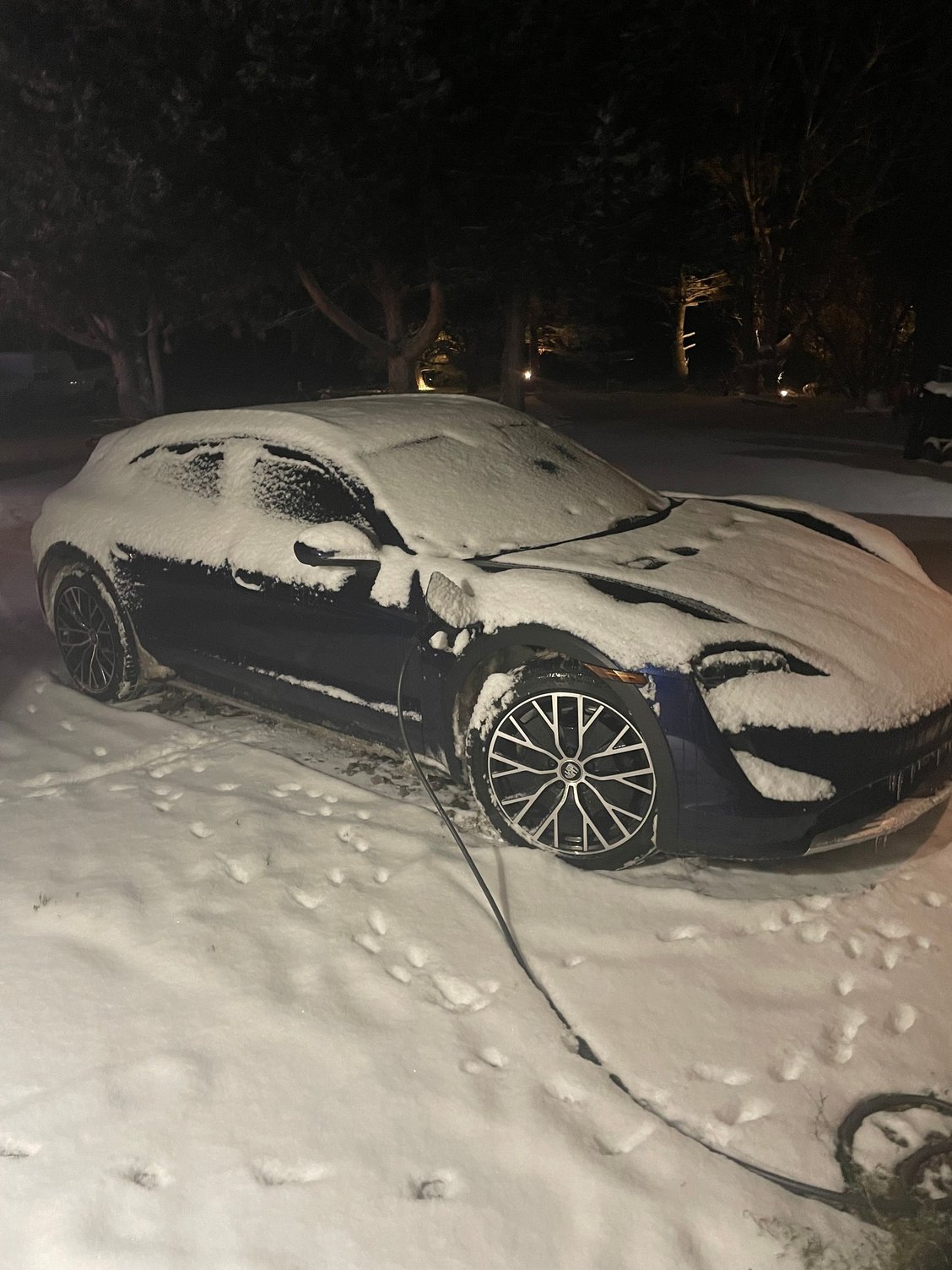

I had no issues charging in the snow this past winter.
Didn't think of, at least, wiping the snow off the charger port? Also who/what walked on your windshield?

When I parked and plugged in it was not snowing. I did brush it off before pushing the release button. If you notice on the charge controller at least the Porsche version the power output goes to zero. Kind of hard to get shocked with zero juice. I have a few farm cats that wonder around at night.
