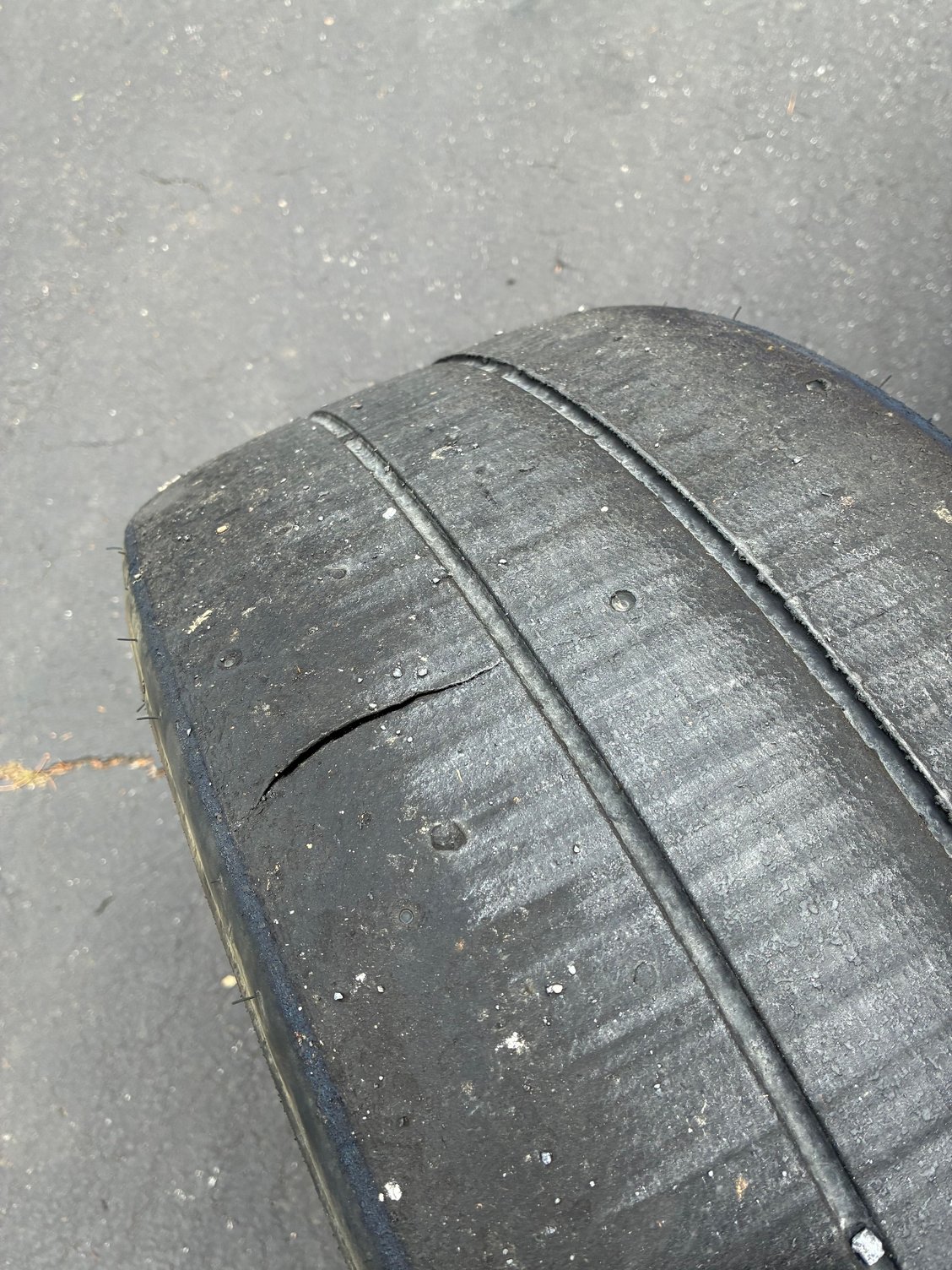

This is after 5 heat cycles. Splitting at the seam. They were mounted in the correct directions, per Toyo’s guidelines. It sounds like some other Boxster drivers have experienced this recently, as have E36 drivers. Anyone here experiencing this? Potential batch issue?

I was told at the start of the season that the new mounting was all “yellow dots out”. At Laguna Seca in August a Toyo rep notice this set and told me they still need to be mounted in the same directions we used for the RRs. Only ones that have split so far on me.

I've had two sets of the Rs do the same thing.

Date codes? This will be helpful to try to see if it is related to the same batch(s).

The date code on that tire is 0225. The separation was happening on the inside of my right rear tire. The last two heat cycles were at Summit Point.

I had the same issue in the second day of use of this tire. they were mounted to spec, and 1 failed badly, 2 of them started to fail already.
extremely disappointed.
I contacted Toyo regarding this, they just shrugged.

It’s not excellent. For what it’s worth, when I spoke to the Toyo rep I asked if this has led to any failures he told me it hasn’t. So I’m curious if anyone has actually experienced these tires failing when the seam separates like this?

Toyo advises that once there is an open tread splice, the tire should immediately be removed from service and replaced. Not sure I want to press my luck and see how far these tires will go while falling apart.

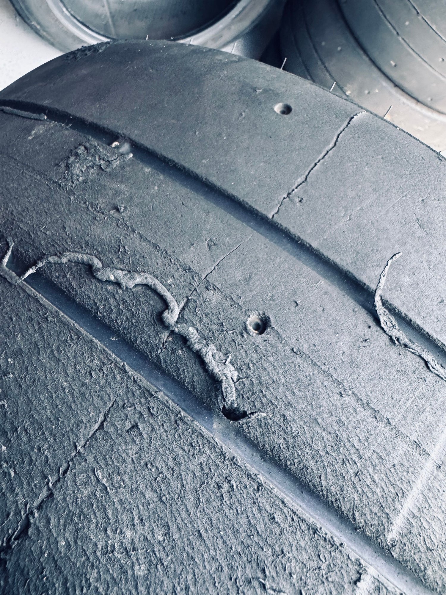

6 heat cycles. Left front. O6/2025
I have spoken to 2 other SPB drivers with same issue.

All three of my sets have done this and all tires were mounted per Toyo RR standards. To be honest, I would rather be on the old tire, these are faster, but clearly heat cycle out much faster than the RR's.
