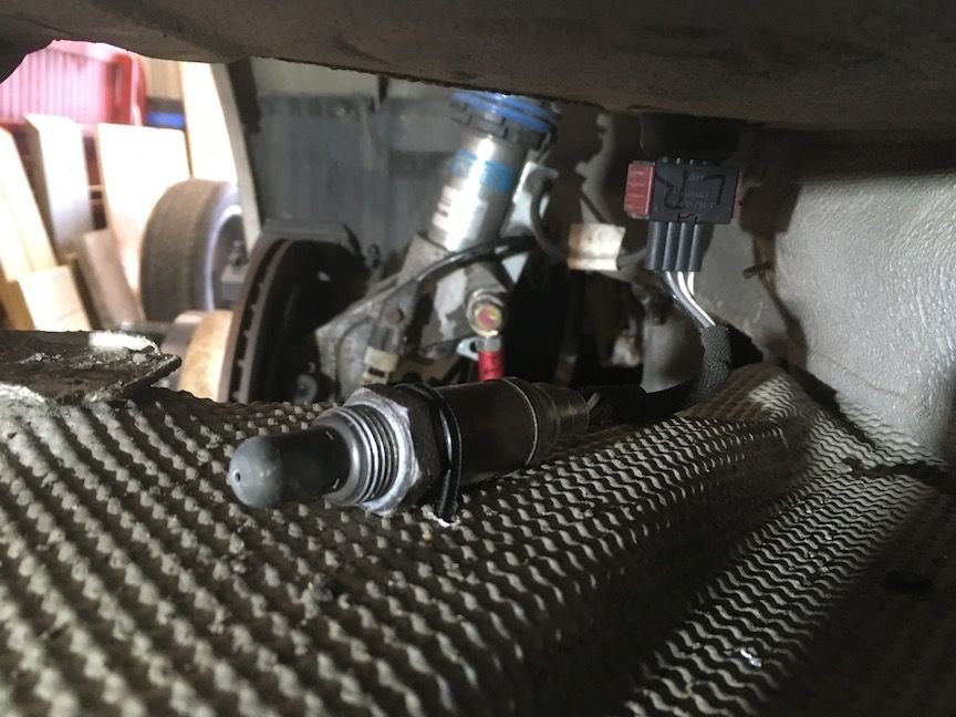

It will run fine. I removed my cats ('98 with one set of cats), the first set of O2 sensors are in the headers and the 2nd set I have zip tied up in the body work. Since they are still sampling the air they're kind of being tricked that all is well, sort of. Every now and then on a long highway drive (usually to the Glen) the CEL lights up and in 1 minute i have it cleared with the app on my phone that is connected via a bluetooth OBD transmitter. Yes I street drive my SPB to the track.
Taping up the light will work too but you won't know if something actually serious might be happening, I still pucker a little when it comes on but it's always the O2 sensor.
A good Porsche race shop might be able to get the "Learning codes" from a friendly Porsche dealer and have your ECU flashed with the ROW tune which is legal by the rules. All it does is ignore the O2 and SAI sensors.
Side Note: I've been told the tip of the O2 sensor gets intentionally super hot, so be careful where you place it and that the tip is not touching anything.
