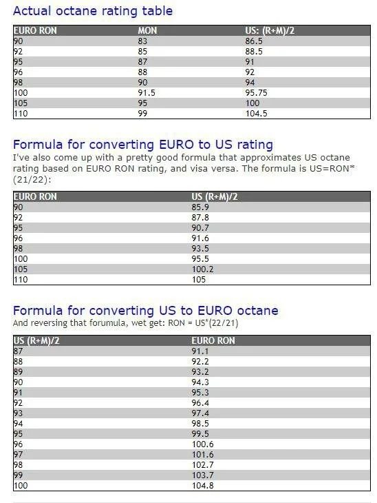

Heres a good link for the conversion
Octane conversion chart US vs EU | BobIsTheOilGuy
