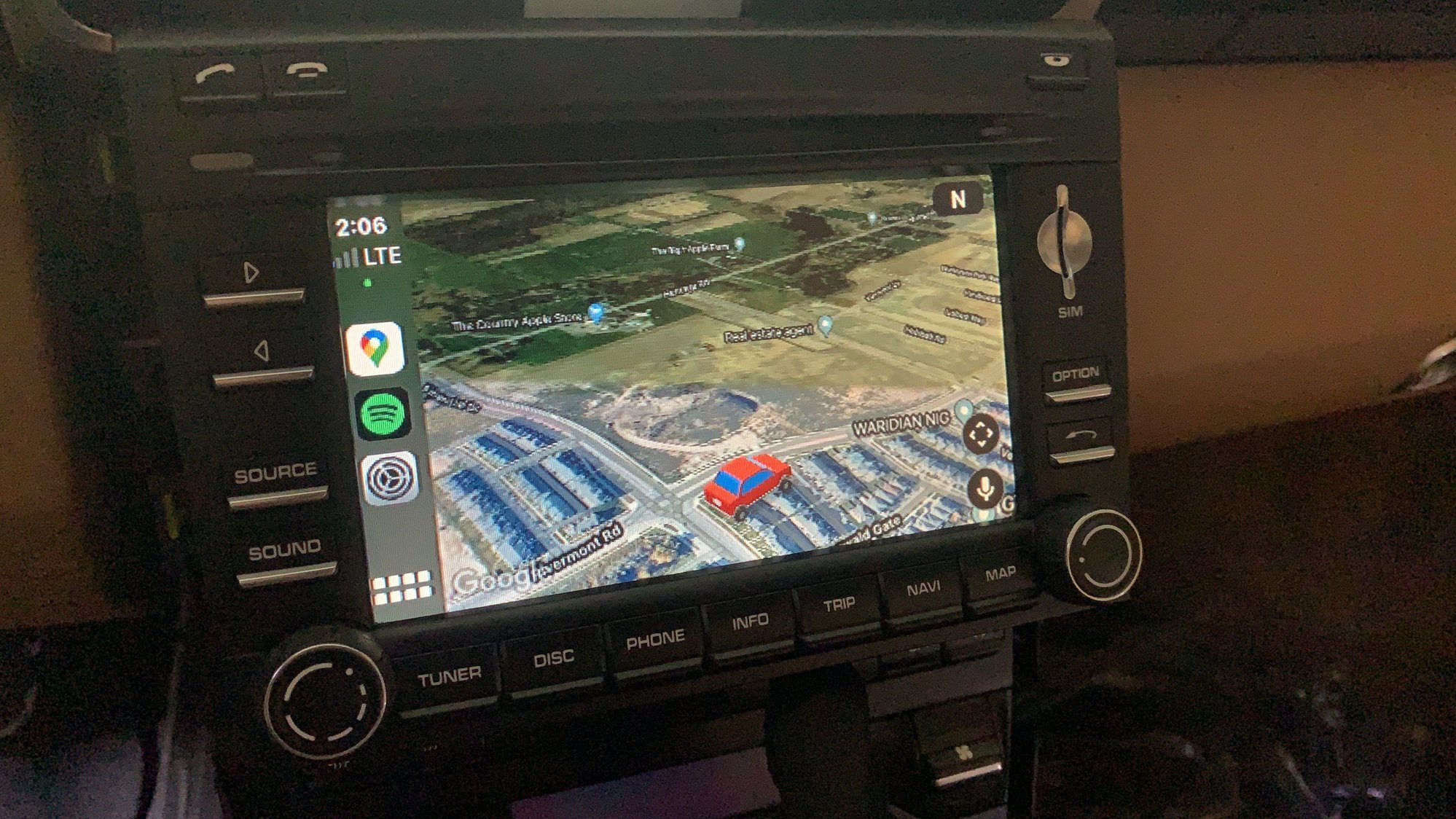

Hello fellow enthusiasts,
im in the process of installing JoyeAuto CarPlay module in my 2009 Porsche Carrera S equipped with PCM 3.0. So far I was able to complete the install successfully. However, I am unable to get the sound to work. To get the sound working I need to code Aux for my car. I have heard this requires some coding and PIWIS is required to get the job done.
Is anyone able to assist or point me in the right direction of a shop that can complete the desired programming.
im located in GTA area (specifically Mississauga)
any help is greatly appreciated
