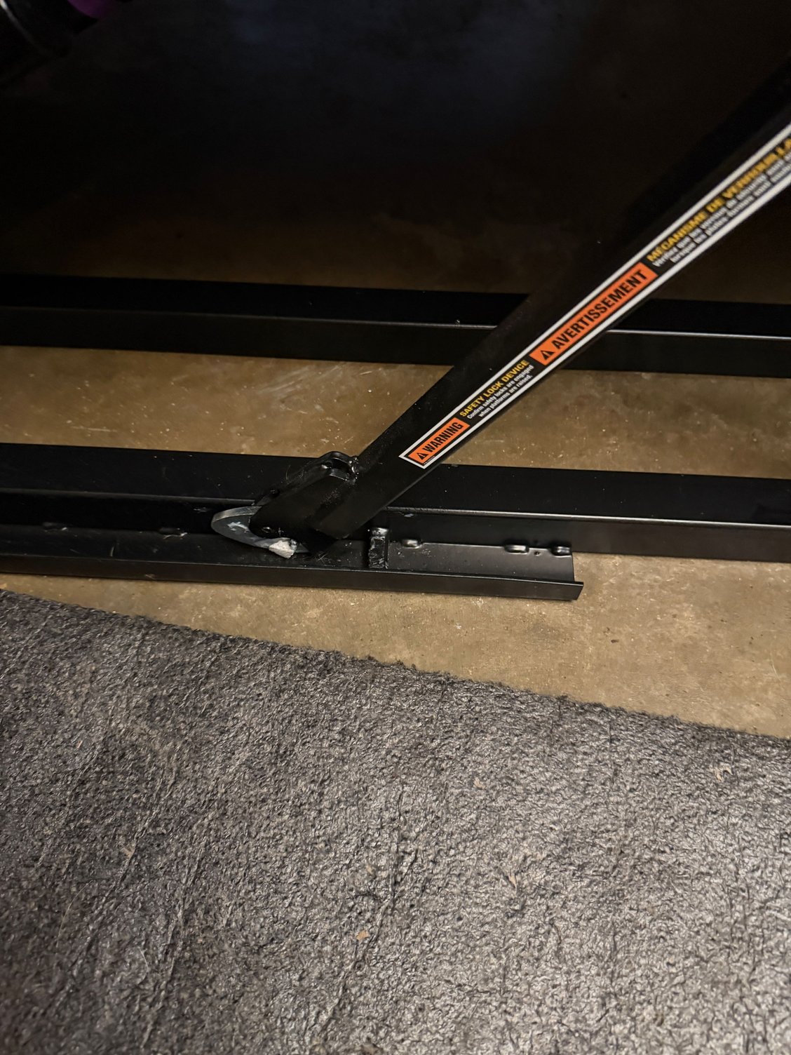

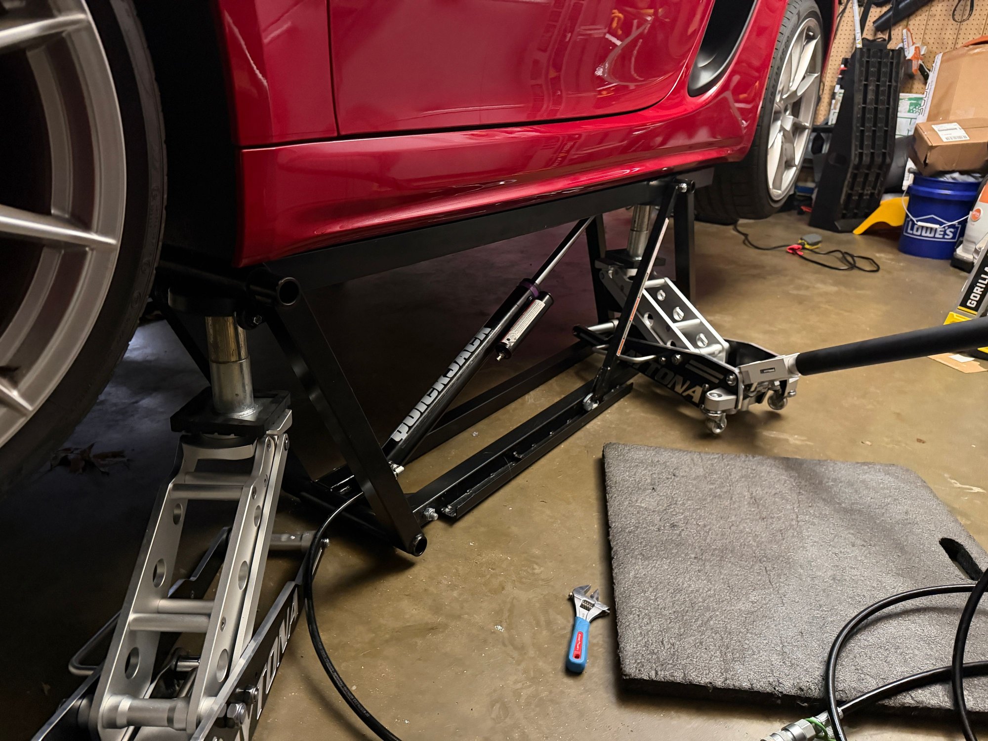

I wasn’t sure where to put this, but I figured the people in this forum are lifting their car more than average.
Just wanted to throw this out there for those of you that might be new to using quick jacks. Maybe it’s common knowledge and I just missed it when reading about how to use them.
I had my car in the air and had the jacks locked out… or so I thought. Mistake number 1. I swear I checked it. Must not have. But I digress. Anyway. I took the hydraulic lines off to make it easier to move around the car. When I went to plug them back in, they just would not connect. Semi common problem. Hit the down button and relive some pressure so says the internet. Which I did. It worked at the controller, but still wouldn’t connect at the lift. I was thinking about bleeding the lift. Thankfully I looked at the lockout before I did it. I imagine it would not have been good. Since I couldn’t connect the lines, I had to actually jack up the magic jack to relieve the pressure.
Moral of the story. Always check the lockouts. But if for whatever reason you thought you did and the lines are hard to connect, stop and ask why. There is pressure coming from somewhere. Don’t just blindly troubleshoot. Make sure the lift is secure before you start messing with it.
I’ll throw a few pics in for the visual learners out there.
