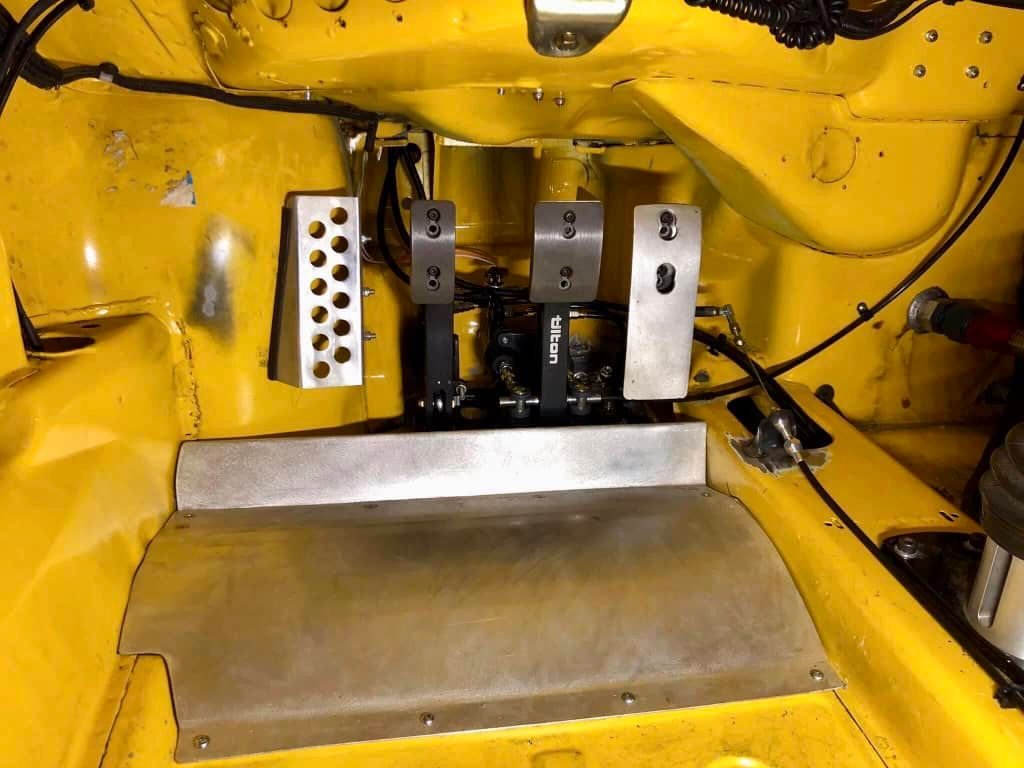

You mean like this?:

Winders pic is what I was thinking about. If converted streetcars have carpet etc pulled out and now a platform is needed how do we decide what is optimum height for each driver? Do we make a platform for example that puts the ball of foot at the brake pedal midpoint minus 1/4”?
Note that my platform has a curve to it. It is shaped that way to provide me with a heel stop and to keep my right foot down at the heel stop. I set the pedal height using the pedal height adjustments afforded by the pedals themselves. It works marvelously!
The only time my right foot is on the platform is when I am not braking. Otherwise it is off the platform when braking and when heel-toeing. The left foot is on the dead pedal resting on the platform unless I am using the clutch. Then the left foot is off the platform. If had a sequential box with paddle shifters, my right foot would never move away from the gas pedal and would always rest on the platform. I don't know, but I suspect my left foot would rest on the platform unless I were to brake hard then it would probably come off the platform to provide more pressure. I could be all wrong there as I have never setup a pedal cluster for that setup.
