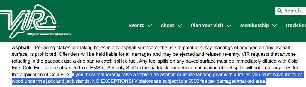

Thought i'd revive this thread instead of starting a new one. I am preparing my punch list for self support and noticed that a few tracks have asphault policies that say you must use metal or wood underneath jacks and jack stands. I had not previously considered this, wondering if i am overthinking this and to just send it with the N2 airjacks or do you guys that self support really lug wood and or metal to the track with you? I am assuming the Demon Speed saftey stands would suffice but they are backordered and not expected in until April -May.

3 x 2'by2' 3/4" plywood will do the trick for airjacks

Air Jack Support: If you're looking to build a system to support your air jacks, save yourself some time and frustration, and just get the kit from Demon Speed, seriously (https://demonspeed.com/product/air-j...ogen-hose-kit/ ). Then get a tank and find a local industrial gas store to get it filled. You only need a 60cuft tank. It will hold enough for a few weekends. Then just go back and get it filled again - this ain't the apocalypse. And if you have a 25ft or even 50ft hose, who needs to lug it out of the trailer or truck. I built a jig to hold the tank secure. 25 feet is long enough to get to the car and jack it up. It's not like we park our cars a million feet away from our support truck or trailer.

Use the harris regulator on your airbottle to slowly bring the pressure of the airjacks up. They won't air-hammer into the ground that way and won't damage the surface (learned that the hard way in my garage).

in the summer, hot asphalt will get damaged if you put too much pressure ( jack stands etc ) ... just use square plywood pads and problem solved
