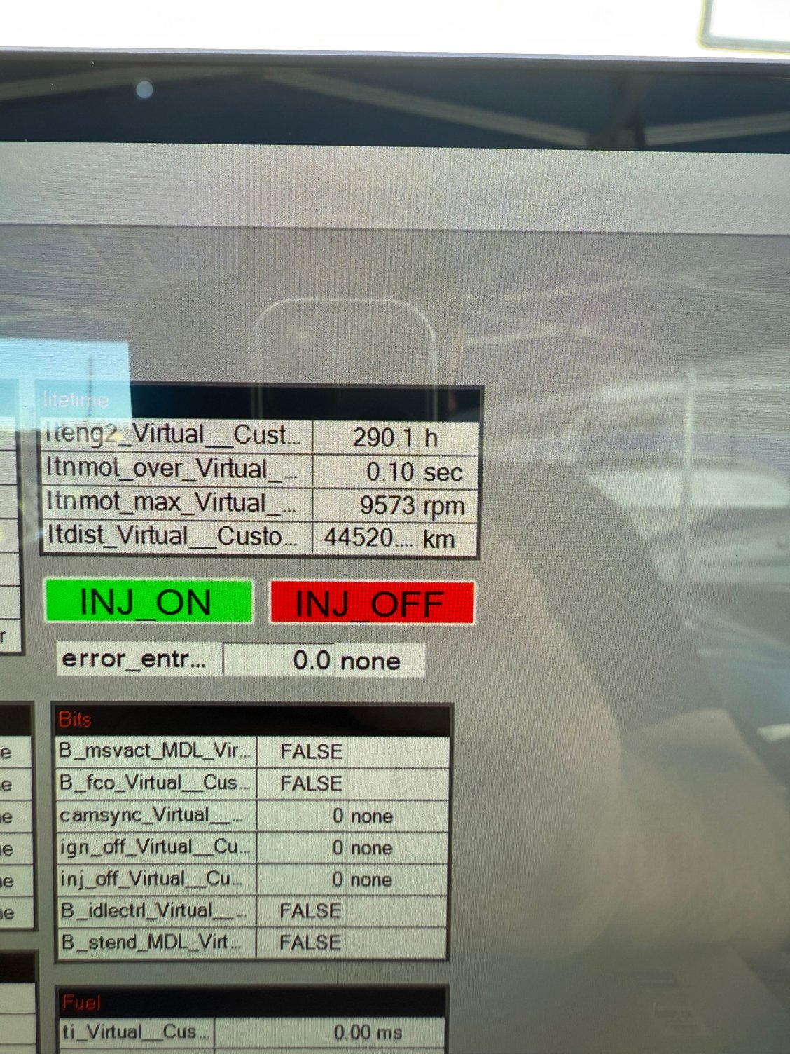

Originally Posted by Williamsf1
Has this advanced now we see more 991.2 cups in private hands?
got it up to 290 hrs without a rebuild, never touched the engine. Just regular maintenance

Super impressive what oil changes can do!
are you dropping both gear and engine oil every 3 track days?

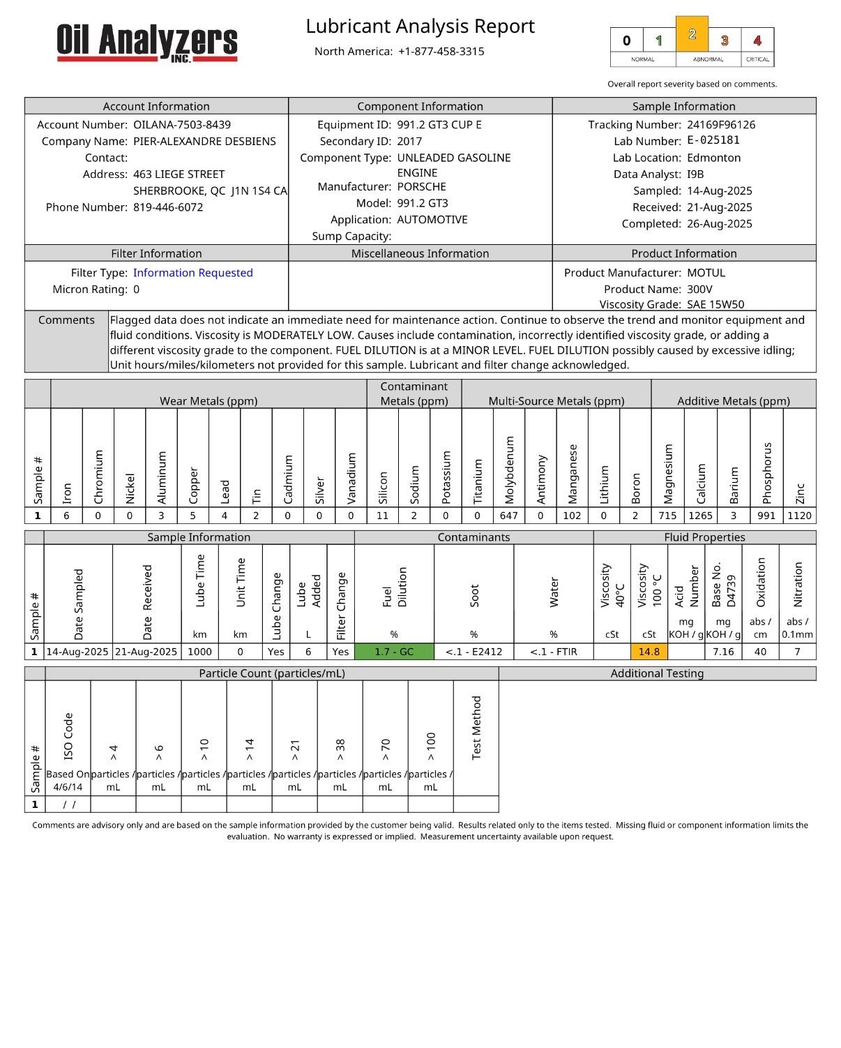

I change the gearbox oil after every event (2-3 days) and engine oil every 2-6 days
using motul 300v 15-50 since new
