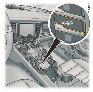

1. Key fob trunk release - not too my knowledge.
2. Air suspension - take a peek in the wheel well. With air suspension, you will see the airbag assembly in place of the shock/strut. With air suspension, there is a button to raise the car ("high level")
3. The hood changed between model year 2013 and 2014. Do not know if they are interchangeable.

Thank I definitely don't have the button but I was wondering how you can put suspension in stiffer sport mode without it? I'll take a peek under the car.

PASM feature is separate from air suspension. PASM controls suspension firmness and is a prerequisite for air suspension.
