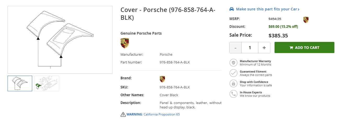

I then came across the below photo on eBay of the dashboard. I was under the the impression that this was a separate leather cover but it appears this entire unit will be replaced, along with likely hundreds of associated sub-assembly parts.
It's now giving me a lot of hesitation that this may introduce squeaks or rattles into which would be far more unbearable than a few cosmetic dashboard issues.
Has anyone had their dashboard replaced at a dealership and can you let me know the outcome?
I'm trying to determine if there are any risks, either immediately or down the road of noises induced by this swap, which would be unbearable considering the car is not making any dashboard noises right now.

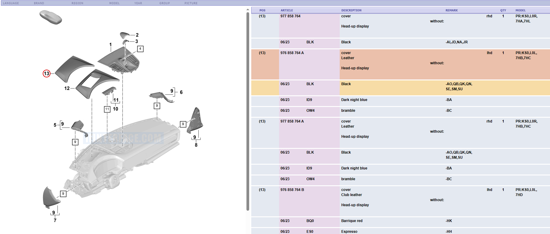

I got the car back today after a week and a half at the dealer. After an initial drive, no noises and the work appears to have been done cleanly with no immediate collateral damage to any other interior parts.
Almost immediately, I noticed those same leather bubbles just behind/above the cluster, per the second photo in post #3. That had me worried, but I then realized it was the same piece that was moved from the old dash. Looking at the below photo, the entire section is a panel, and I do not have HUD so its a smooth leather piece that appears to simply snap in and out.
I found it in a parts diagram and I'll see if the dealer can provide me with a new one under warranty. I am happy to install it to keep custody of the car. Fingers crossed that nothing else comes up, but I am very pleased so far even though they should have ordred that panel, its not that noticeable.

Great news! It's such a shame they do all that work and leave the last bit out...Baffles me that know one bothers to look and realise why they were doing the replacement in the first place. They should get you the part, but at least as a worst case, it's a cheap part.
