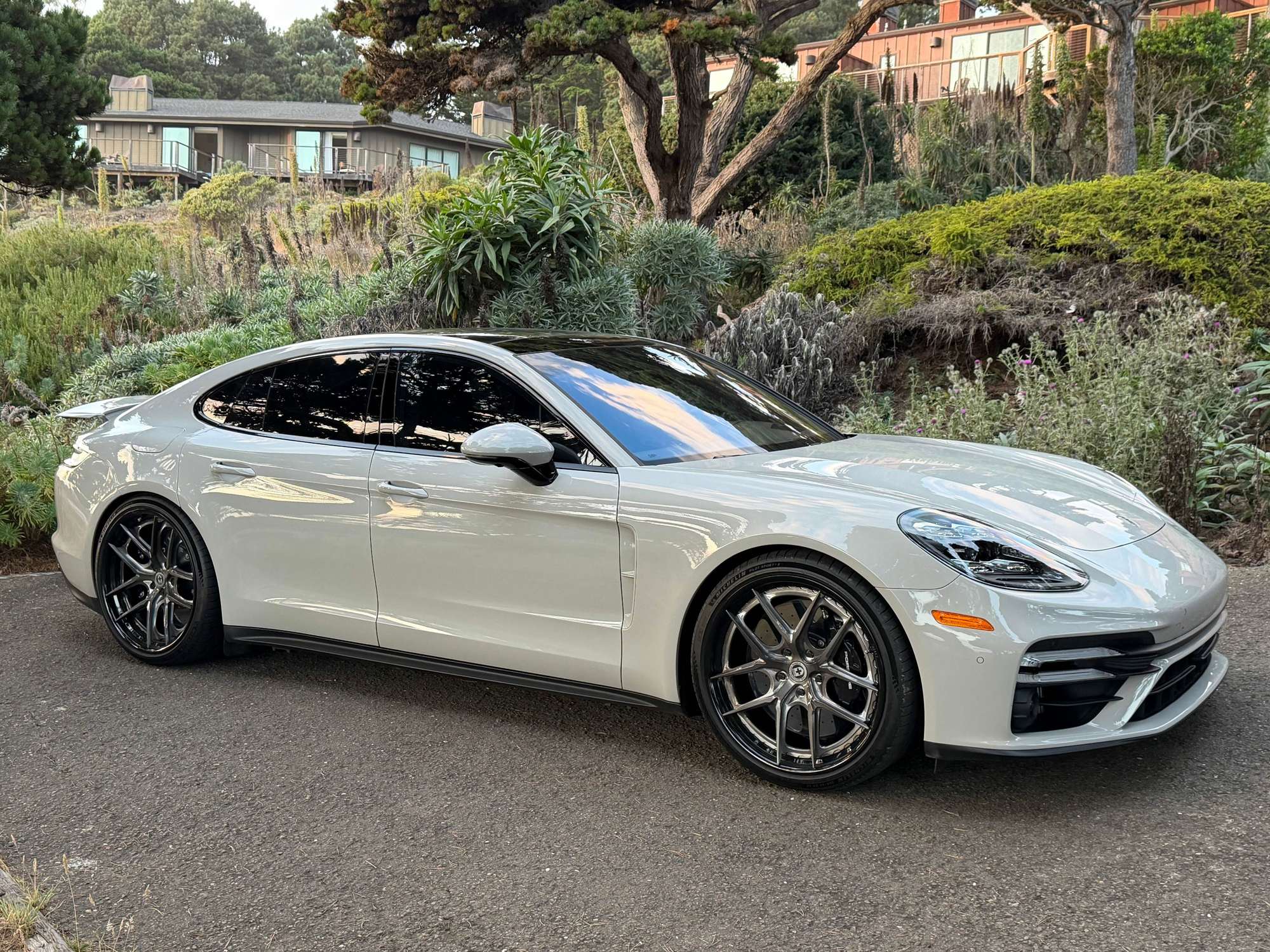

I don’t want to come too far out as I presume there’s a risk of the tyre hitting the arch
I made the mistake of purchasing some gts wheels after checking the offsets.
they are 21”Width: 9.5J 11J
Offset: et46 et58
The rears are fine but the fronts protrude 25mm which doesn’t make much sense as the stock ET was 71. Yeah they’re wrong but not by that magnitude.
so I don’t have much confidence to sort without some guidance.
55 front and back seems to be common.
