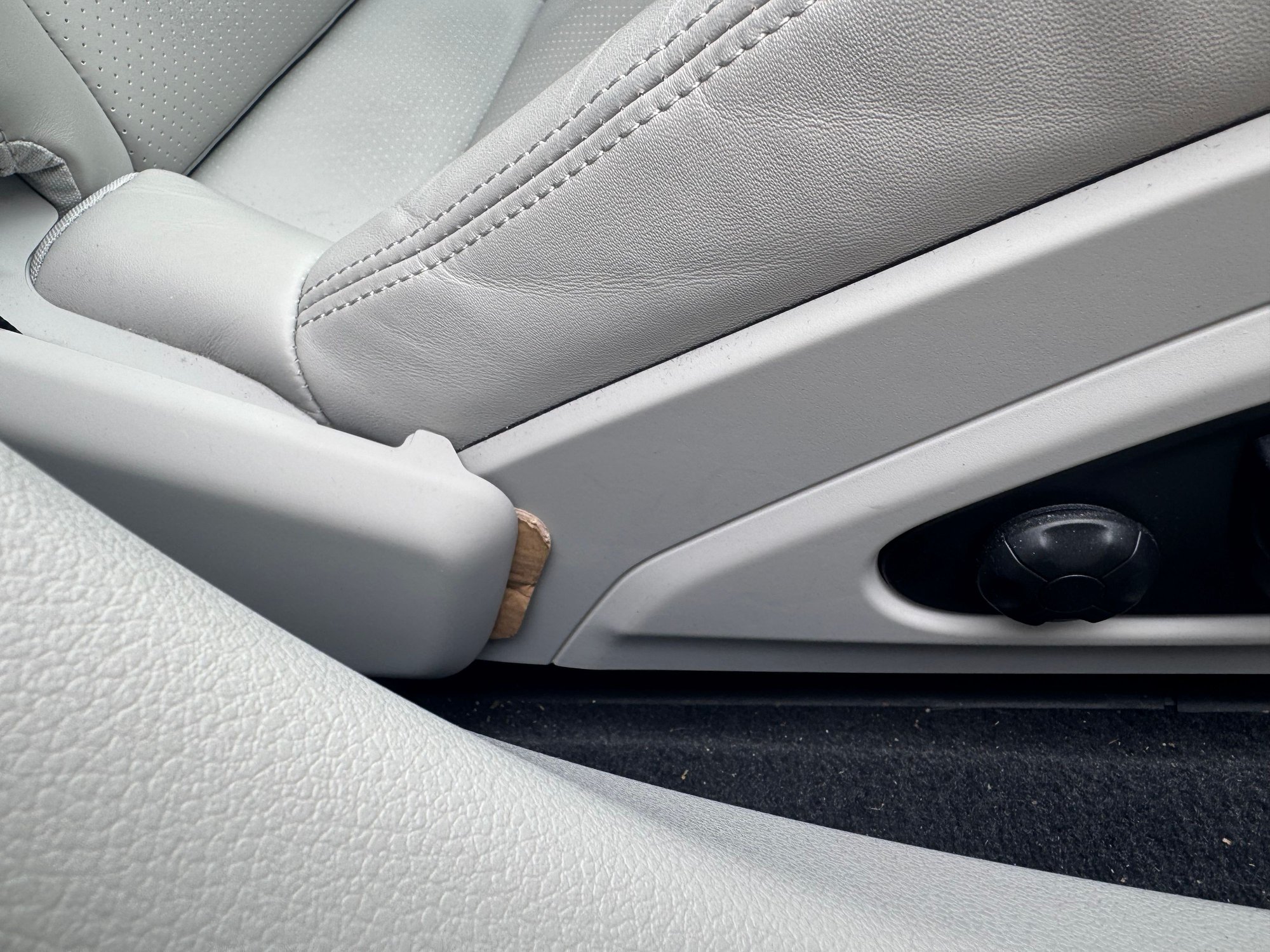

The driver seat of my 2020 Panamera (971) makes "clicking" or "cracking" noises.
It sounds al bit like you are operating the seat controls. However the seat doesn't move or adjust.
Anybody with the same experience?
(and how did you solve it)

Yes. It happened on my 2019 and 2023. It’s the plastic piece on the outside of the seat where the seat back meets the base. If you pull it outward with your fingers you will notice that the crack disappears. I fixed mine by bodging a thin piece of card in there. There will be a more sophisticated solution in sure.

Spent some time fiddeling with it.
There are actualy 2 pieces.
Can you help me with a photo with an arrow or something?
Regards

Here’s my low tech fix

Amazon.com: Siless Anticreak Tape 1 Pack 1 inch x 20 ft Anti-Rattle, Anti-Squeak, Anti Creak for Cars, RVs, Boats | Perfect for Dash, Doors, Seatbelts, Interior Trim, Wiring : Automotive Amazon.com: Siless Anticreak Tape 1 Pack 1 inch x 20 ft Anti-Rattle, Anti-Squeak, Anti Creak for Cars, RVs, Boats | Perfect for Dash, Doors, Seatbelts, Interior Trim, Wiring : Automotive
You can use this if you want it to look nicer.

Have the same thing, I played around with some felt. Seems to be more prevalent in the summer.
