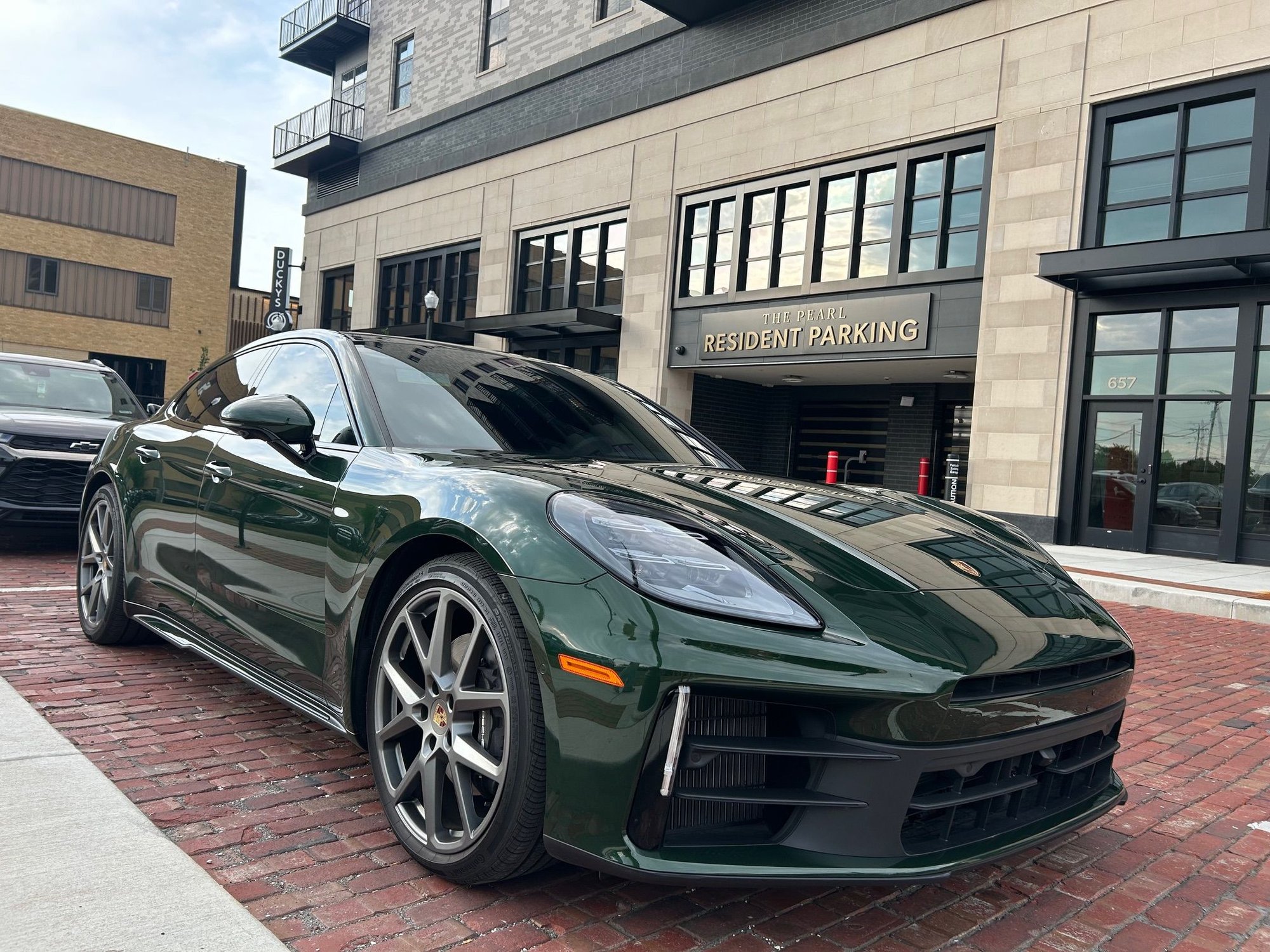

Rennlist - I am considering buying some winter wheels for my 2024 Panamera. However I am not familiar with tire and wheel sizes. Looking for recommendations on what sizes I need to be looking for. I am in Northern Indiana. Considering just buying a junker for the winter too. Any reasons why this wheel set would be a bad move?
considering a cheepo tirerack solution
