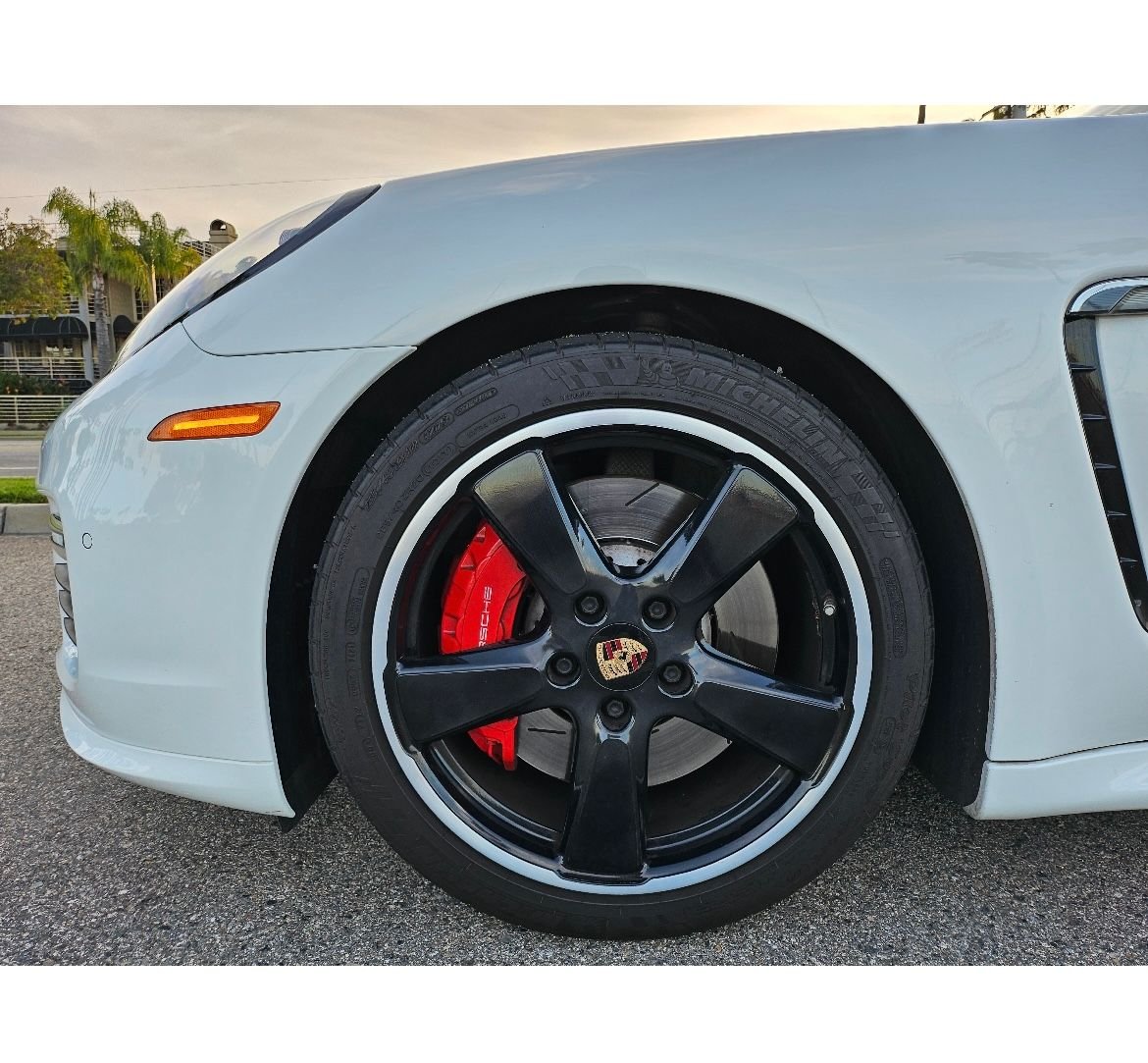

I am in the market for a Porsche and I’ve got my eye on a 2014 Porsche Panamera GTS with 49,000 miles. It is currently being sold for $39,500. Is there anything I should consider or look for? It has a clean car fax with only two owners and warranty until 03/27/2026. I plan on daily driving this GTS and I drive around 60-80 miles a day.

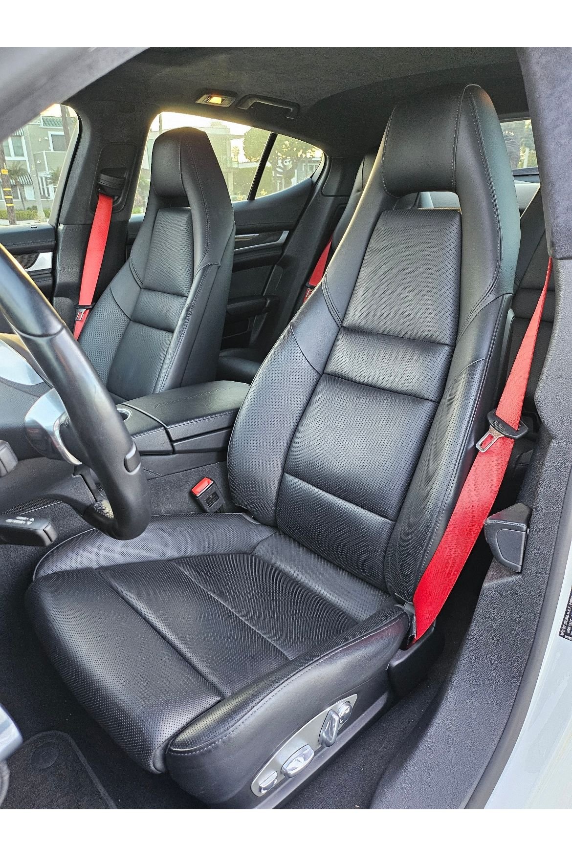

The most common issues on the Panny's tend to be the front suspension (upper control arms) and air suspension. Check to see if there are any service records as these will - at some point - require attention.
Also, 60K service interval is coming up which is quite lengthy - and pricey. The car appears to have all the options (except ceramic brakes), including those cools wheels. I think with the warranty with at least 1 year remaining makes this a good choice. Tires are about $2K and if they haven't been changed recently, something to consider.
I would go for it - looks very clean and well kept.

The owner says the tires are currently at 50% use. I did ask if the suspension has had any recent maintenance done. I will likely pull the trigger on the GTS but just want to make sure the 2014 is a reliable year to buy a Panamera.
