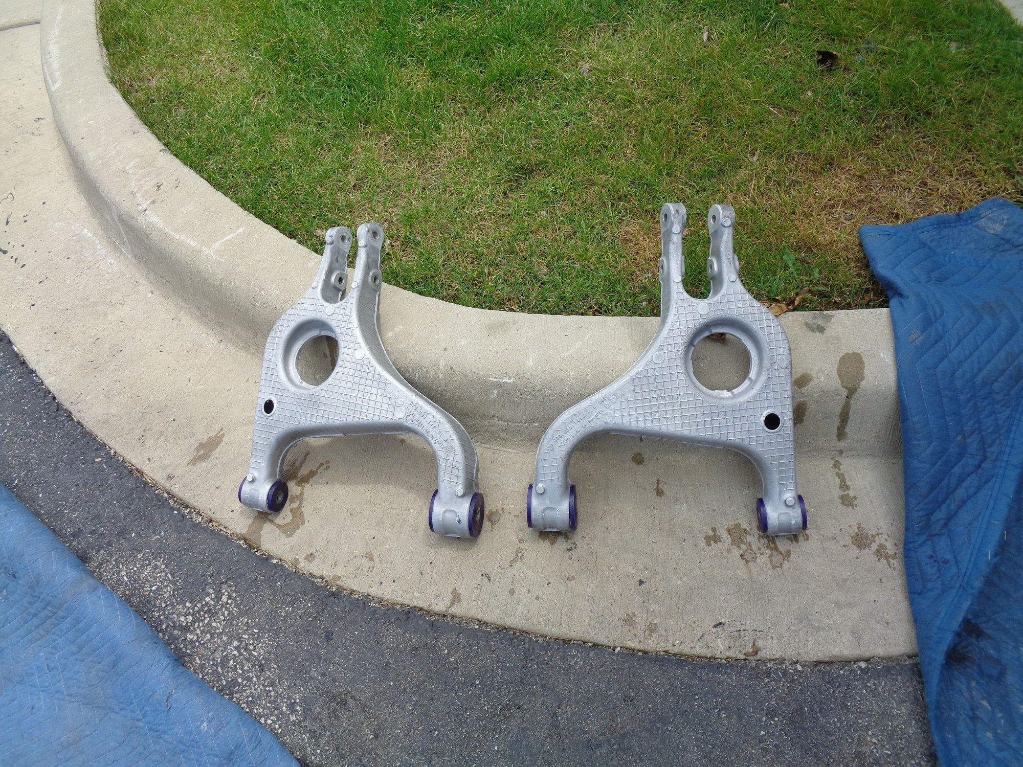

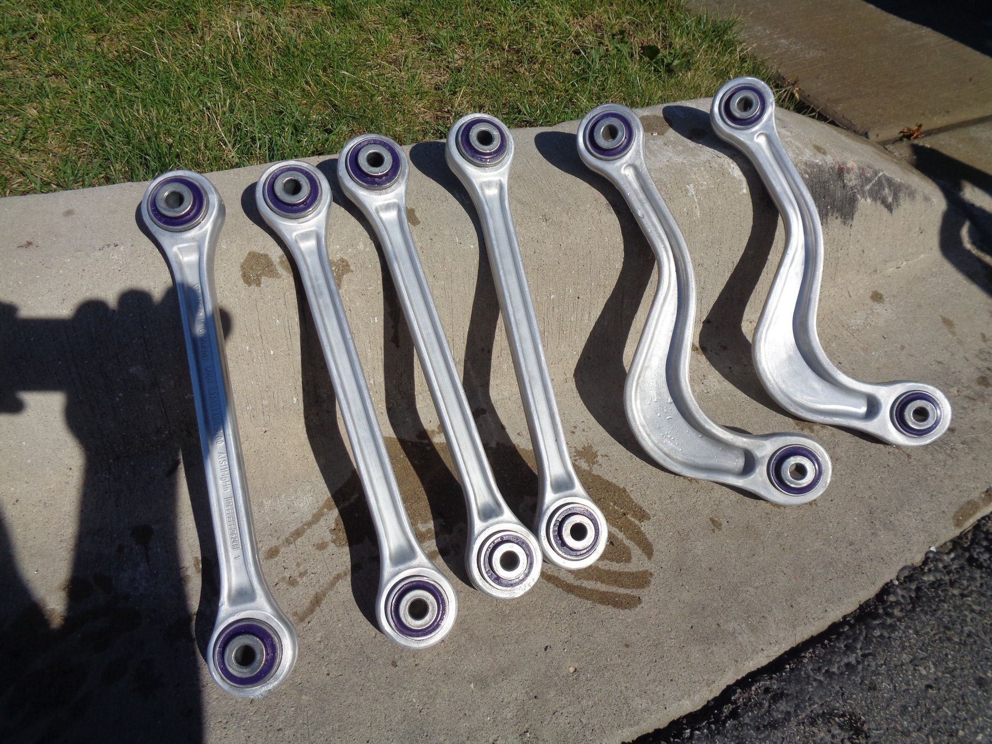

Here you can see the 6 rear upper control arms - 3 per side. Each arm has two bushings...
Also, the 2 rear lower control arms - 1 per side. Each arm has two bushings.
12 upper bushings - 3 arms per side
rear lower - 1 arm per side
4 lower bushings - 1 arm per side

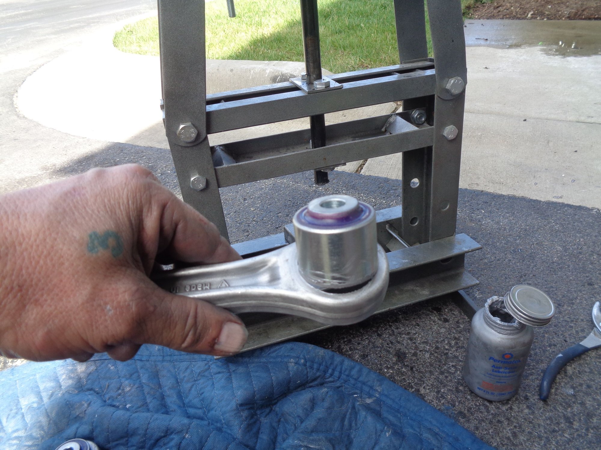

Marc,
As noted in the above threads, I ran into an issue using these in my 970.2, but they do appear correct for the 970.1 and you will need two sets. I didn't have any issues with installing the other bushings (front uppers/rears) and was completed using a normal press. As for cleaning, I used Aluminum Brightener, which appears to be phosphoric and sulfuric acid - worked great with agitation from a drill and attachments. Face and hand gear are necessary.

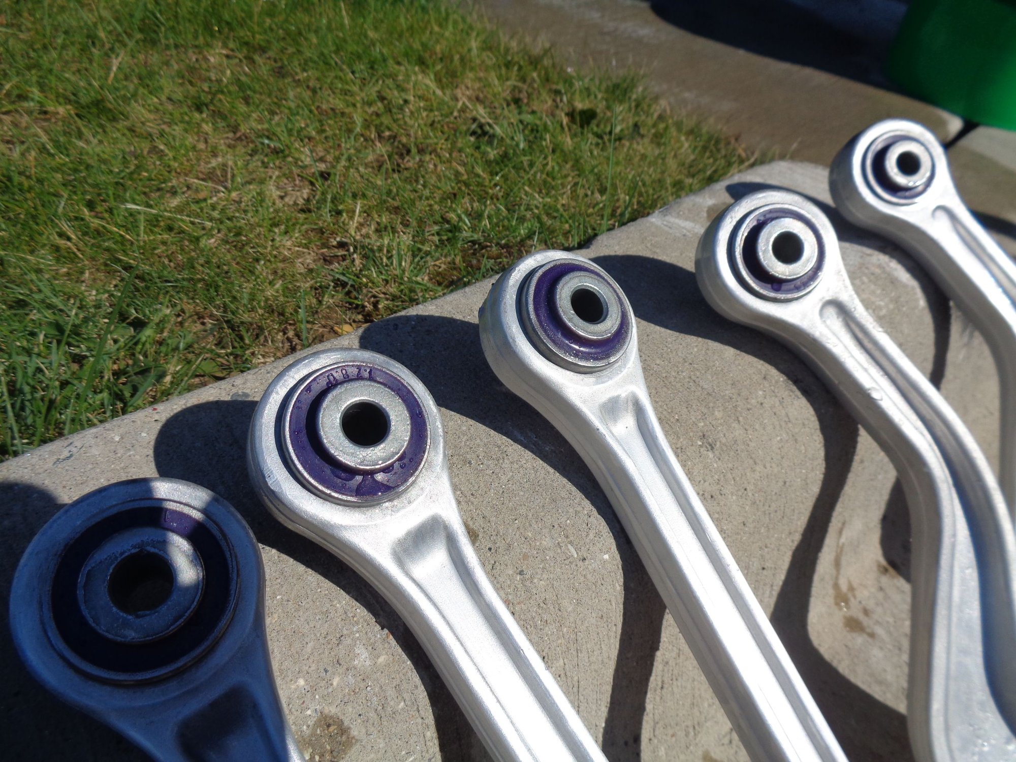

see my controls arms after cleaning
