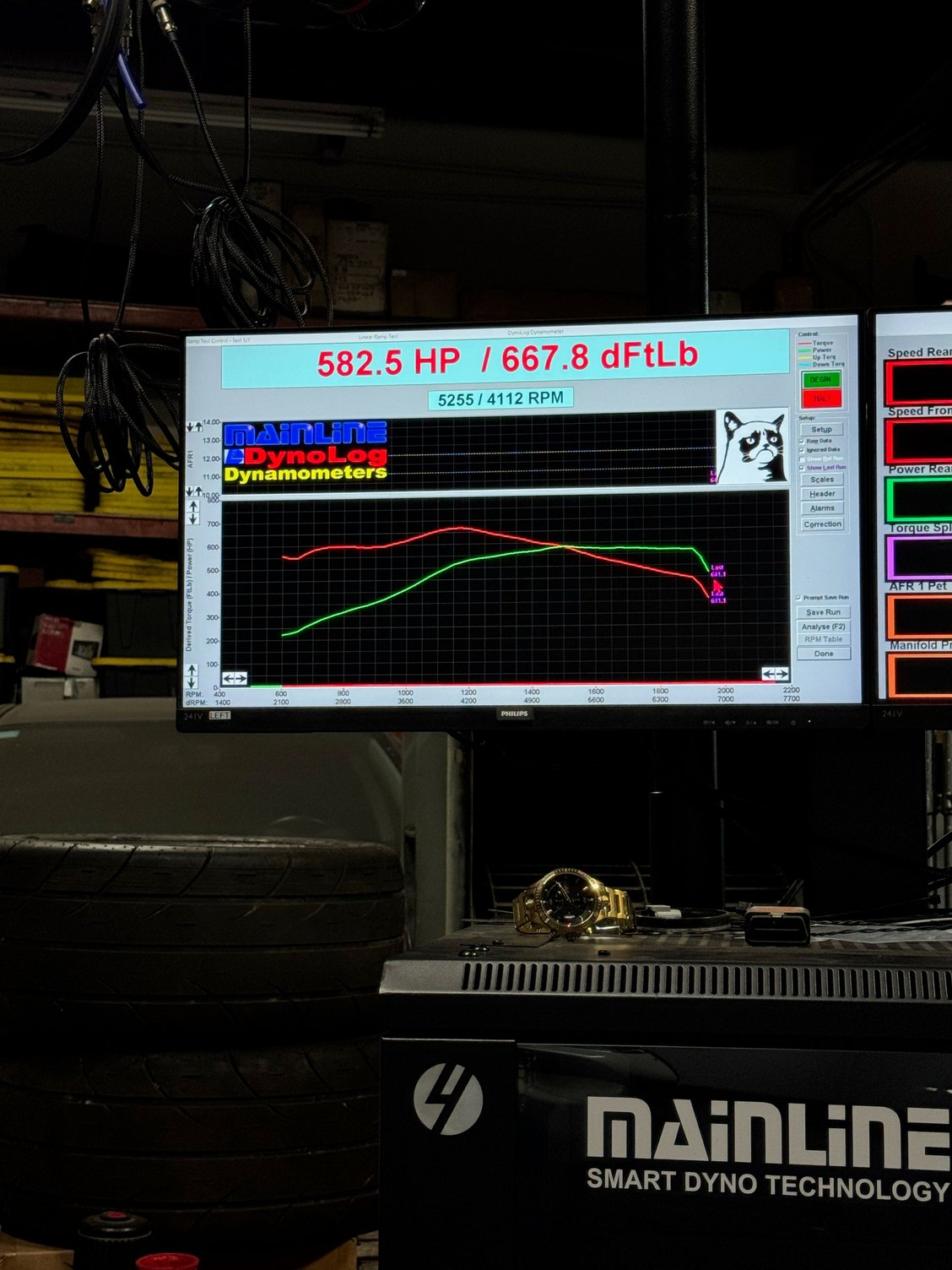

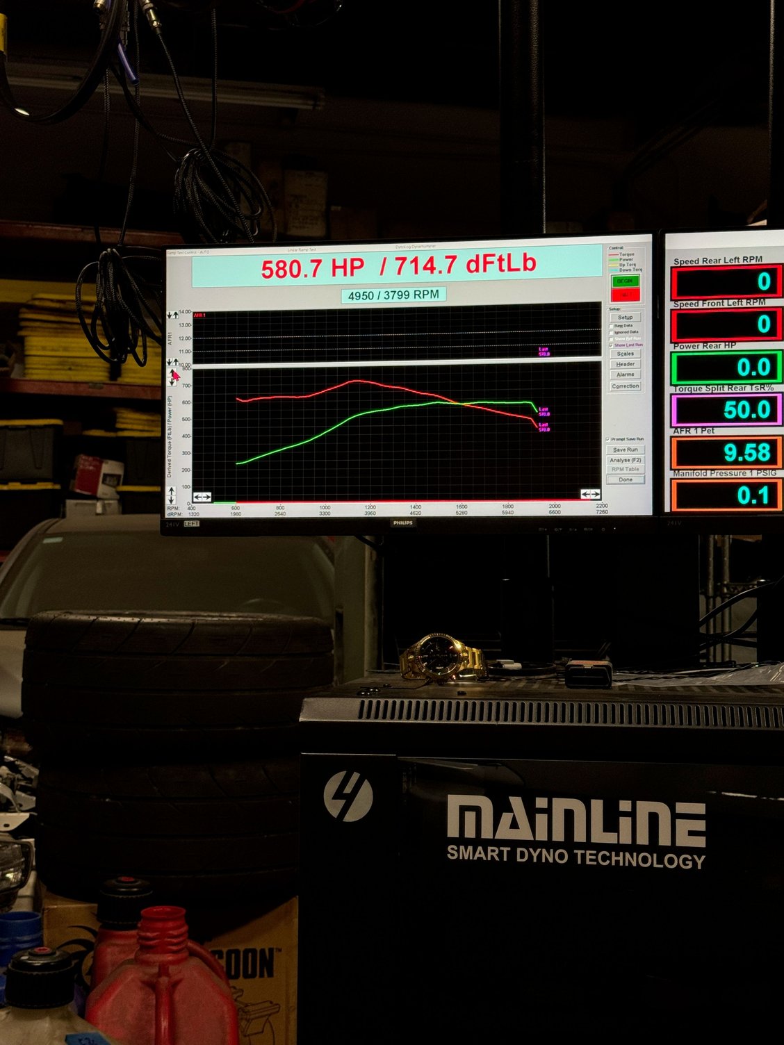

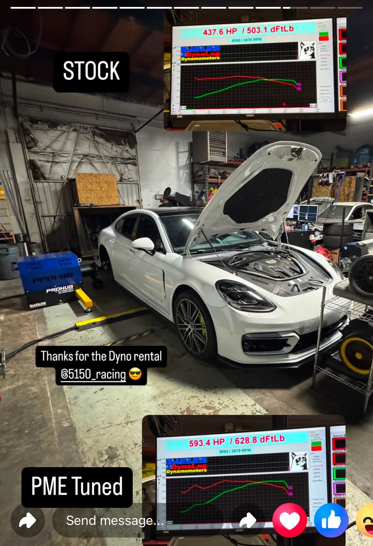

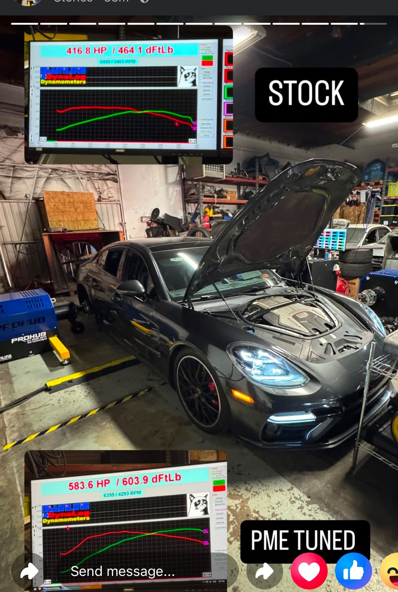

Thanks- Wow. 590Hp with just a tune. That seems crazy.
Can you confirm the exact engine you have that was able to produce that HP. Also, prior to the tune, did the engine feel sluggish?

inhave a v6 2.9 ehybrid 2018. The white one is my car it is a ehybrid. The grey is my buddy car and it is a turbo
This one is turbo 2017 tuned
This one is ehybrid tuned
