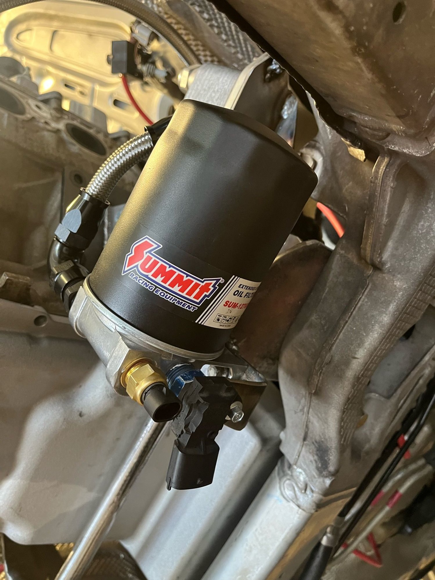

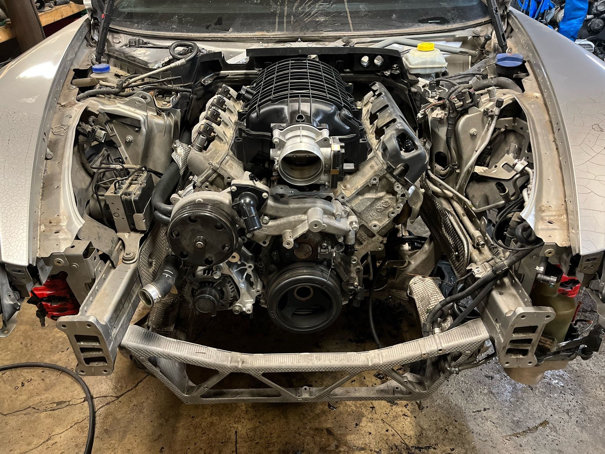

to make the Porsche ecu happy was less exciting than you might expect. I literally cut the entire engine harness off the ecu except for the coolant temp sensors, which I tied together to the one at the radiator. Oil pressure and temp sensor I added to my remote oil filter setup. And it’s happy enough to let the rest of the car work 😂. The Panamera uses a 60-2 crank reluctor so does gm. I was hoping I could just splice the crank signal unfortunately the Porsche ecu wants to see cam signal too, I can only make it read about 3 seconds.

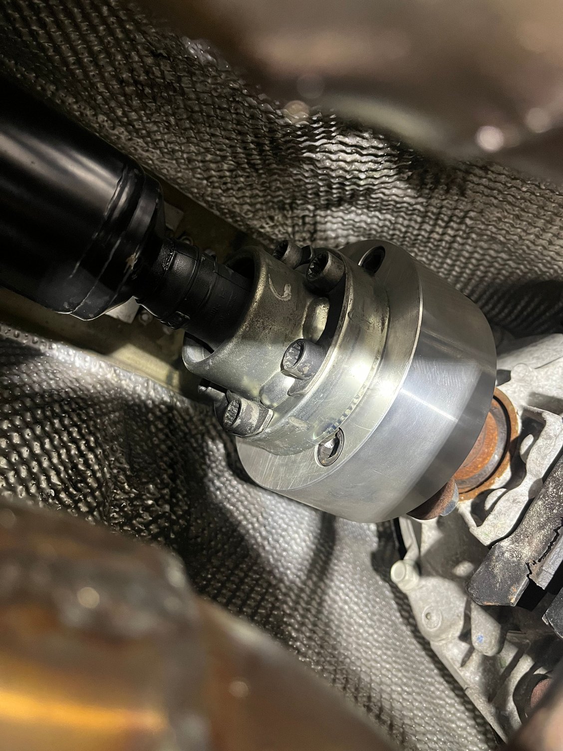

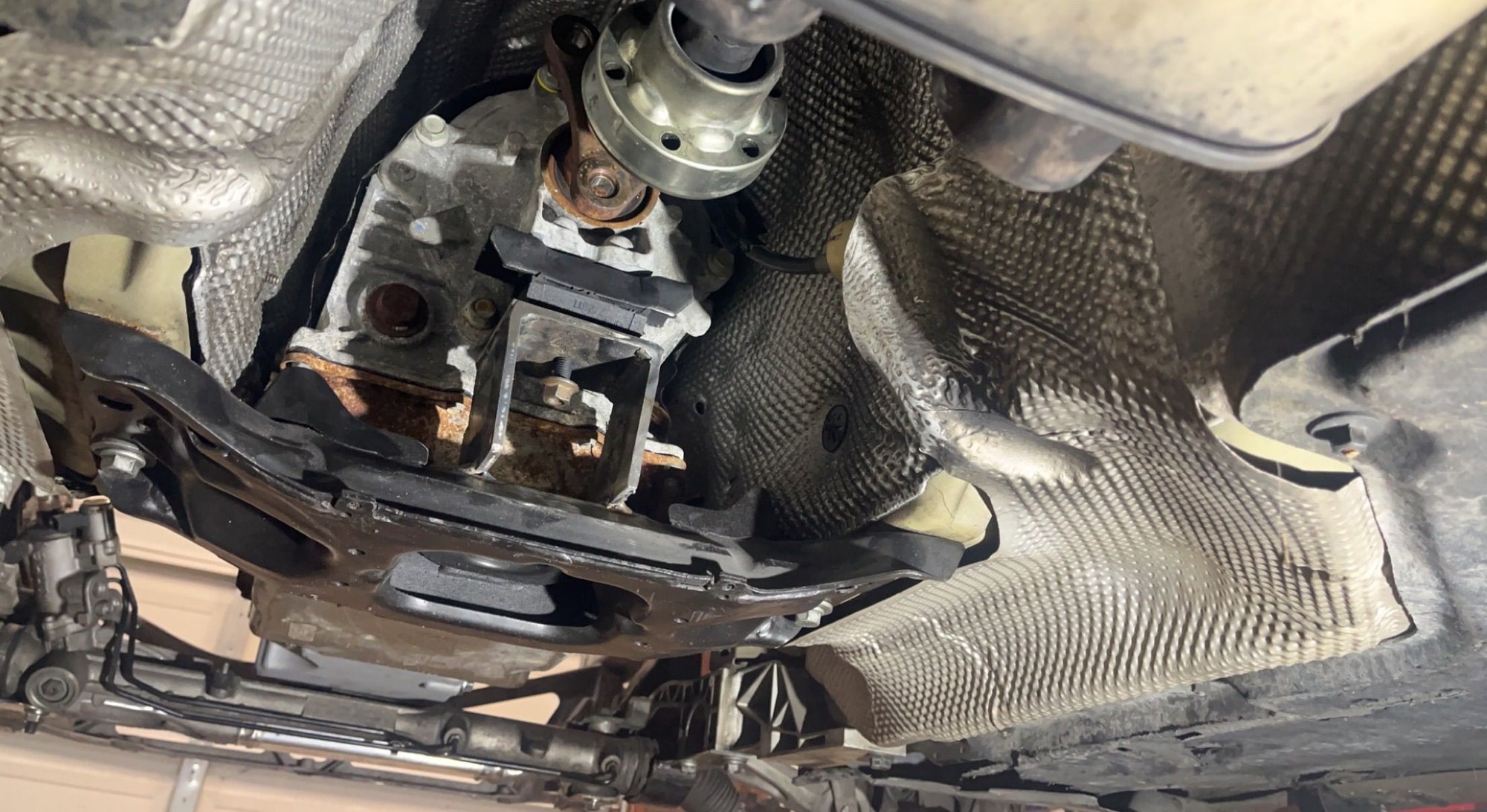

the diff was a direct bolt in from the Bentley minus slight mods to the input flange. I learned that the Panamera diff is basically just the “VAG big car diff” so it’s in cayennes and touregs and Bentley’s and tons with all different ratios.

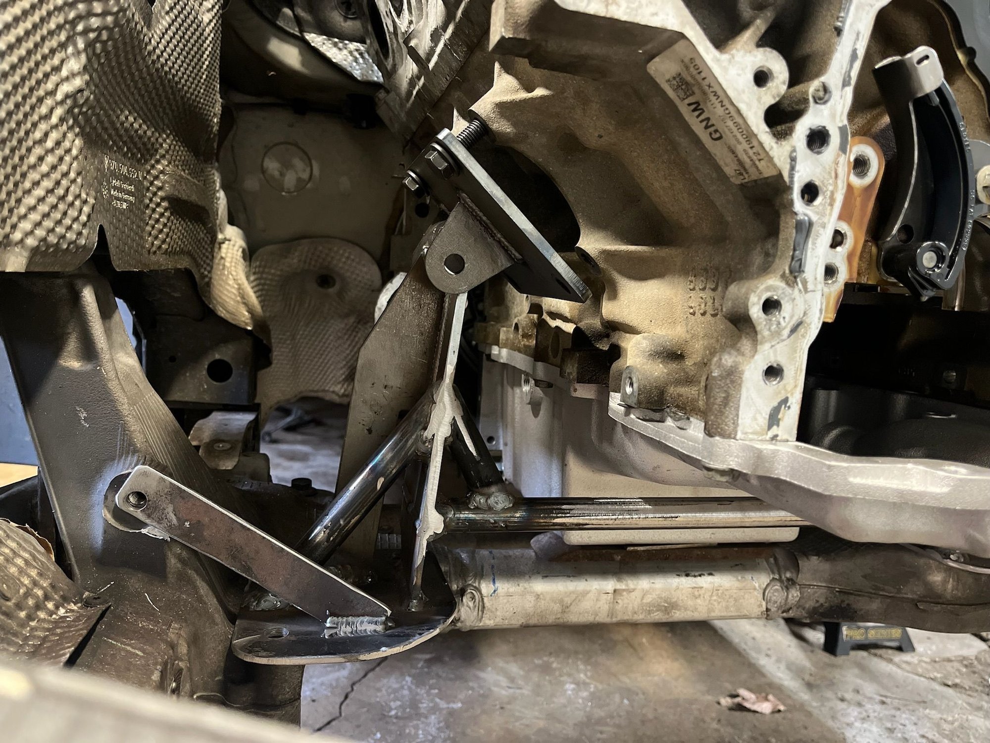

trans was easy I used stock cross member and made the most ghetto adapter on top 😂. Using stock trans cooler and I also looped in the power steering cooler to add more cooling. I’m using a Volvo electric power steering pump mounted under driver side headlight.
motor bolts to custom motor mounts I made that bolt to the factory motor mount positions. The interesting thing is the oil pan and all is above the crossmember it sits very high to duplicate how Porsche had the motor set in there and the weird height of the output shaft on the PDK. This let me use the stock driveshaft with a custom adapter I had made.

Agree, not a PDK fan. All transmissions “shine when driven hard”, in other words the easiest use case for the electronics and software to decide what the driver wants. In part throttle “normal driving” the car company agenda is forced on the driver which means highest numerical gear and lowest total accumulated engine revolutions to minimize fuel consumption and emissions at the expense of drivability.

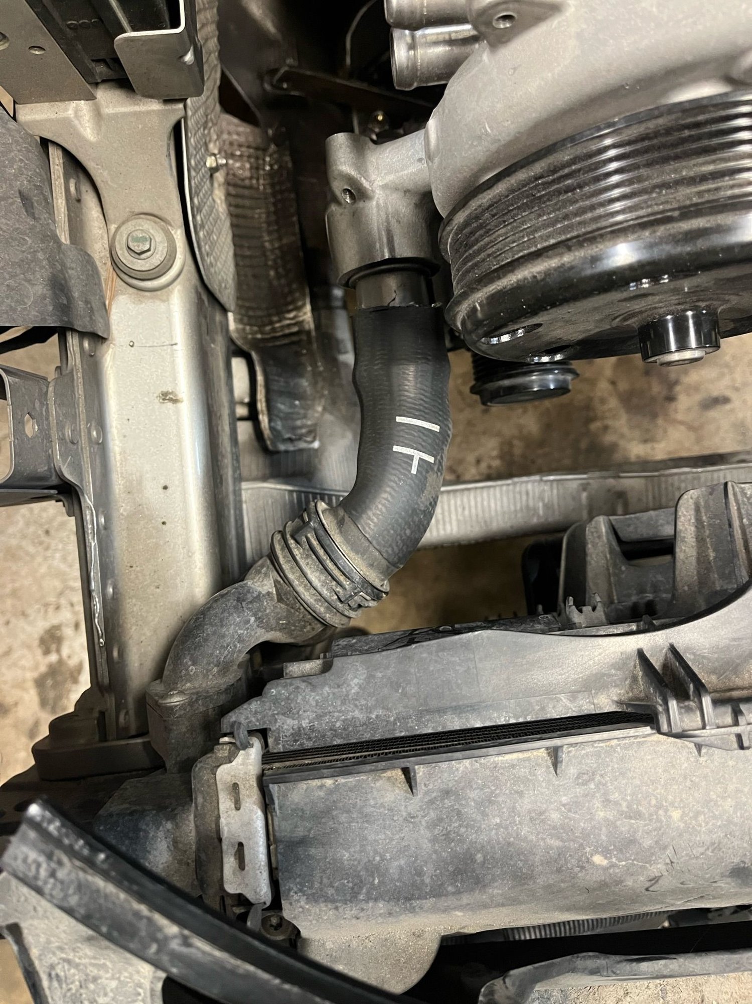

You mentioned the coolant won't go over 180 in your first post. The placement of the temp sensor at the radiator is probably the reason for that. Usually these sensors are in the block or head water jackets.
I’ve got a banks can gauge I use to monitor the gm data. That’s where I monitor coolant temp and oil temp they are in the stock gm locations and read the most accurate.

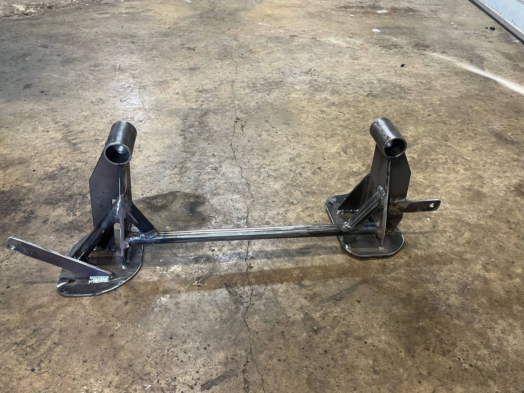

Nice c-channel trans mount!
No rubber for the engine mounts?
Old Jan 22, 2025 | 08:33 AM
Firebirdman79's Avatar
Firebirdman79
Joined: Jan 2023
Posts: 11
Likes: 25
hey what works works haha. The motor mounts are poly
