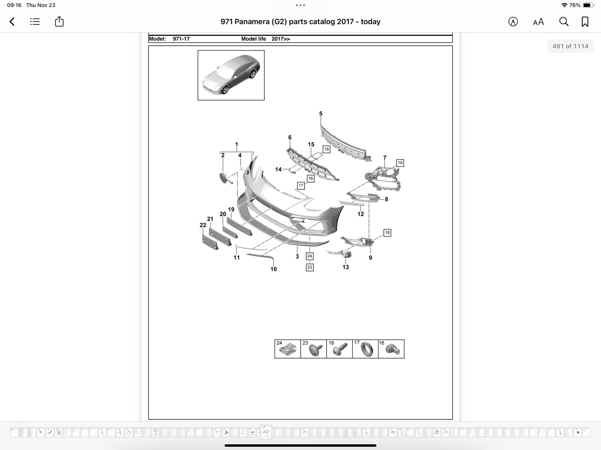

Sorry to see this, OP. it will bother me to no end if I received the car in this condition. Luckily it should be an easy fix. The lower lip is a separate piece attached by a number of screws. It can be taken off and reshape easily, or replace if you want to. The bumper cover does need to come off though, which is also a very easy job to pull off.

@E39Nutz - What's the part number for the new lip? The car is already at the PPF shop. They're going to try shaping it up
I don't think it'll be too hard to reshape with a heat gun. Long as I can't see it, I'm fine but still unfortunate

Hope they can level it enough that you don’t see it. The part number starts with this
971-807-541-X-YYY
X and Y denotes additional identifiers for version and color code I believe. These are at 400 ish and you need to get it painted as your lip spoiler is a painted one.
