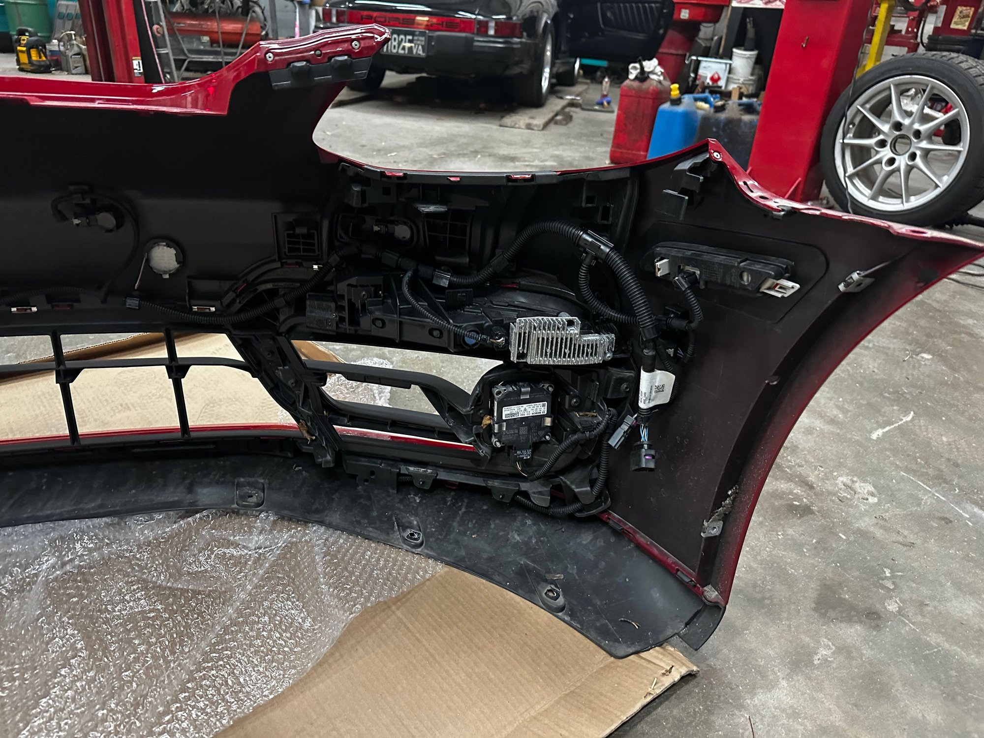

Here's what happened: Documenting for future unlucky night vision owners
  • My dealer gave me an estimate of $7800, including $1800 for "alignment." The insurance company gave me an estimate $1000 less than that but eventually they met near the top. With my deductible, they cut me a $6800 check.
  • I got my local indie to order the part, saving most of the deductible in the process. He and I pulled the bumper and replaced the camera...pics below.
  • I used the opportunity to replace the engine air filter. I could have done all this myself but it was worth the 3 hours of shop time to have a lift, tools, and experienced Porsche mechanic leading the way.
  • The $200+ I saved in labor rate means I broke about even on the deal, even with the deductible.
  • Taking her in to the dealer next week for the ridiculously priced alignment, which needs PIWIS and a calibration screen to complete (digitally).
Turns out the camera is a standard Audi part and can be purchased by part number for even less than I got it for with a little shopping, even saw a Aliexpress (knock off??) for $600. I also could have replaced just the lens had I known, although that kit is $1000.
Procedure - standard bumper removal per other DIYs here. Lift the plastic camera shroud up and forward using pry tools as necessary. Detach assembly from car, detach camera from bracket.
The one I had did not have threaded holes in the rear but the 4 OEM screws seemed to make their own threads just fine (self-tapping). Reverse process.
Sorry I didn't take a lot of pictures, but here is the place the thing attaches to, you can see the video cable at the bottom and the washer at the top. Assembly bolts here, then cover snaps on. The other pic is the camera being screwed onto the assembly while tapping the threads.
What is left when you remove the camera assembly
tapping the screws that hold the camera to the bracket
The plastic cover. The stuff at the top of the photo is the front parking camera and comes off with the bumper.
