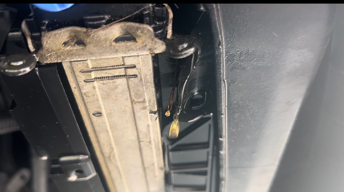

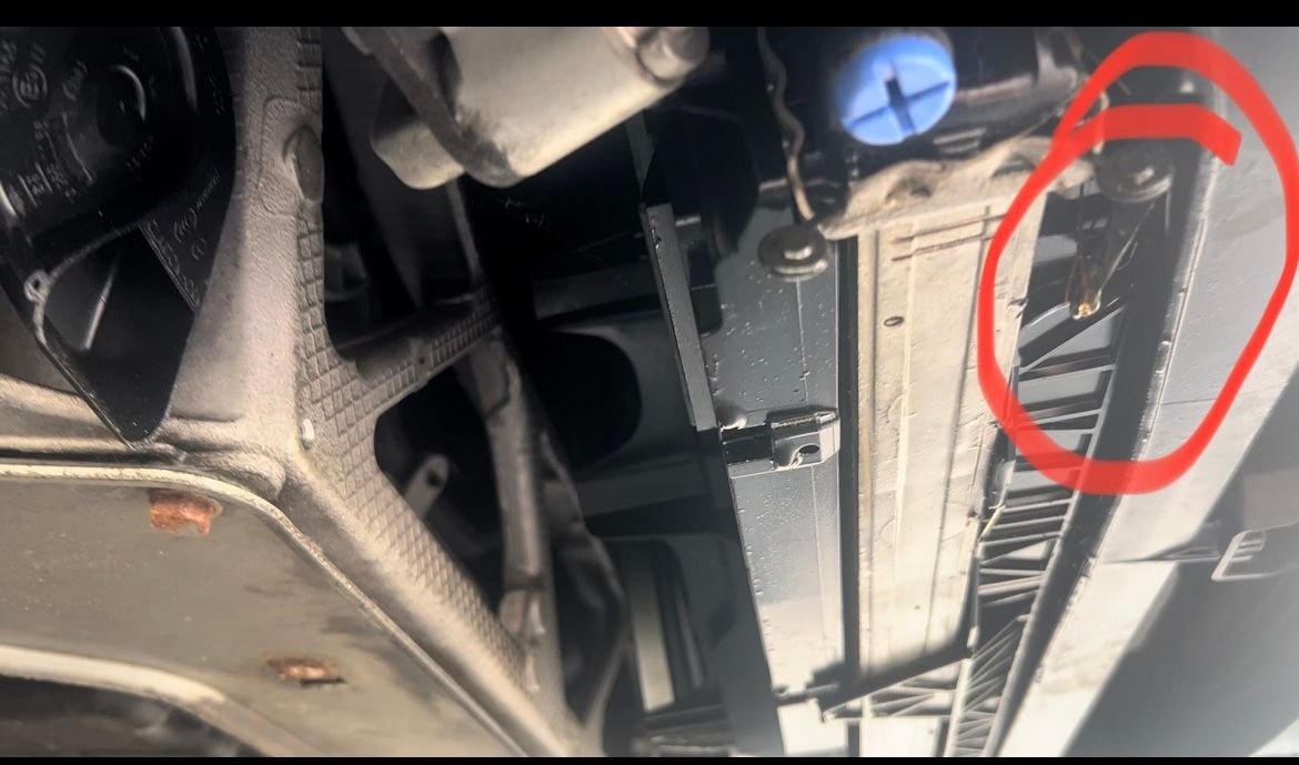

I noticed the other day after a short drive a large oil leak coming from under my 15 GTS. I put it up on stands today and noticed oil seems to be coming from the front radiator if I'm seeing it correctly? When I turn it on the car starts leaking oil steadily. The drip is on the passenger side. Where is this coming from? Any suggestions? No oil drips can be seen from the engine bay at all. It's only when I pull the bottom cover off can I see the oil coming out. No low oil light at all.

Hi, there is a front oil radiator (for PDK).
You need remove front PC to access.
Your oil flows side of radiator connectors.:acclamations:

Thank you, Do you think its a lose line or the whole cooler should be replaced?

Difficult to answer. I think it's connector line

Question, does that front oil radiator hold oil for the PDK? Because it's leaking oil not coolant.

Yes its pdk oil.
