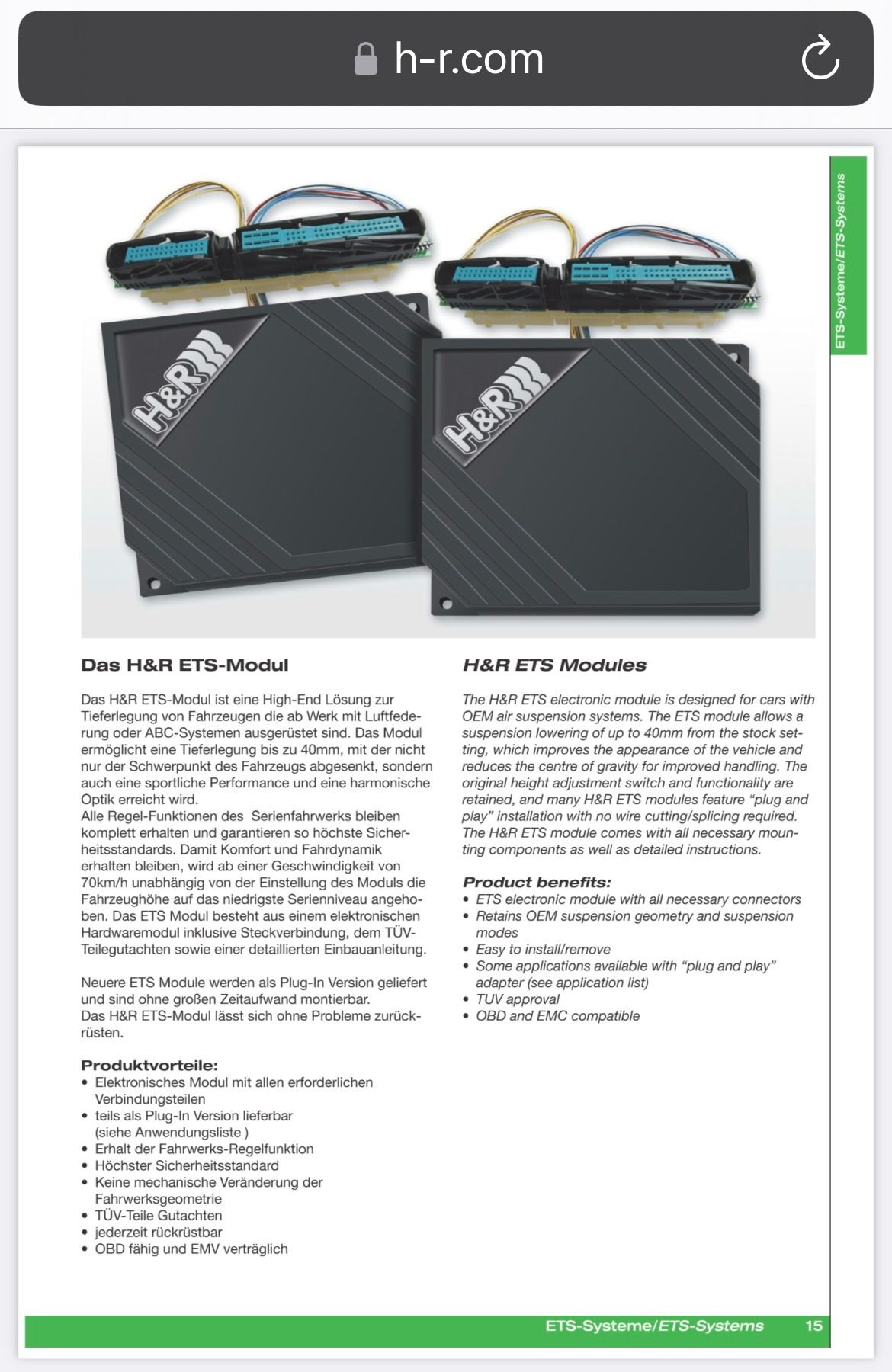

- Any drawback to using the lowering links or should I just bite the bullet and go straight to the module($$$)?

I agree with @Marcus13190. I lowered with PIWIS. Last I checked, modules were very expensive. Might be a wash compared to a PIWIS and this tool works for everything.

What are modules? The links cost less than $300 shipped. If you plan to do "everything" buy the PIWIS.

Originally Posted by Kelmac
What are modules?
H&R (and maybe others) makes a module like this to lower through the air suspension. Very expensive.
