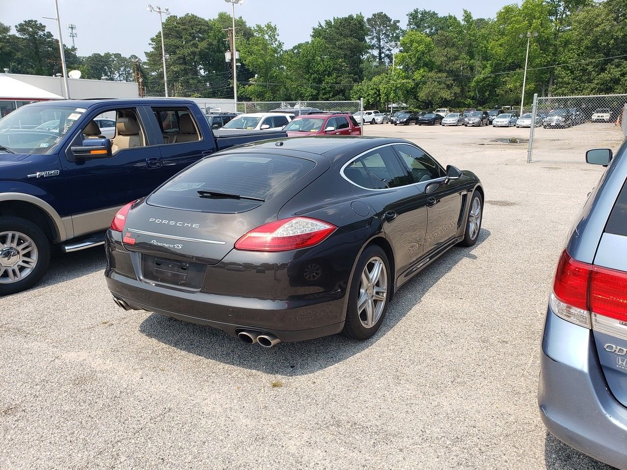

2010 4S. My first Porsche, but not my first German car by a long shot. It won out over an S63 AMG that was about the same price. Seems solid, engine sounds good, transmissionj shifts well, but of course it has some issues here and there. So, a handfull of questions.

Looks well preserved! The clunking on the front could be sway bar bushings or upper control arm bushings. Unfortunately there is no easy way to inspect the control arm bushings that I’m aware of, but they are commonly replaced. If the car wanders a bit on the highway that is potential sign of bushing failure.
Does the have the air suspension?

No on the air suspension. Going to try and pick up the corners and pull the wheels if the rain holds off this afternoon. It does feel a little less than firmly planted in turns, so that may be an issue.
