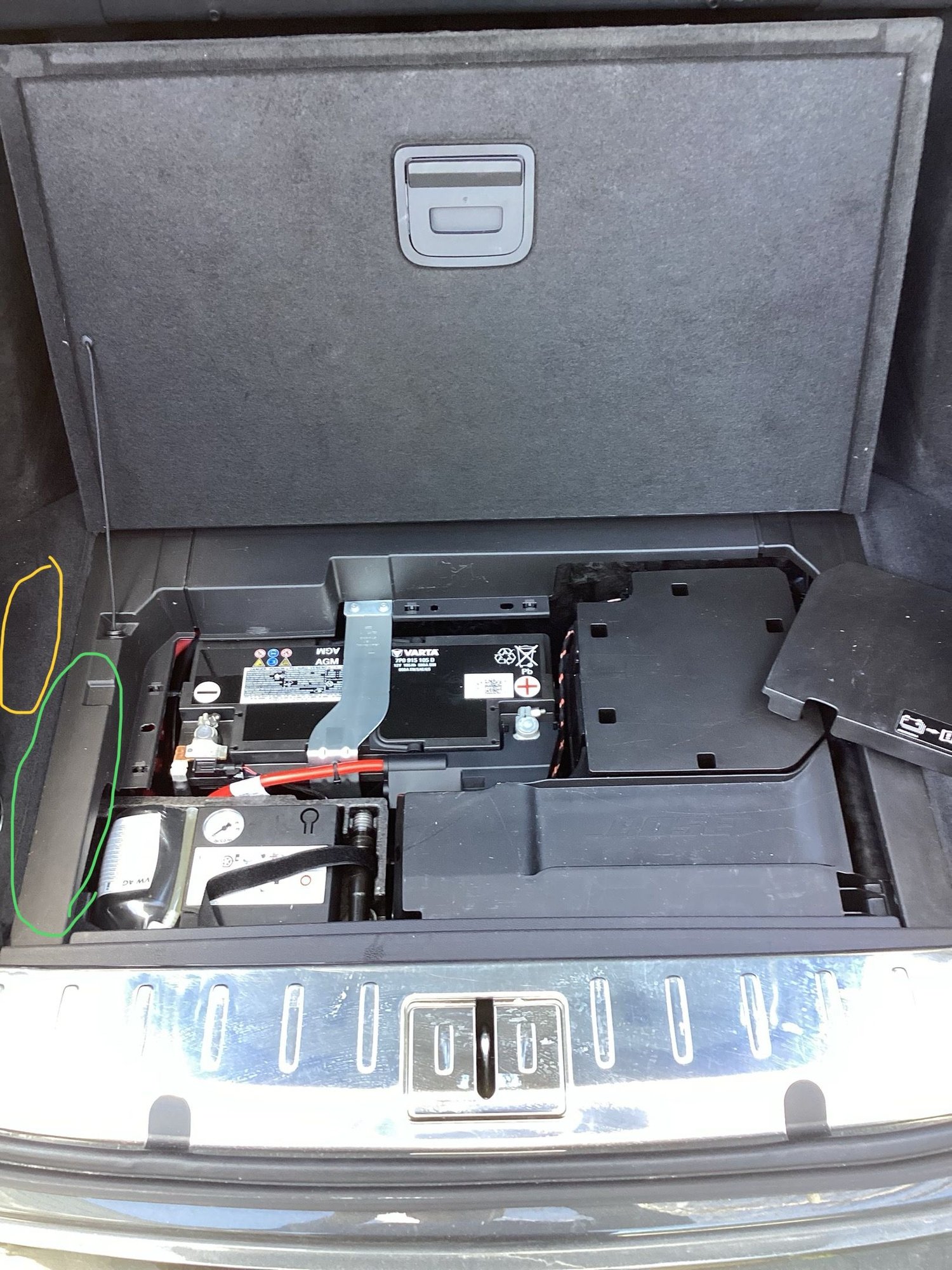

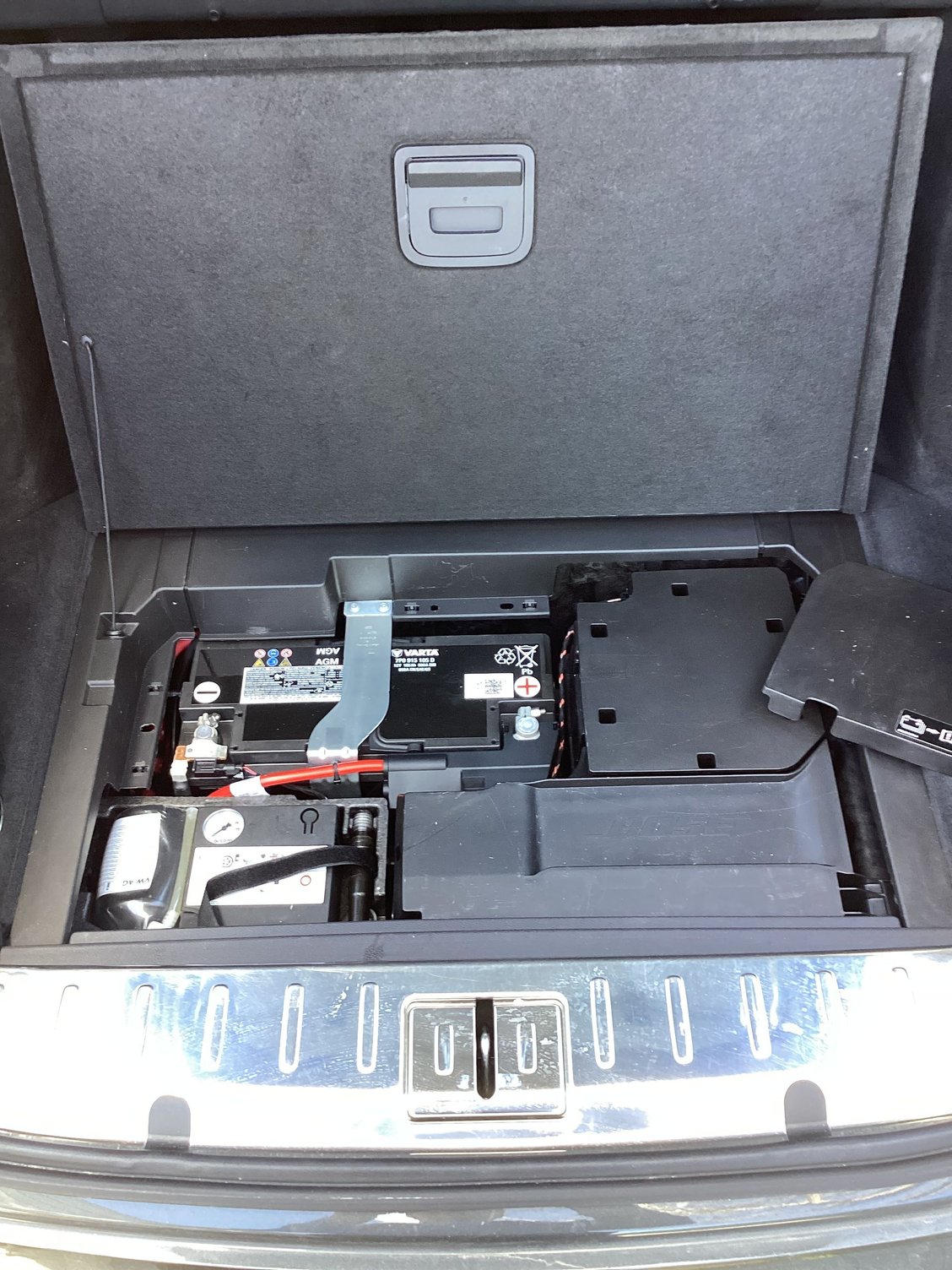

I changed my battery yesterday, about 1.5-2hrs of work. In Bob’s instruction, step 11-12 remove tool kit styrofoam.
I moved this step ahead of Step one.
Removed the two tiedowns loops for rear floor, 4 screws and removed the entire floor panel.
then removed the tie down loop on left side panel, yellow circle.
Then I removed the trim piece in green circle. It is held in place with two screws and a clip. The screw by the rear of car, push panel trim out of way to expose. The clip is forward by seat back. Pop off, unscrew and slide the panel towards back seat.
Need to lift up left side panel to free the plastic trim.
with the plastic trim (green circle) removed, a lot more access.
The left panel is held down by the tie down loop screws and two clips, no need to pop the clips.
Remove tools from styrofoam, remove styrofoam tool kit

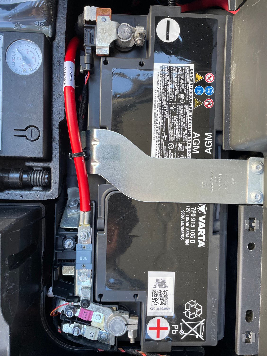

Step 13 - this is 13mm.
