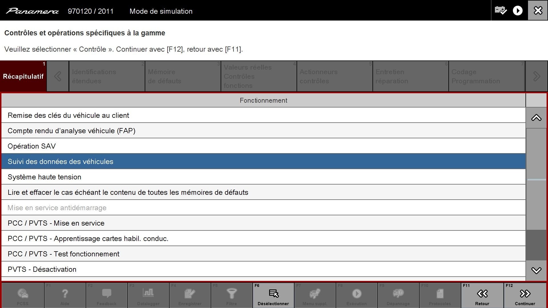

Hello, I would like to change the settings. Someone changed the coding to four wheel drive. The car physically has a drive to one axle. As a consequence, the car has errors with 4x4 sensors. Can anyone tell me how to change the encoding? Piwis 3 engineering does not allow you to change these values. Upgrading the firmware also has no effect. Best regards

Hi with piwis 3 it is possible change this value.
Have you see if in this function it's possible change ?
