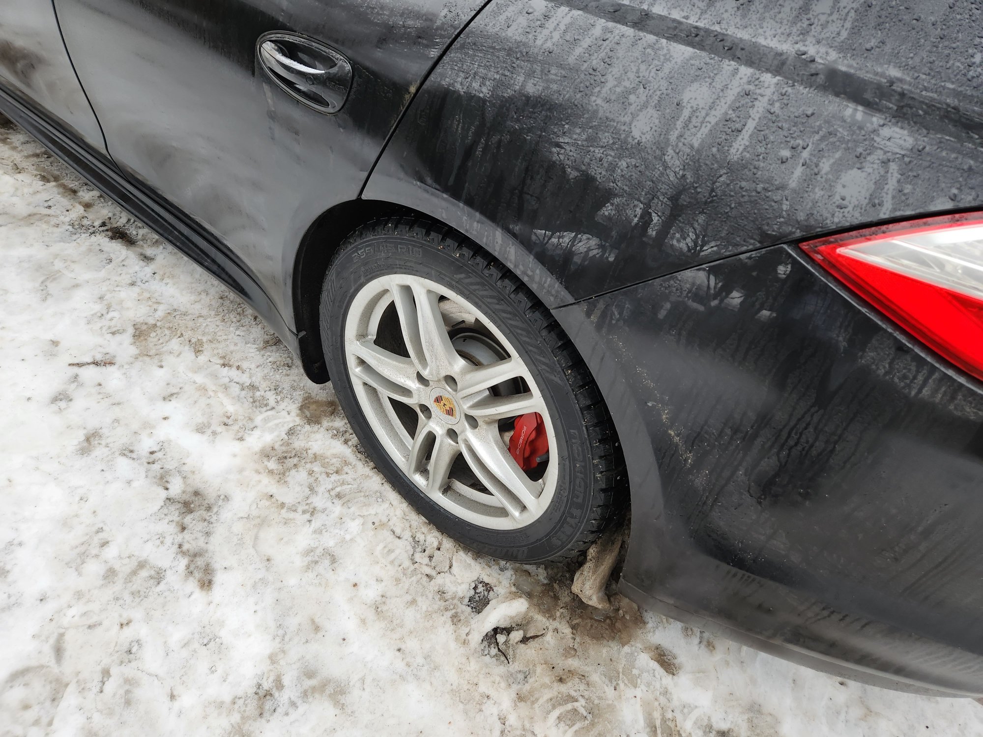

I decided to try a square winter setup on my 2012 Turbo S.
The last 5 years I've been running Michelin Pilot Alpin. Great winter tire that feels like a summer tire (No spongy effect). But the last few years our Canadian winters have been made even worse with rain mixed in. Resulting in icy conditions almost all winter.
Unfortunately they don't make studded tires in 285 sizes. So I purchased an additional two 19" turbo front wheels and put them on the back.
I ended up with Nokian Hakkapeliitta 10 EV tires in 255/45/19 all around. I thought the front wheels in the back might look tucked in but it's not bad at all. I'll post pictures later.
Super happy with the setup. The traction improvement in acceleration is noticeable on snow / ice. Stopping distances, as expected, has tremendously decreased. Where the Michelin would just slide on ice these things just dig in and stop.

Pics
What the roads look like:
