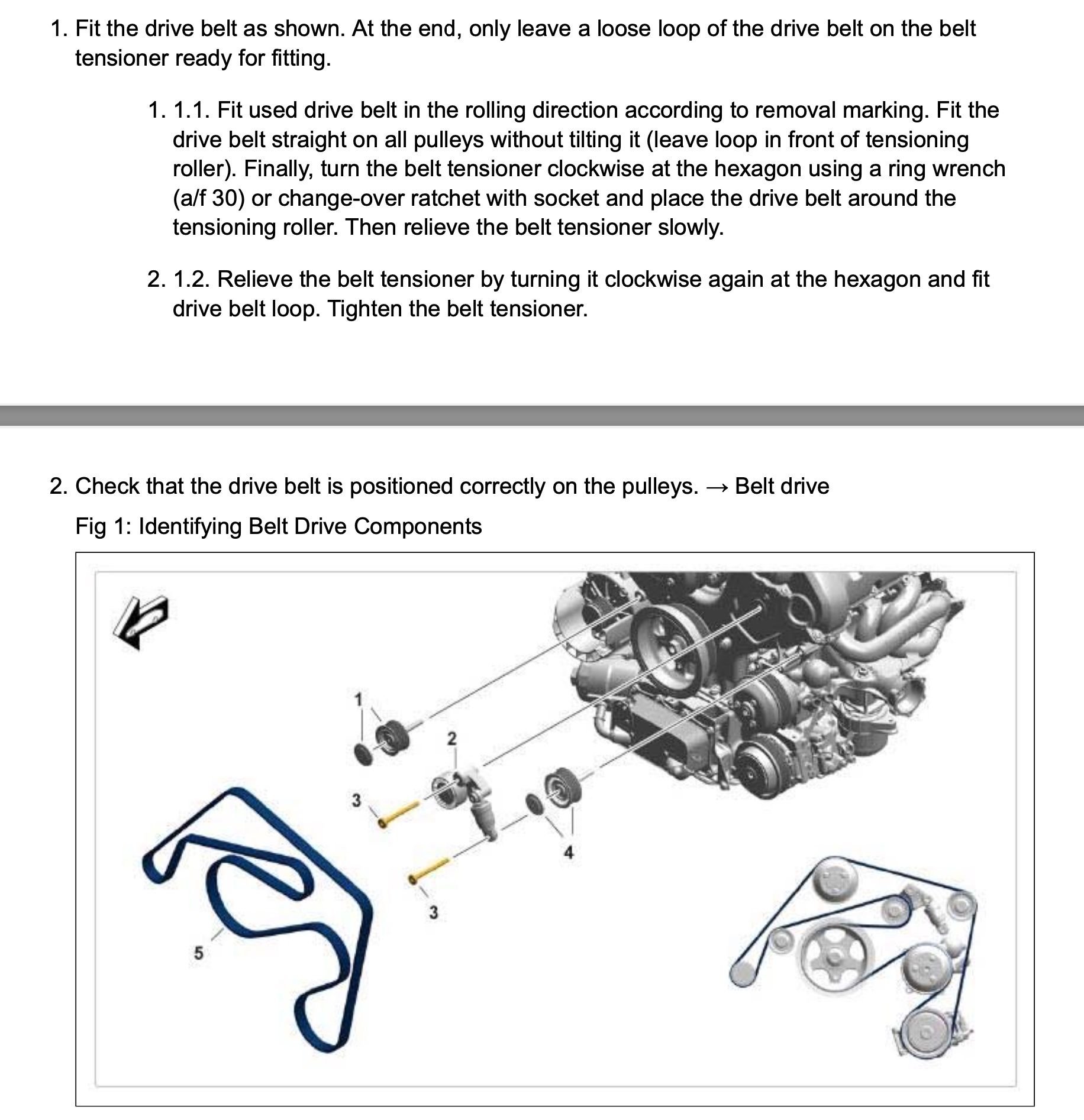

What's the process to remove tension on the serpentine belt on a 2010 Panamera 4s?

What size of Socket is used to release the tension? Is it a 33mm?
