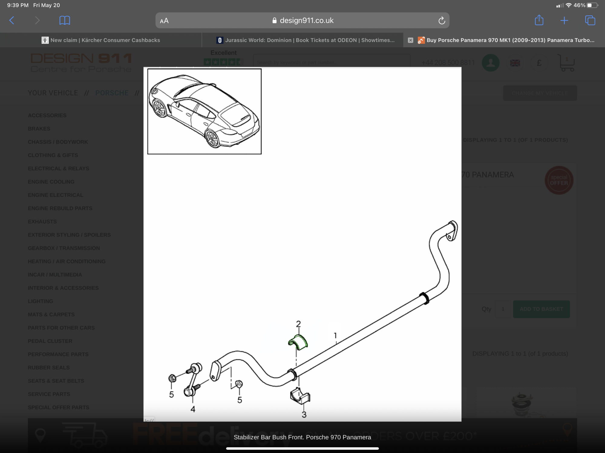

Question: when they say sway bar, is it the same as a stabilizer bar? If I buy OEM, is this what they are called? Can I buy the bushing alone or do I buy the whole stabilizer/sway bar link, which I assume comes with the bushing??
Thanks
I am showing this to my dealer. I already paid about $600 to have the lower control arm bushings replaced a few months ago as they said these were not covered so I am going to ask for a reimbursment.
As well, I am not worried about the current warranty being voided if I buy the parts OEM and change them at my local mechanic, I am worried that if I decide to extend the warranty for another two years, which Porsche offers, I will not be allowed to as I did not change these parts at Porsche. If they are covered, then this point is moot.

This is the sway bar bushes, 2& 3, different folk call them different things , over in the Uk, it’s just an anti roll bar . I bought them to fit to mine but they didn’t actually need done. A lot of main dealers just like to throw parts at them, it’s the Porsche thing to do lol.
