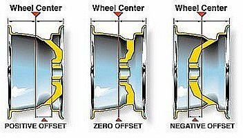

After doing an insane amount of research, I found a formula to calculate the total offset for the rims...i think from this forum.
I found 0.5*width*25.4 (to convert to mm) + offset
so in my case, OEMs:
front: 0.5*9.5*25.4+71= 191.65mm
rear: 214.05mm
so i have to find rims as close as possible to those numbers? Does anyone know how far off i can be to still clear the brakes and be okay? Those numbers are huge compared to most aftermarket wheels i'm finding...
i'm usually okay paying the "porsche tax" for maintenance, etc...but geeeezzzz...i just wanted a decent pair of rims for summer they shouldn't even offer crappy rims on Porsches!
Old Mar 3, 2022 | 11:46 PM
Deezflip's Avatar
Deezflip
Joined: Dec 2018
Posts: 233
Likes: 85
rear: 214.05mm
Nope, the offset is already in mm...so the front is 71mm offset.
The width is in inches which is 9.5in, and the diameter is also in inches which is 20in
Bonus: tire sizes are in mm also, except the diameter which is also in inches
mm divide by 25.4 = inches
0mm offset is exactly and always in the middle of the barrel, whatever the width may be.
Hope this helps

Not sure I understand. So we know 0mm is dead center of the width. postive +71mm offset = 2.76inches towards the front of the wheel, OR negative -71mm offset is backwards = 2.76inches towards the back of the wheel.

Not sure I understand. So we know 0mm is dead center of the width. postive +71mm offset = 2.75inches towards the front of the wheel, OR negative -71mm offset is backwards = 2.75inches towards the back of the wheel.
wouldn't the width of the wheel affect the placement though? relative to brakes, etc.
Old Mar 4, 2022 | 12:01 AM
Deezflip's Avatar
Deezflip
Joined: Dec 2018
Posts: 233
Likes: 85
also just to clarify, the wheels for the Panamera have positive offsets
