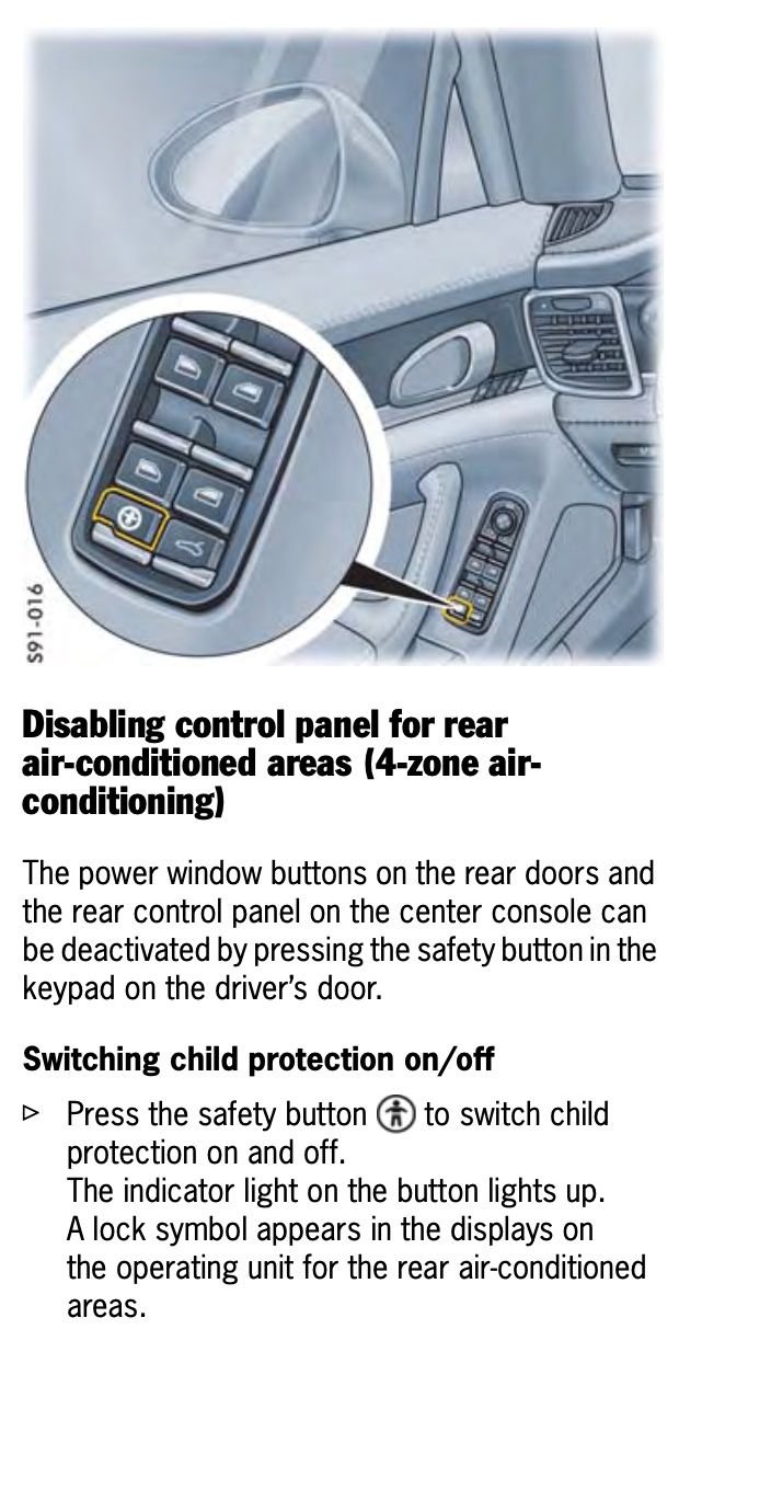

Also, in the rear seats, how do I unlock the controls for climate control? There is a picture of a key, and I cant seem to find the botton to unlock it.

From owners manual ...
