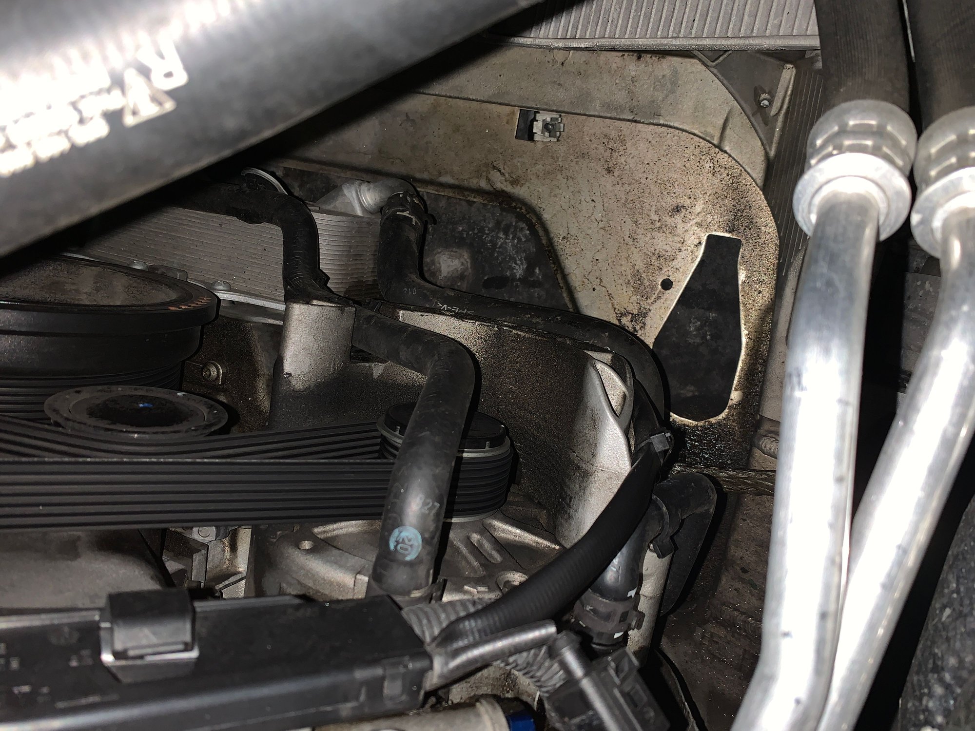

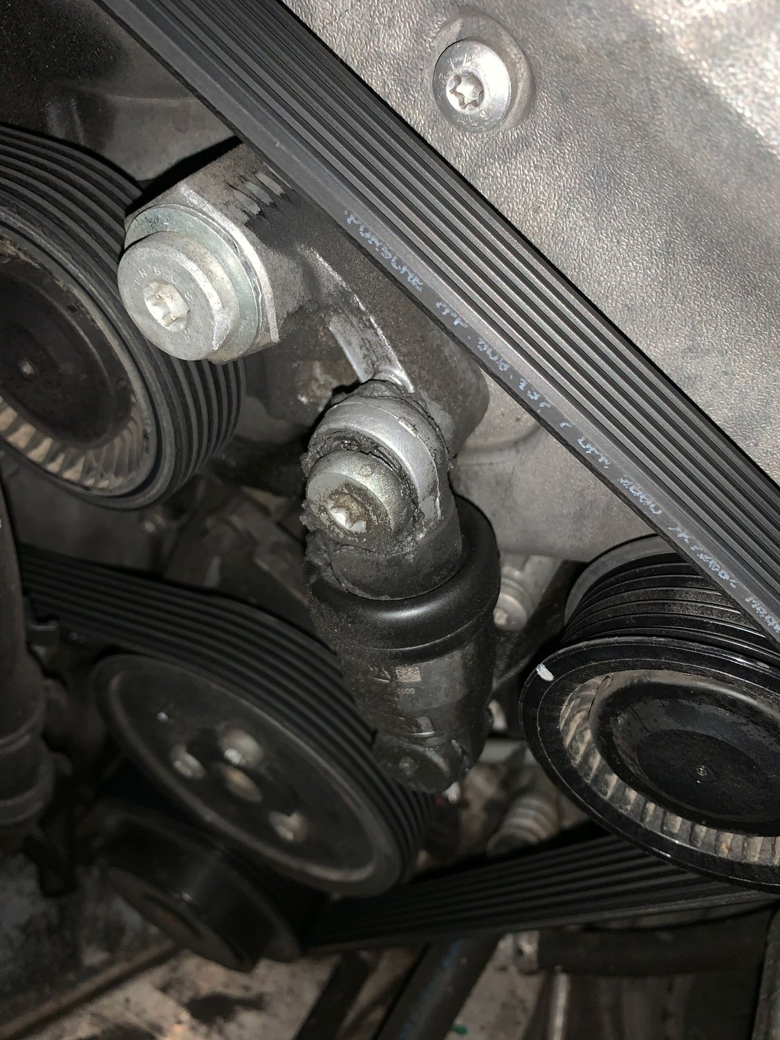

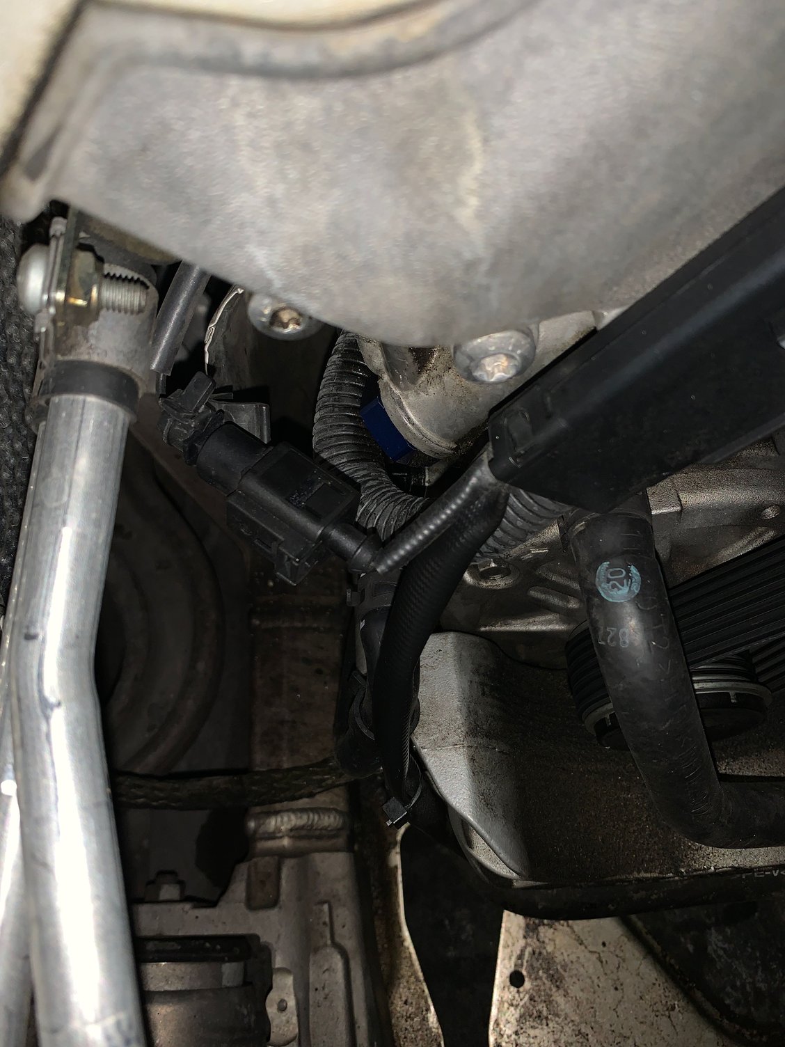

Hi folks, looking at a '14 base for my wife to share the garage with the 911. I'm trying to arrange a PPI but in the meantime I noticed a could things and would love some feedback from you all. I've attached a couple pics for reference.
That tensioner looks wasted to me, bushing is shot and it is leaking.
Dirty down there, some might be from tensioner oil traveling around the belt... Look at the very bottom of the pic, that blue bolt. WTH is that?? It had a little oil around it.
same area, that blue bolt in the middle. I swear it looks like someone has been here before, cable clamp was hanging, and that weird *** blue bolt...

Look carefully from below to ensure the staining is not oil from the timing chain cover or valve covers. Known issue on the 970 V6 (also V8) engine. Aluminum bolts fail causing leak. Typically see oil around the front of the engine around the alternator, oil filter housing, and oil pan (front left of engine). Can look simply like leaking oil pan. VERY costly repair if out of factory warranty and no aftermarket warranty to cover.
If this is found I’d walk away unless you wrench yourself. Done the “Porsche way” it’s an engine out repair.

Ding ding ding, you win the prize. PPI showed cover leak engine removal required along with engine mounts. So now we'll see if Carvana is going to cover all the repairs or if we just return the car. Should be interesting to see as it's not a small bill from Porsche for the work... Stay tuned

So update on the car, Carvana approved repairs and they have been completed by the Porsche dealer with a $50 "out of network" fee for me to pay since I didn't use a carvana service center. They pulled the engine, resealed, replaced the motor mounts, and did a four wheel alignment. I'm pretty happy.
