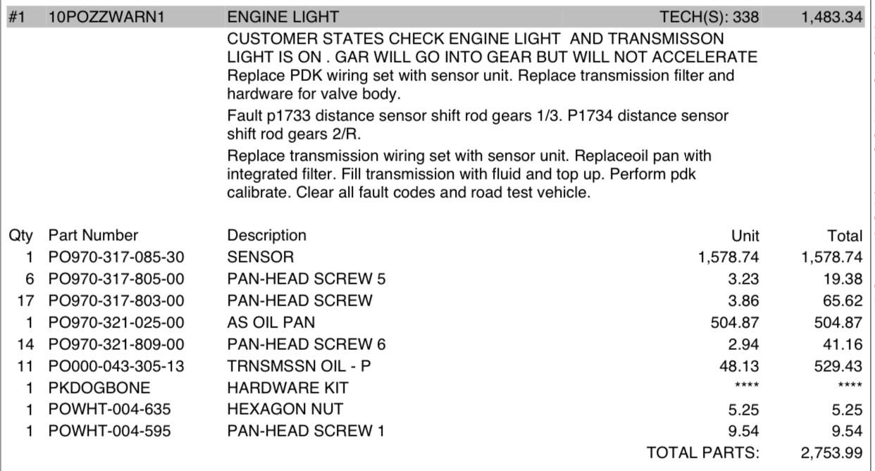

Didn’t hear anything on Thursday but I made plans to fly out Friday regardless. Friday morning rolled around and Rochelle called to report that the shift sensor relay (I know that’s not the proper name of the part, for you purists I will list the part number when I get the invoice) was bad and not reading 1st, 3rd, or Reverse. She advised that the replacement part was here in the US and the repair would be completed next week. She quoted a repair price around $3,800. Two warranty repairs will be included in the service, one for the control unit for the A/C blower and another for the plastic bushing on the selector lever cable. After dropping the service loaner Friday morning they arranged an Uber and covered the trip to the airport.
