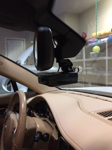

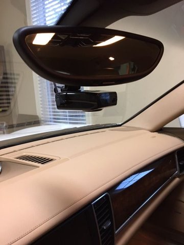

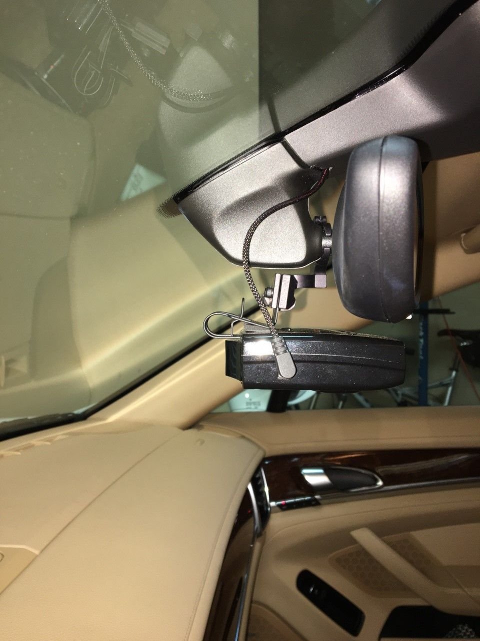

This is the Blendmount on my 970 and hard wire kit for a Radenso Pro. Used small multimeter to find 12v tap in mirror. The decorative mirror bracket cover right behind the mirror is two pieces and I broke a tab removing it but OEM clamshell was <$20 (used black Gorilla tape till the part came in). Hardest part was figuring out how to lower the upper lighting console (unclips and is hinged nearest the mirror) so you can find the 12v taps points. Randy/Alabama
