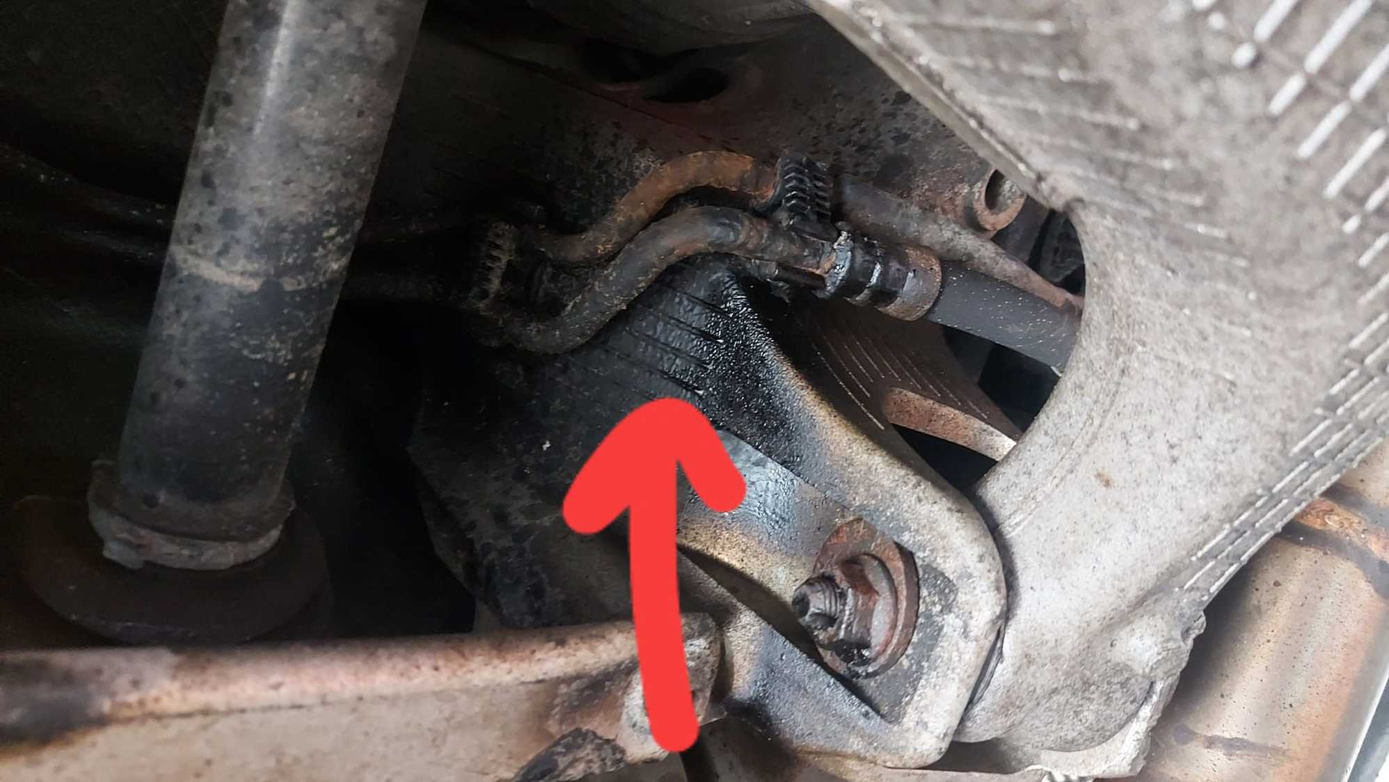

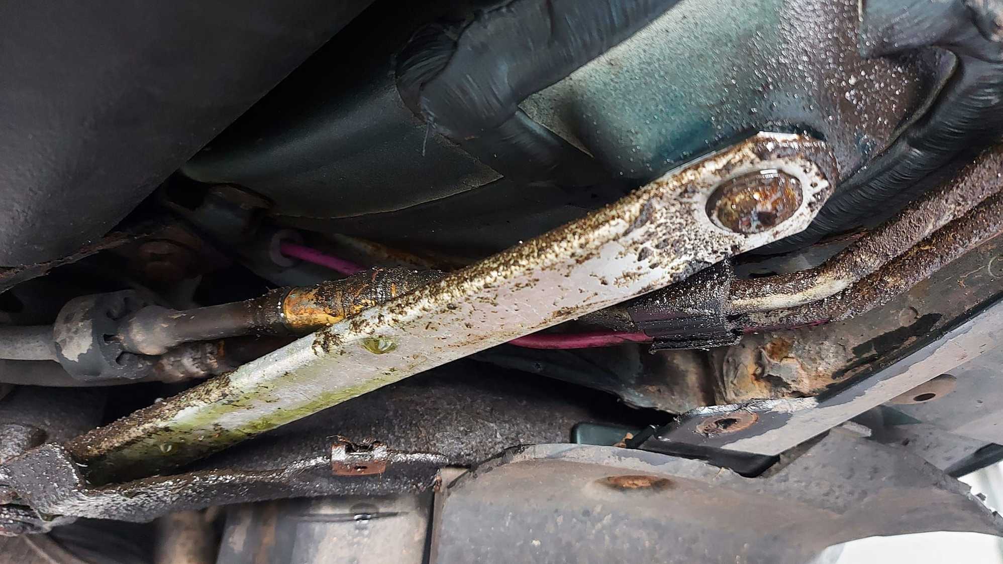

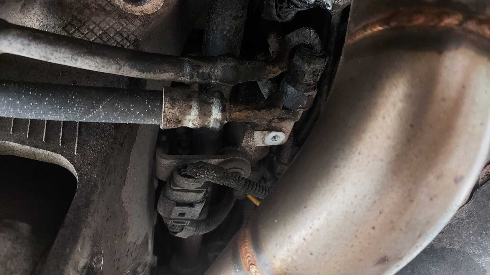

I have had total failure a year or so back. The car basically shat all fluid from the pdcc lines. Mines a 2010 too, plus we have heavily salted roads over winter which really don’t help. Had to replace the feed and return pdcc lines that run up the right hand cill looking from the front. They go into a valve block at the rear of the car , easy to mistake them for brake lines . These might help
Hole in the pipework behind the bracket
