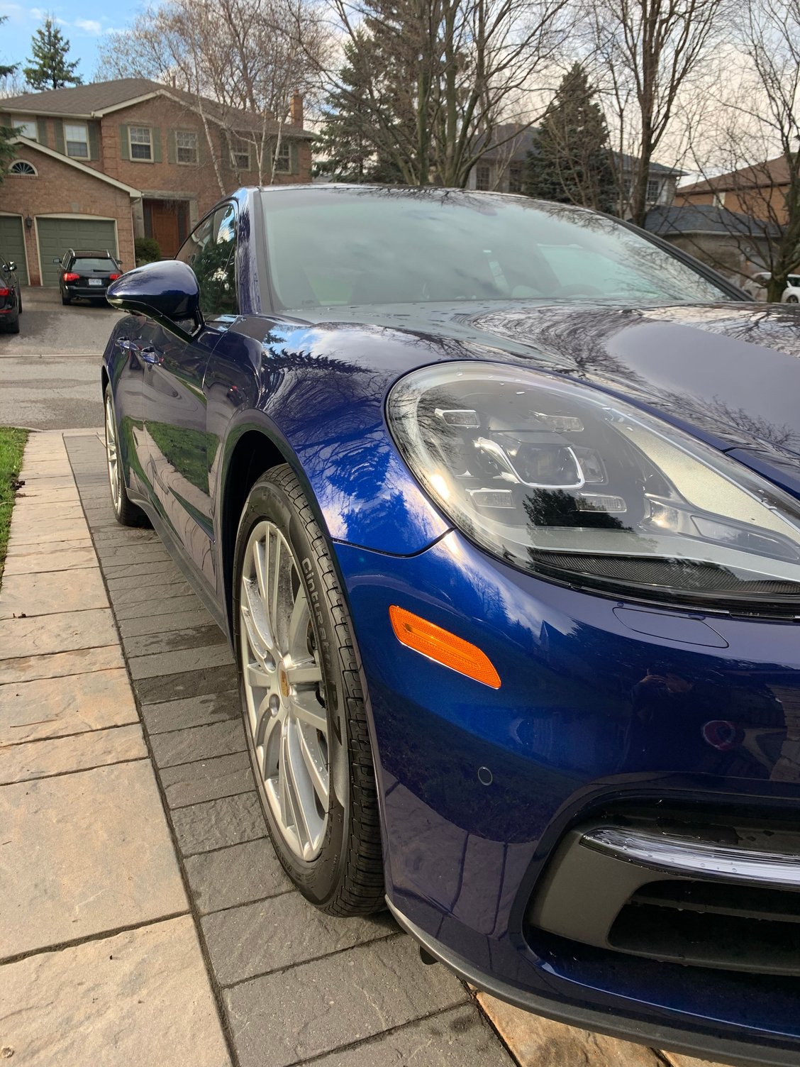

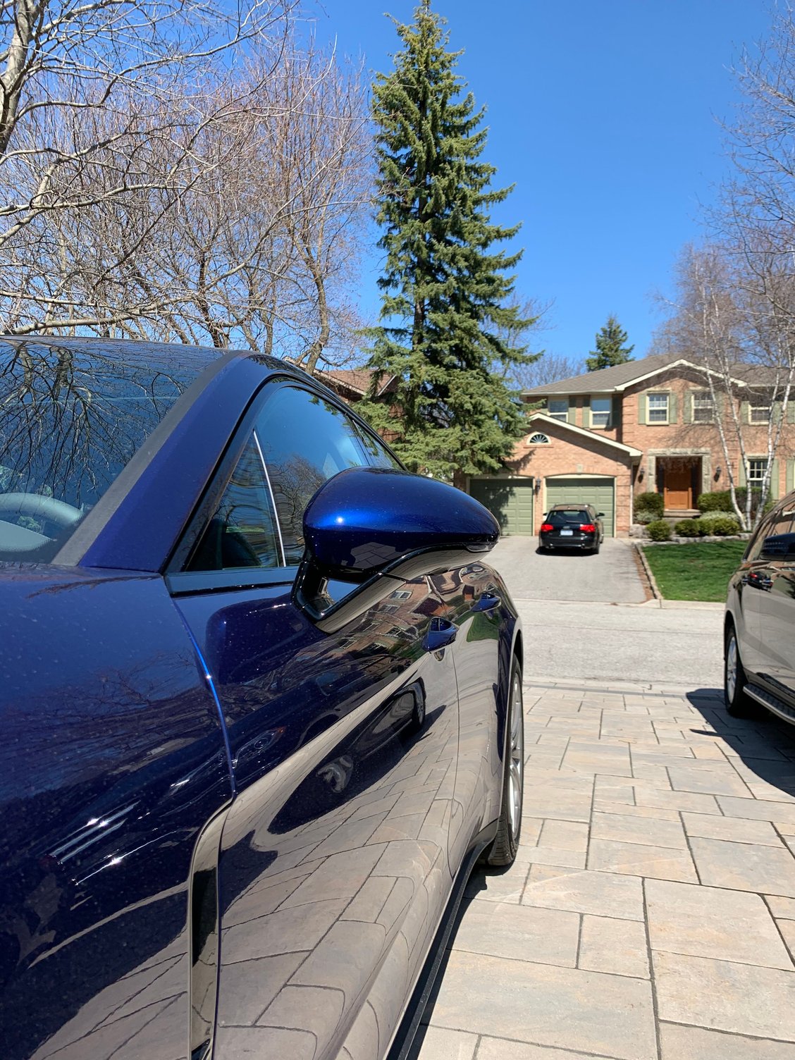

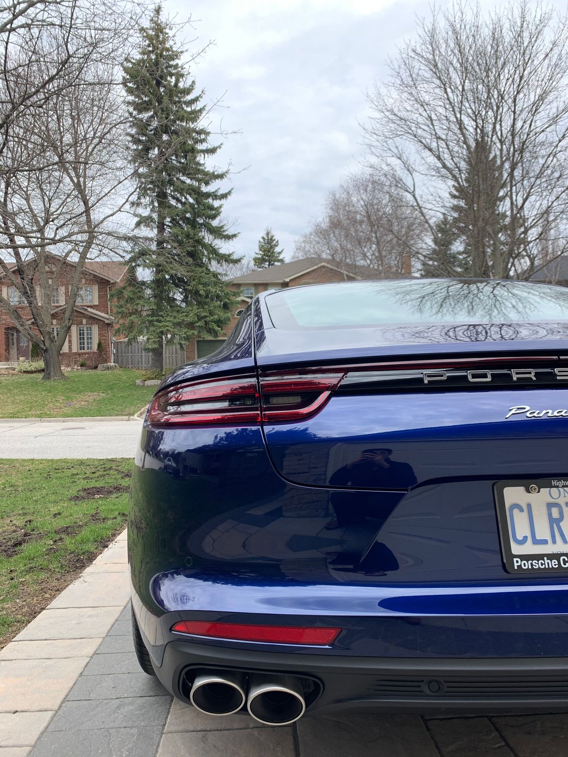

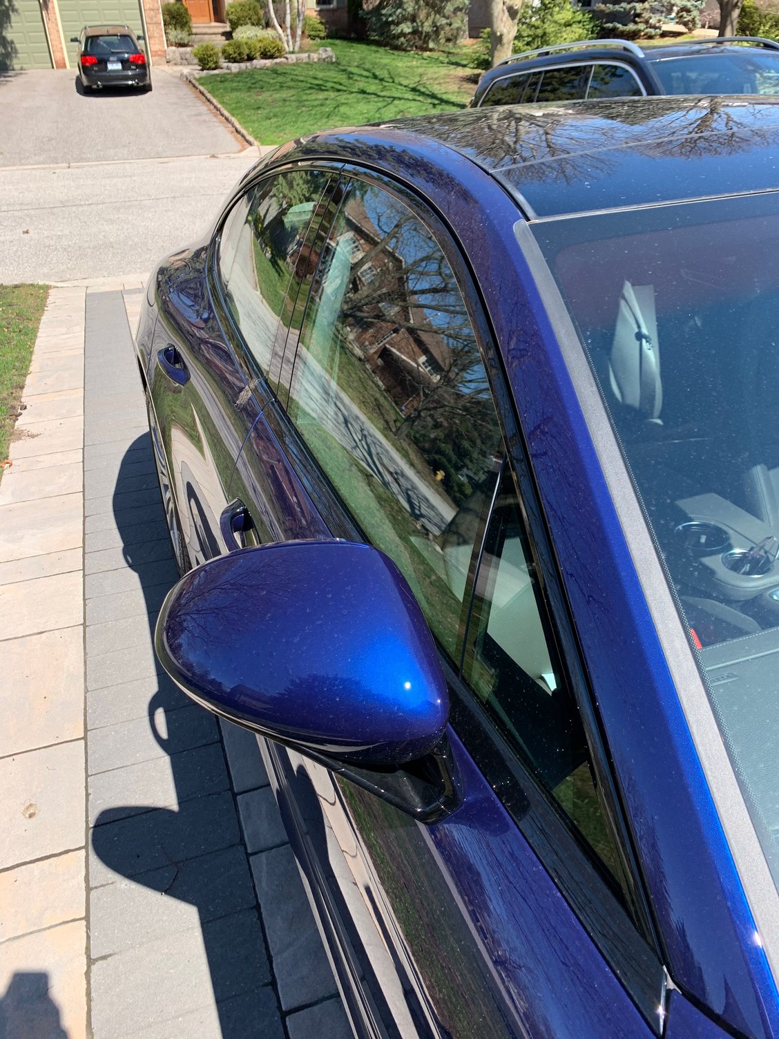

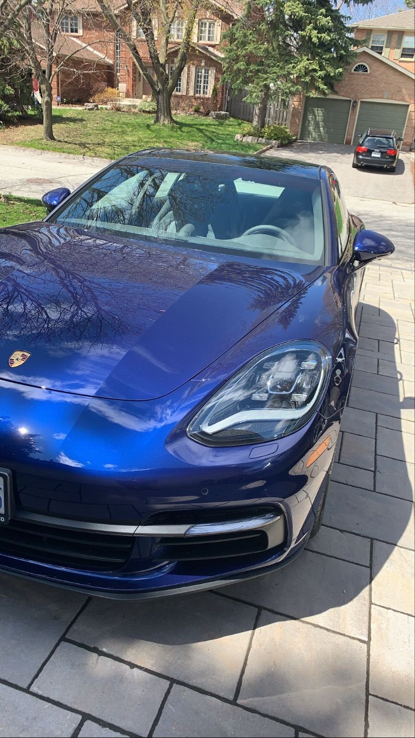

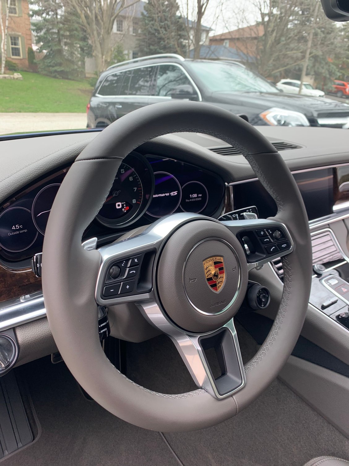

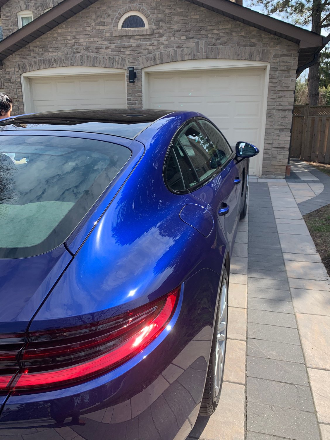

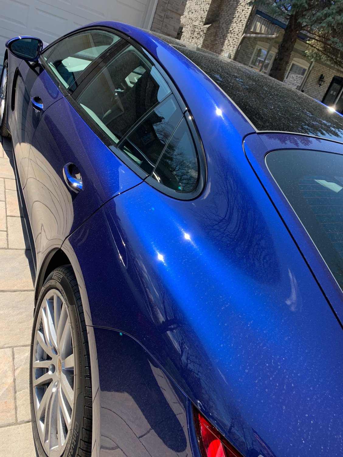

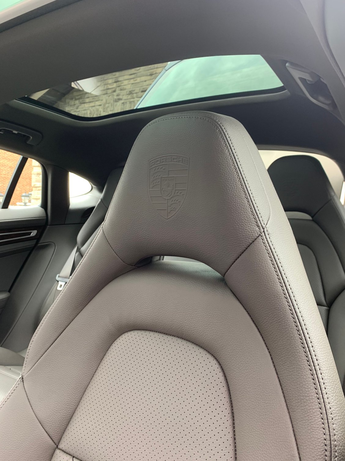

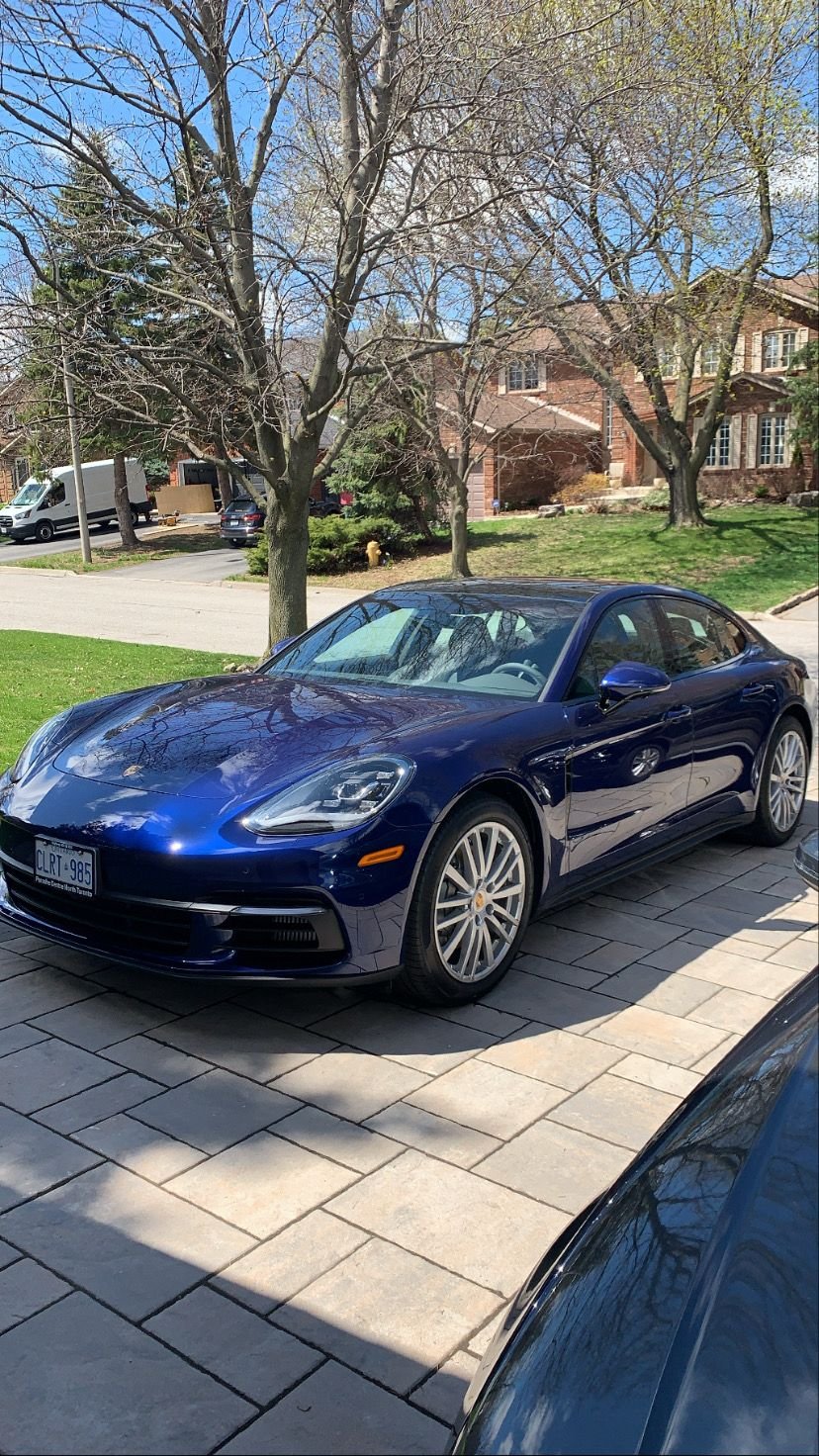

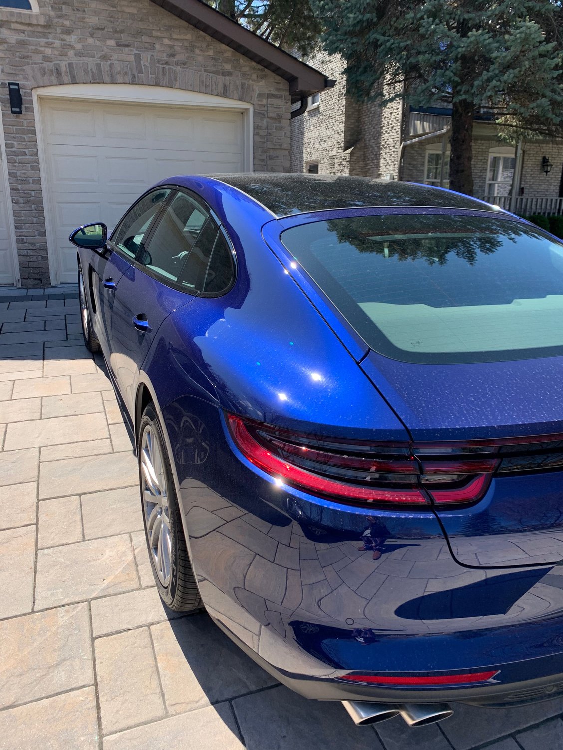

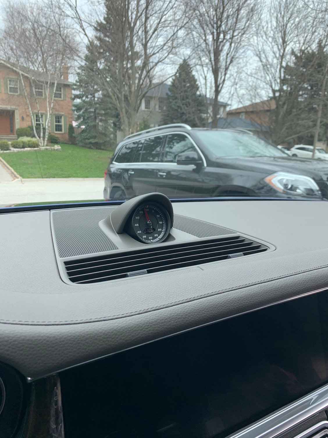

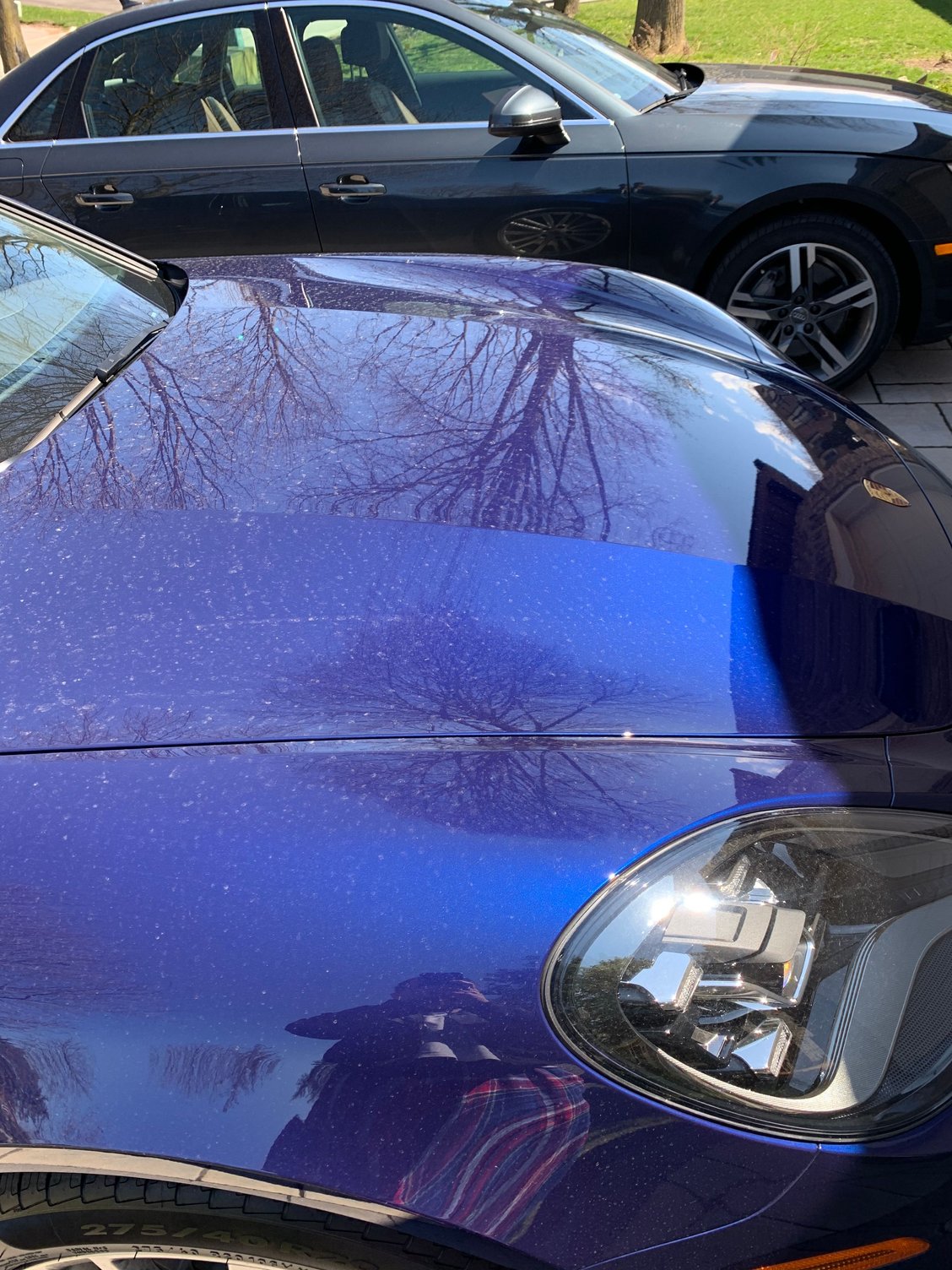

I just recently took delivery of a 2020 Panamera 4s with all the goodies (sport exhaust, PASM, rear wheel steering, sports chrono etc...) I’m wondering if anyone has bought and installed the racechip ecu upgrade for their 971 generation 4s (Petro not diesel). It’s supposed to give a 75 hp bump to 515hp and a 165nm gain in torque. It’s not priced that steeply (700 euros and taxes/shipping) so maybe it will be worthwhile?

Beautiful car
