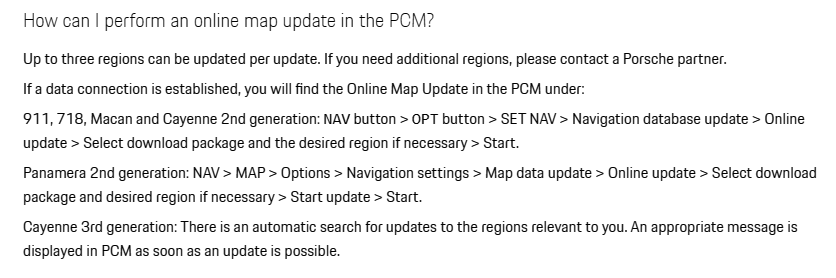

Still trying to figure out how to get by the "three update" limit for downloads, and found this on the Porsche Connect Store website.
My dealer is still trying to track down how to lift this limit. The FAQ cut and paste above says to contact a "Porsche Partner". My three downloads were the software update followed by "CA/NV" and "OR/WA". I now have the West Coast updated. I think of a region as North America, not as a few states. It seems the process is working as designed but not as any customer would expect. Limiting an upgrade to a few states is crazy.
