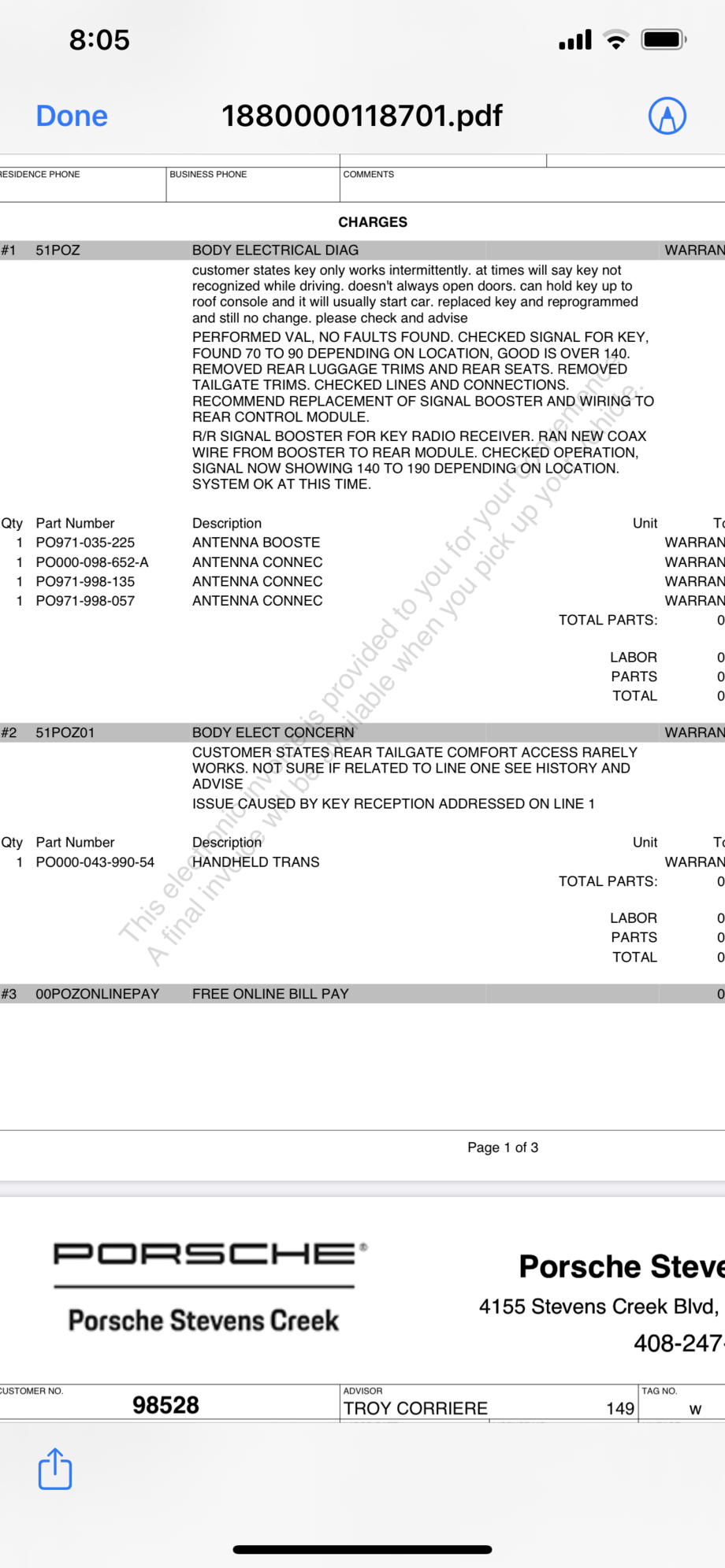

Yvette362's Avatar
Yvette362
Joined: Jul 2019
Posts: 41
From: Campbell, CA
Originally Posted by RSherman
I have just purchased a 2018 Panamera 4S, it was a PCNA vehicle. 3,000 miles.
I drive it home no problem. Next day the car doesn’t recognize either key.
i replace both batteries. Same problem. I hold key out of pocket and eventually
car starts. On occasion car sends signal while driving “key not found”.
So very frustrating...my Cayenne and 911 NEVER had this problem.
Half the time car doesn’t recognize key as I approach it to unlock.
I won’t mention I can’t program garage doors.
This is ridiculous.
sorry to hear that. I had to go back and forth several times but the dealer eventually agreed to open up the rear antenna and replaced it. Basically the signal was too weak. This was done in October and everything is great now. Here’s what they did so you can share with your local dealer.
Old Mar 17, 2023 | 06:57 AM
Alex400's Avatar
Alex400
6th Gear
Joined: Oct 2021
Posts: 6
Thank you @Yvette362 I did have the same problem like you. After a few trips to the dealer I pointed them to this thread. After some discussion they did replace the mentioned parts. And guess what? My problem has been solved as well. So I owe you a beer (or wine). If you are ever in the Netherlands, I owe you one!
Old Mar 18, 2023 | 07:24 AM
BertilDator's Avatar
BertilDator
Joined: Jul 2022
Posts: 43
Likes: 11
On my 2018, they first replaced the internal antenna, no effect. Then they replaced both keys and the control unit, and now keyless entry and start works fine.
