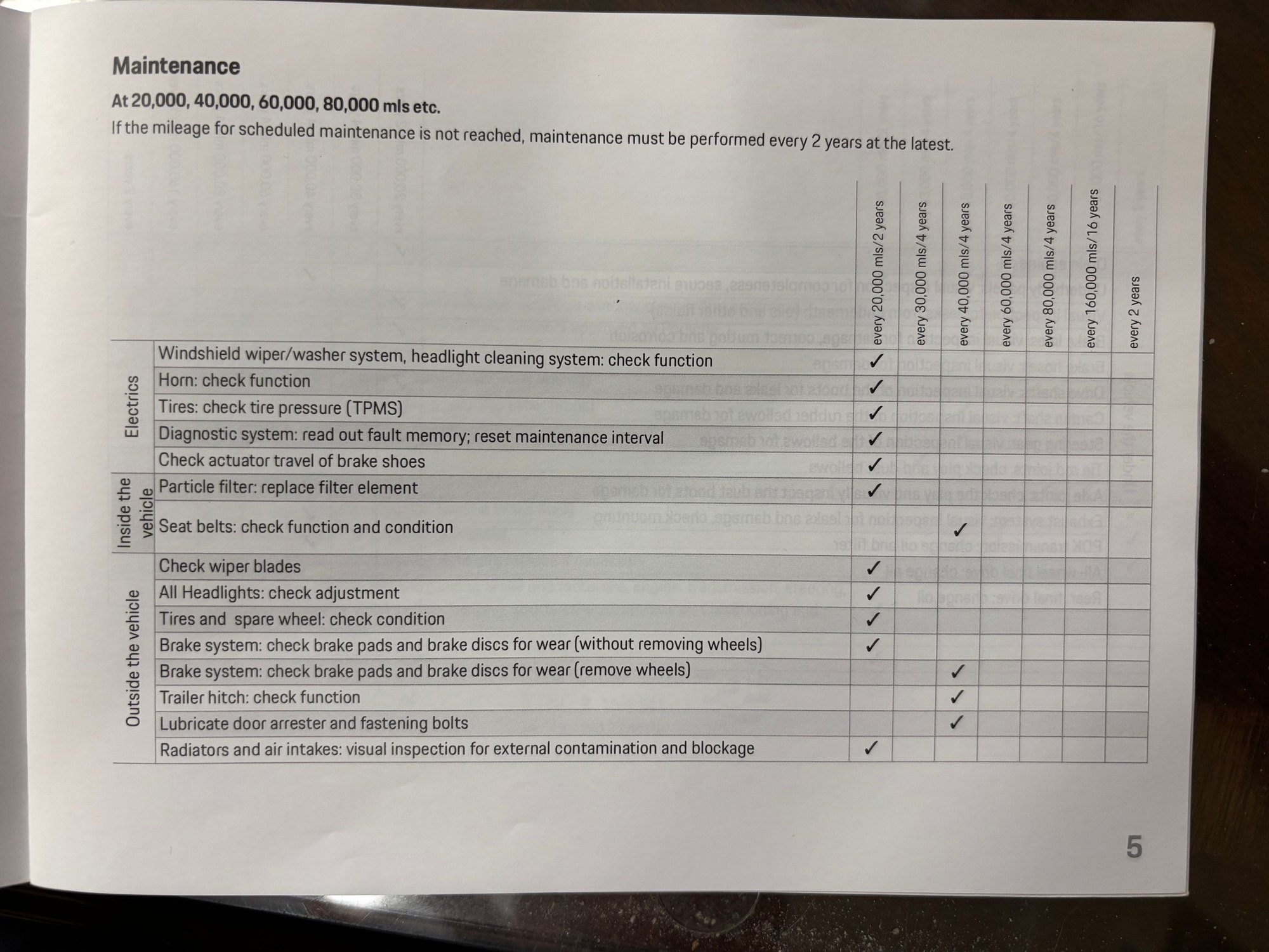

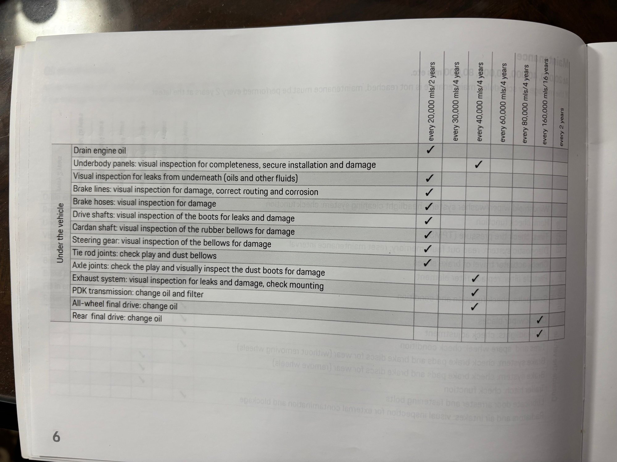

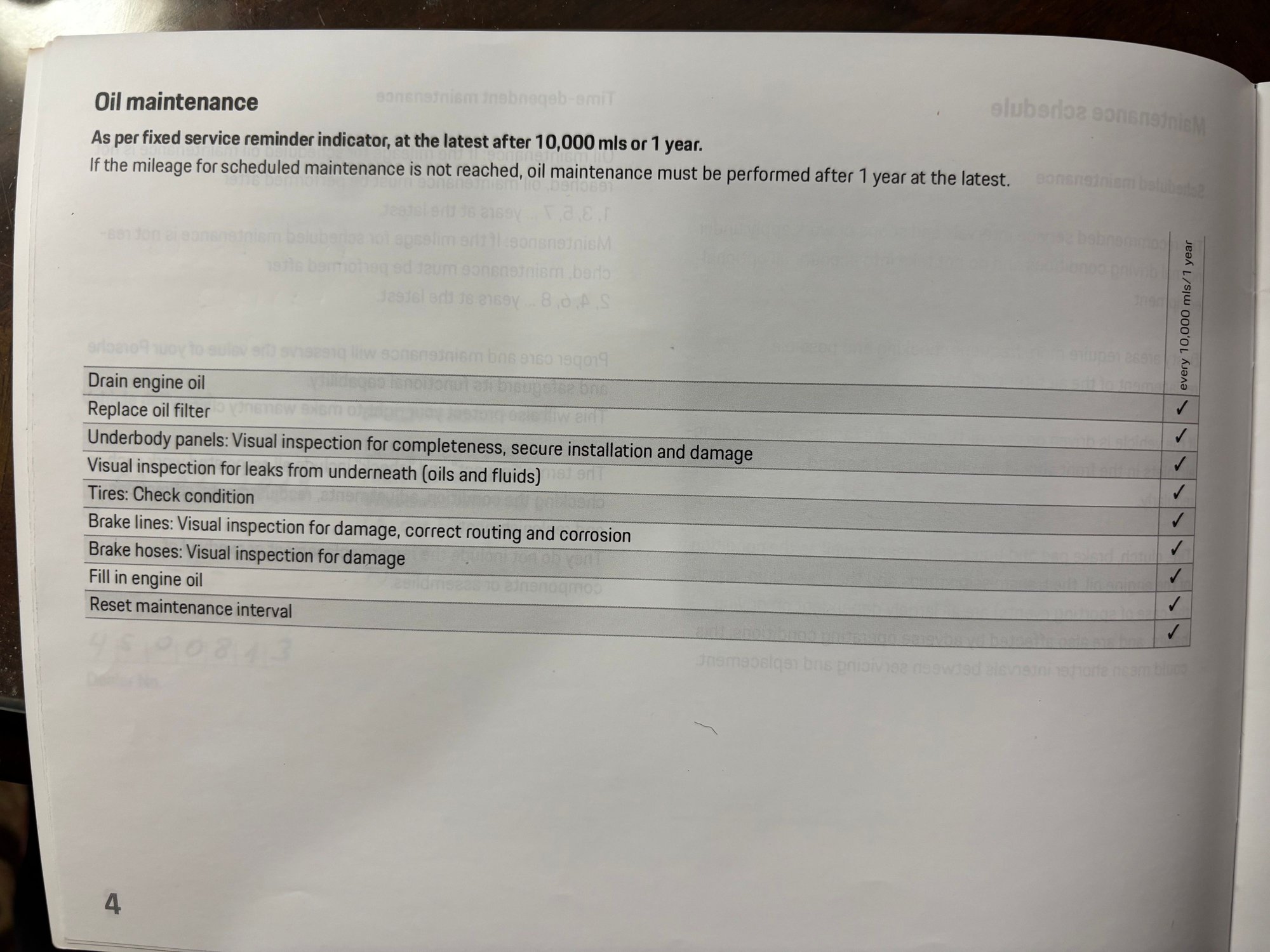

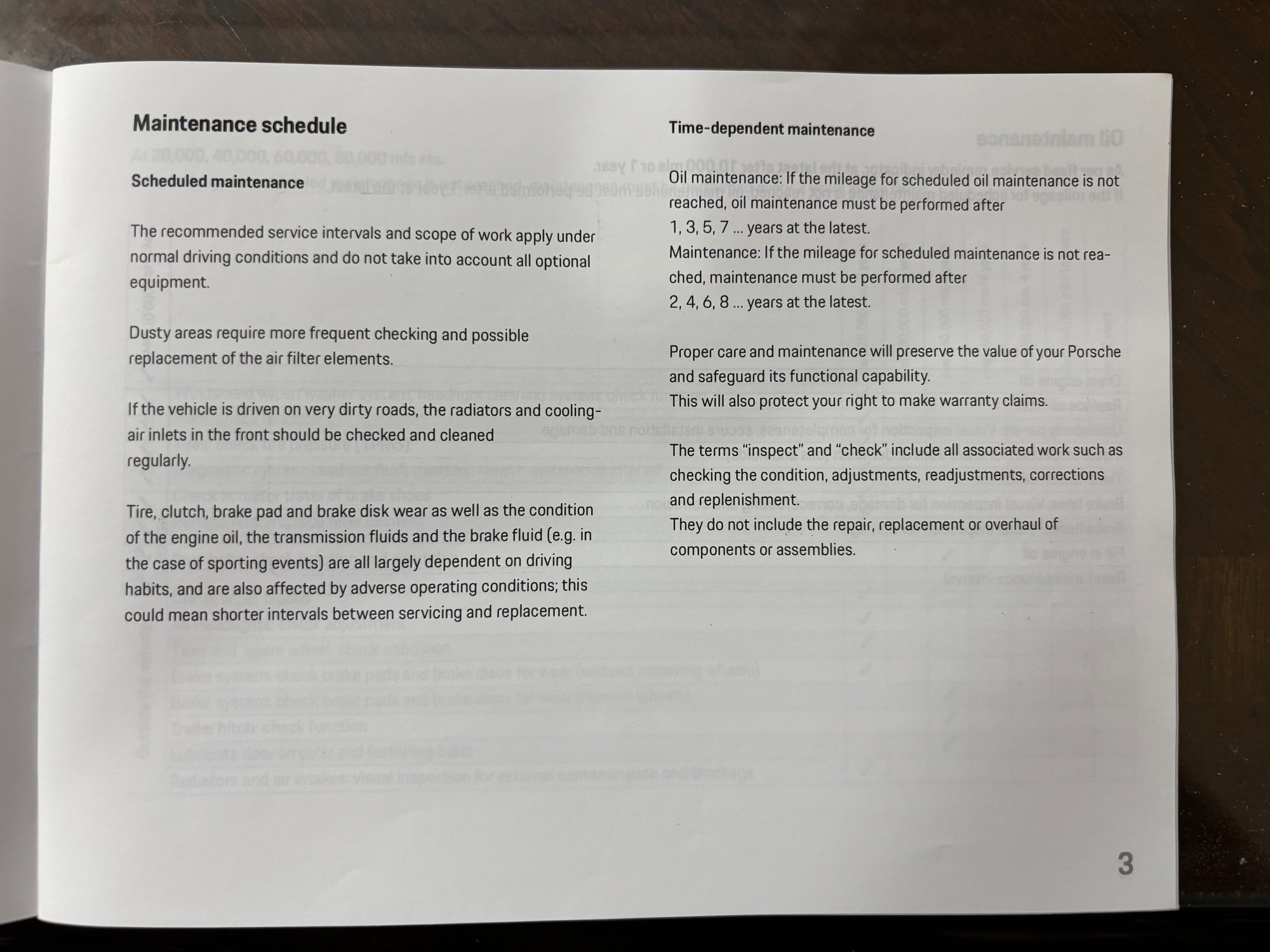

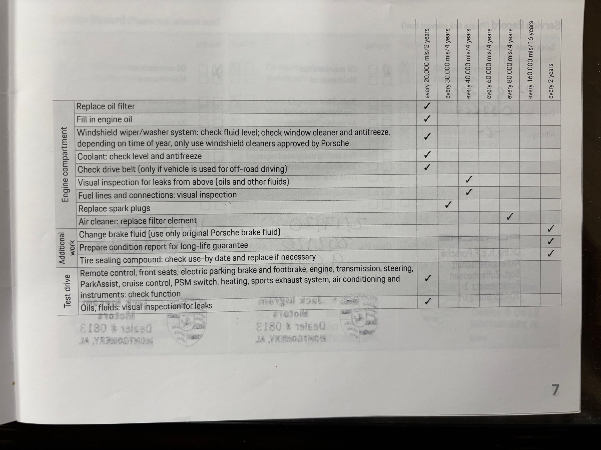

Can someone post (or point me to?) the factory maintenance schedule for a 2019+? I didn't see it in a forum search. I've been using google searches which turn up random screenshots of websites that aren't specific about year, or a "2015+" schedule.
I'm finding conflicting results; some say PDK fluid service at 40k, others at 60k. I think the 2015+ maint schedule calls for the 40k but later cars call for 60k.
Plugs seem to be at 40k or 30k (turbo), chassis control fluid reservoir (??) at 60k.
I also see a lot of discussion about transfer case fluid although I don't see that on the schedules I've looked at, unless I'm misunderstanding the term used.
Thanks in advance!
