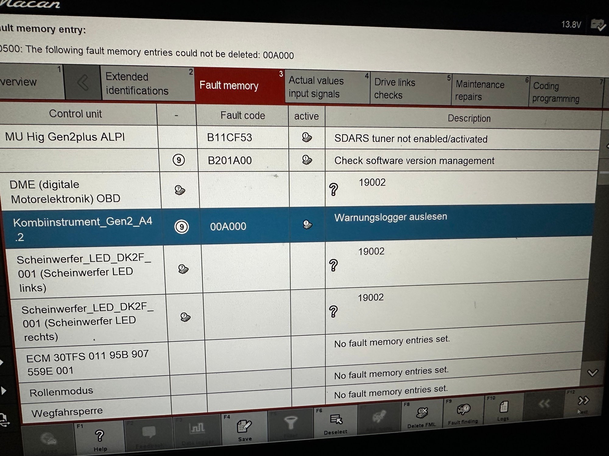

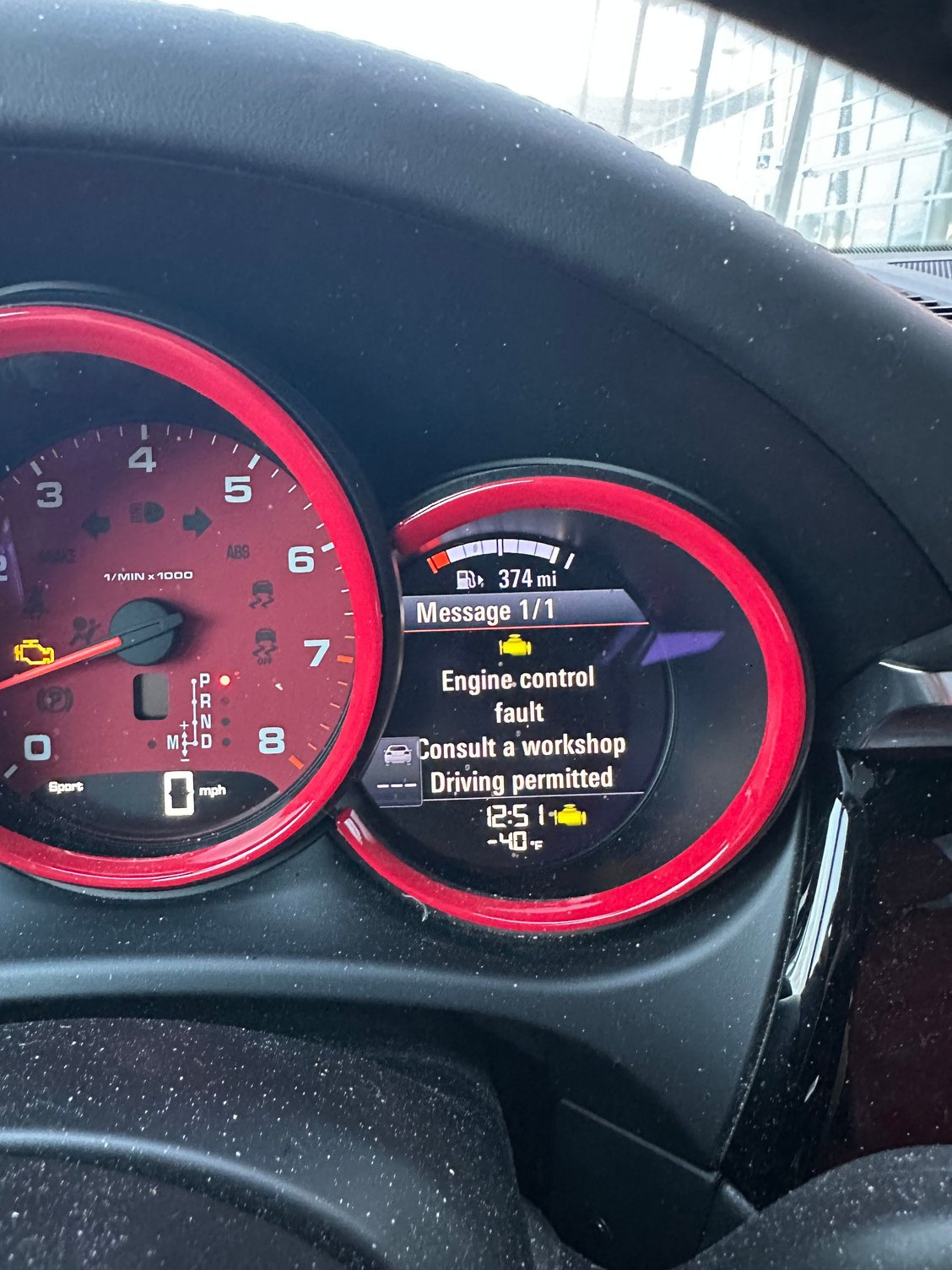

I wasn't going to stop in a dense fog to take a picture but when I got to the airport to pick a friend up, it registered -40F as shown. During the pea fog the CEL came on. I got home hooked up PIWIS and cleared the (frozen) data errors. I'm sure since the headlights are LEDs they don't heat up enough in their casing which perennially causes frost build-up inside the lens and no doubt comms errors (19002 is no communication with sensor). I don't have Sirius which is why it reports an SDARS error.

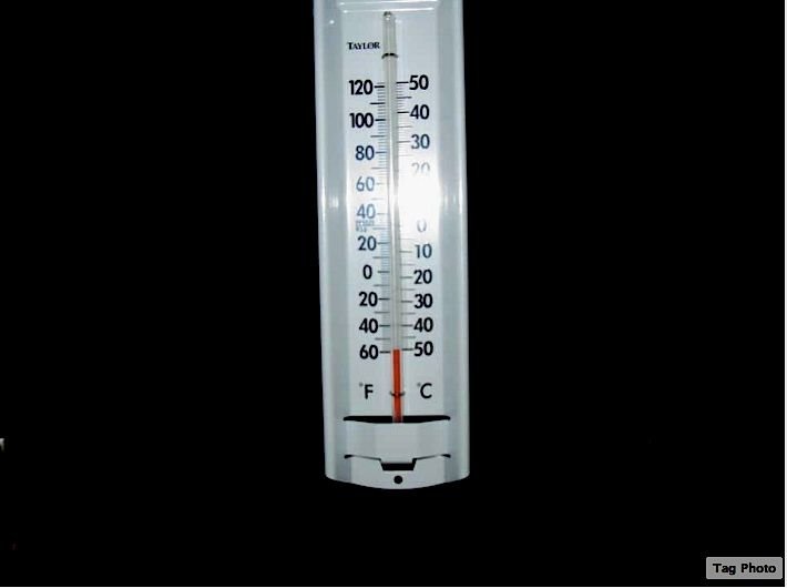

We'll be hitting the mark tonight... Tok is at -65F
It was as low as the thermometer could read

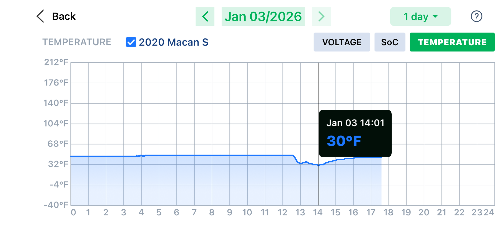

FWIW the temperature difference between where the battery is located to outside air was 70 degrees F

VDub forbids engine block heaters due to fire danger and I've never seen a P winterized (but then again the 992 folks have long ago put their toys to bed). In my stable ALL vehicle work year round, I didn't spend that kind of cash to drive it 2 months a year.
AAMOF when I was working at NOAA's CDA one of the employees had his truck catch fire from a block heater and nearly burned the building down. Other than Olga, my turbo diesel skid steer, neither the 992 or Macan have battery/tranny or engine block heater. For the 992, I'm limited to -20F due to 5w-40 oil, Olga and the Macan (and the recently deceased V8 Touareg) are on Mobil1 0w-40 good to -50F. We are 20 miles or so from town with little to no traffic so the car does heat up and the battery due to it's location as noted above has a near 50 degree temperature differential with the outside air. It does take a LONG time however, for the heated steering wheel (one of the most important "check the box" items) and seat to heat up.
