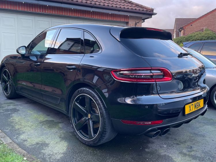

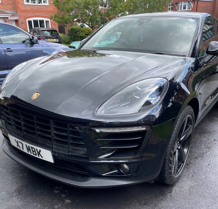

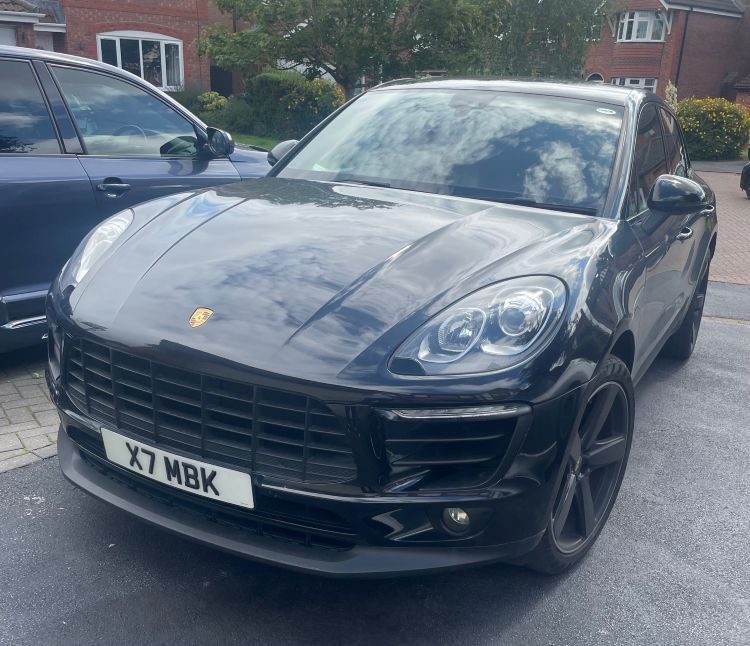

I totally appreciate the comments raised on this one, but I just can't help myself playing around with them. Anyway, all done now front and rear sorted, it's a fiddly job to do but you just need to change the pin configuration to get the new style rear lights working, and I also needed a front harness adapter for the headlights to work correctly, which I was sent with the headlights and then coding via a PIWIS. It was a head scratcher at times as little info out there so it's taken a while to get sorted, but the wife is happy with the end result, and as they say, happy wife, happy life!

No, but I have a contact that supplies all the OEM lights in China called Wei, he sorted everything out for me and I couldn't fault the customer service as he sent me the harness later to solve a problem we found with the UK pin configuration, plus arranged for an engineer to connect to my computer and do the coding as you need the PIWIS in engineering mode and once in this mode it's all in German so I couldn't work it out. I know he setup a new ebay shop recently so I've given you a link to it here: https://www.ebay.co.uk/str/testoem
As for the tailgate itself, then I bought this from an auto salvage breakers luckily in colour, so I didn't have to have it painted and it also came with the turbo spoiler attached, bonus!
