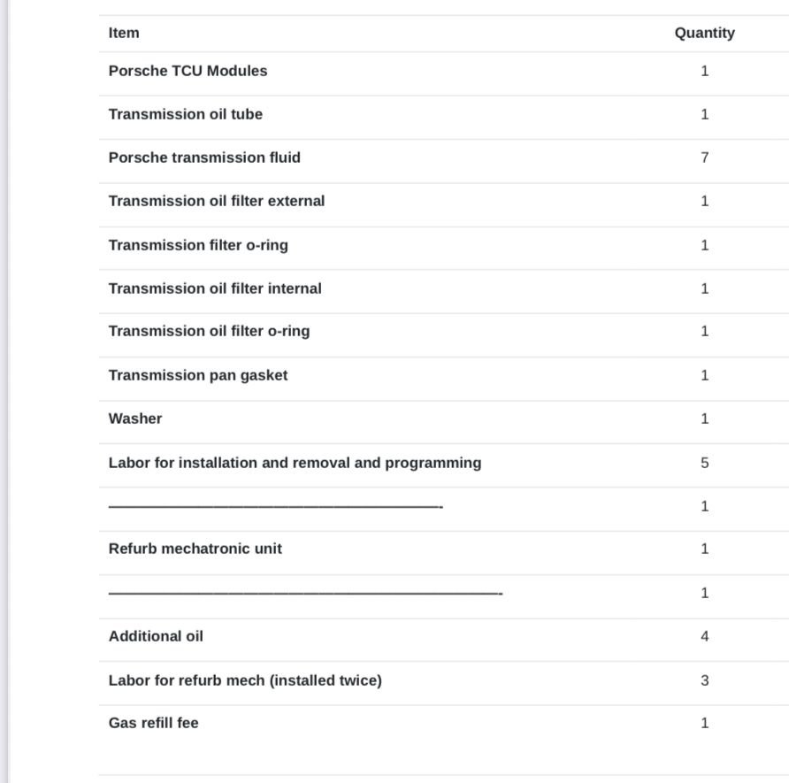

I’m in the market for a Macan and currently looking at a 2015 Turbo with very low mileage for the year (36k). The owner recently had the mechatronic unit overhauled with a refurb unit, and would be interested to hear any feedback or advice from experienced owners about this.
The current owner was upfront about it. Other than that, the car has a clean CarFax. The current owner bought in 2021 and put 10k+ on it, and it doesn’t give the impression of having been abused, so I’m thinking the issue might be connected to some original fault in earlier models.
