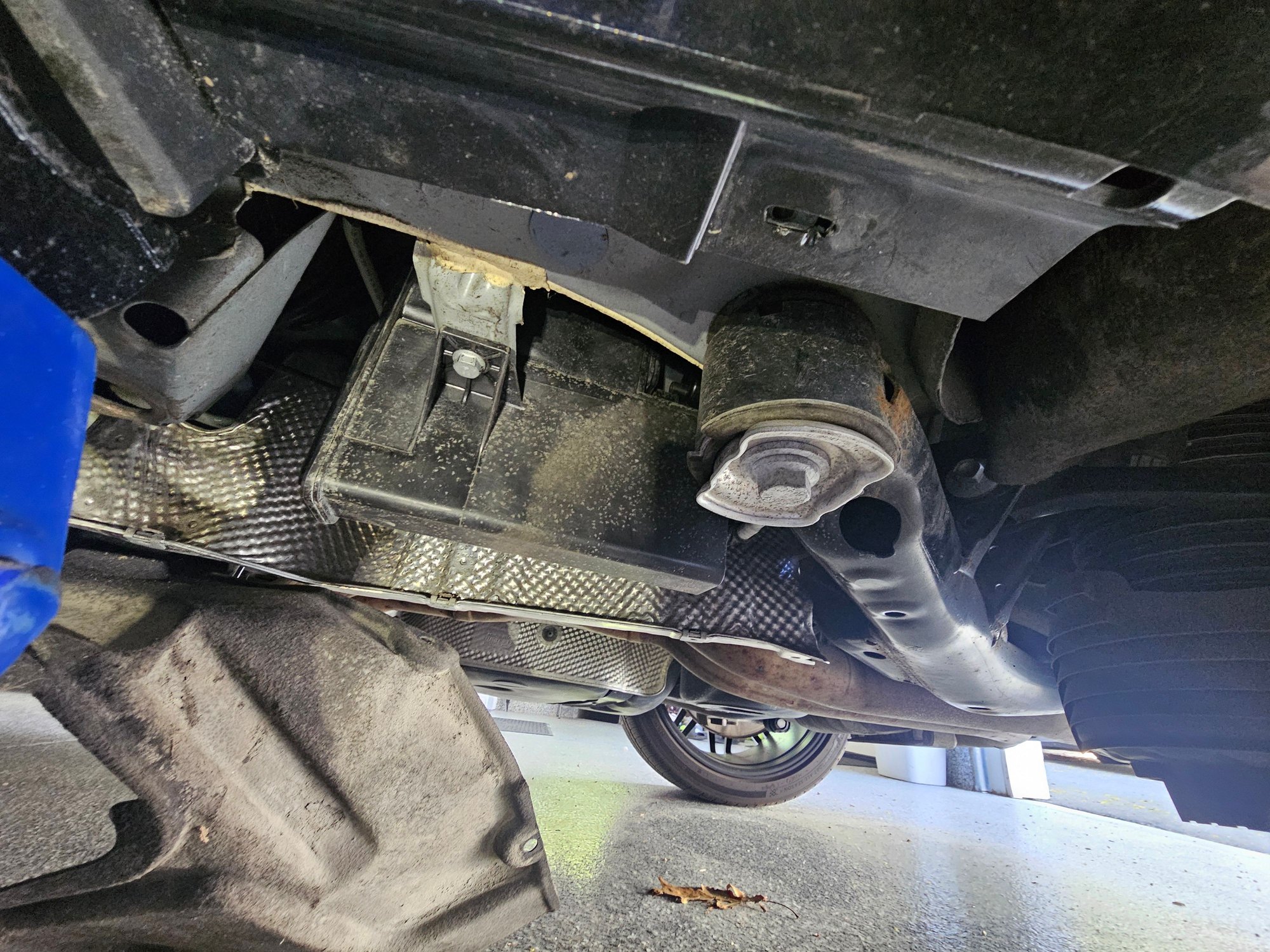

Over all job took about 2.5 hours. A lot of time was consumed trying to figure out how much to expose of the underbody panels. I removed the left rear wheel and liner and in retrospect is not necessary.
the technical bulletin is pretty general. You need to take down the whole apparatus including the charcoal canister to get to the leak detection pump. Reuse the rubber adaptor that connects the pump to the canister.
Otherwise CEL P2402 seems to be gone. Hopefully I didn't create a leak putting everything back together
Pump part number: 958906243a
tools: T10, T25, 13mm socket
Electrical plug going into the pump
Canistwr dropped with pump exposed
Re-install
Re-install
