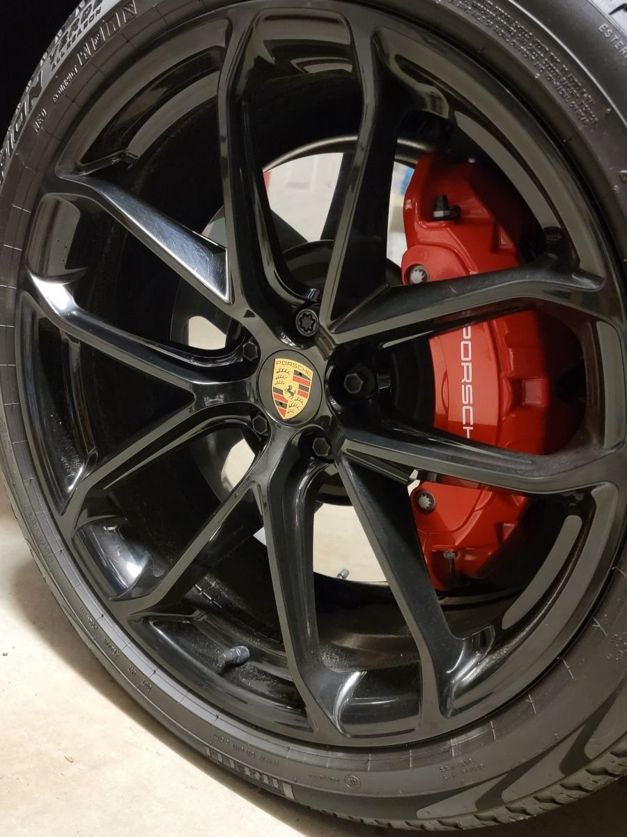

Thanks Carlo. Do these fit third gen 22+ GTS Macans? They are quite a bit cheaper than OEM pads via Suncoast. Looked at FCP Euro and they only carry OEM Porsche for PSCBs. Funny they list pads for "Red" calipers (which I think are steel rotors not PSCB) but my calipers are black not red or white.
Old Jul 30, 2025 | 10:03 PM
  #85
ShiftyWolf's Avatar
ShiftyWolf
Joined: Nov 2023
Posts: 660
Likes: 354
From: Central Florida
FYI, my 2024 GTS calipers are red. Black is an option for PSCB on the Gen3.
