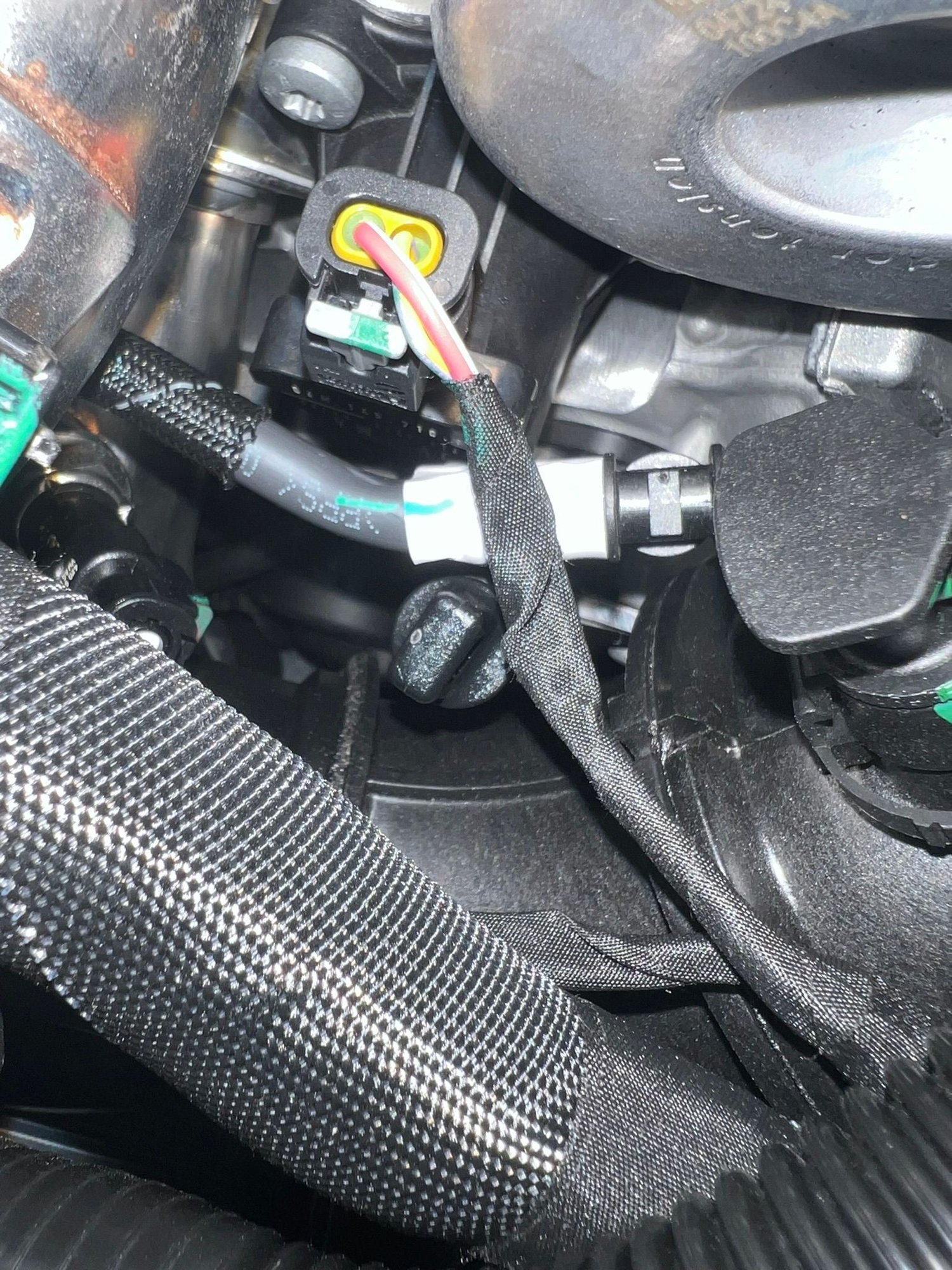

Is this the capped pipe where the dipstick would have gone?
Dipstick cap?

Correct. Loop a zip tie through the hole in the cap so it pulls out easier and not be dropped. You can find oil extractors on Amazon. Some are manual, some are electric pump.poweted.
