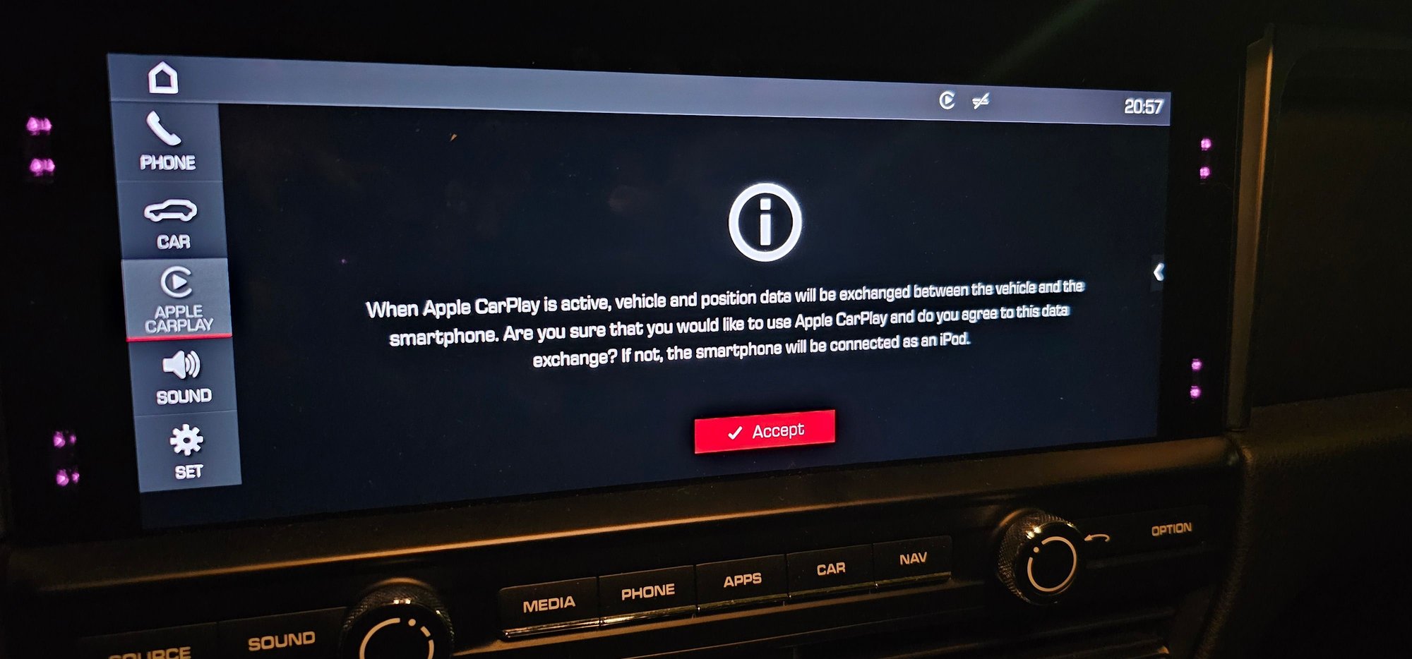

I hit the exact same issue on macan 24. While browsing for a a bit i suddenly notice a pop up in the pcm chosing between usb and android auto. When i tapped android auto seems like its going to work but then its nada again. And its not easily replicable. Not sure how to fix it. Will drop the screen shot if it pops up again. Anything helps.
It's easily replicable if you factory reset the PCM5. After that, you will always get the fkn screen.
I tried wiping out every Bluetooth from the phone, then plugged the phone while in this screen
Tried setting up android auto in the phone, basically tried lots of things with no luck.
Seems I'll join the paid ones club.

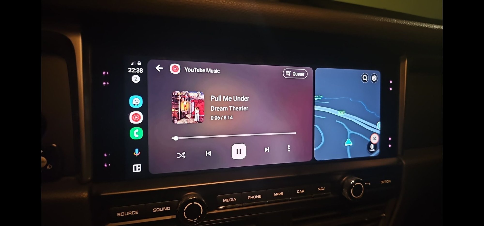

Posts: 18
Originally Posted by kndh13
Do you know your firmware version and region?
Yes. Firmware is P9830 and region is ER (europe), same my car had from factory. (Im located in Chile, South America).
By the way, this was the final result
Regards
