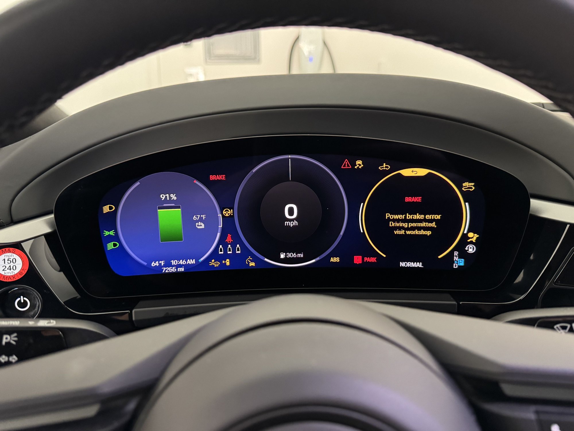

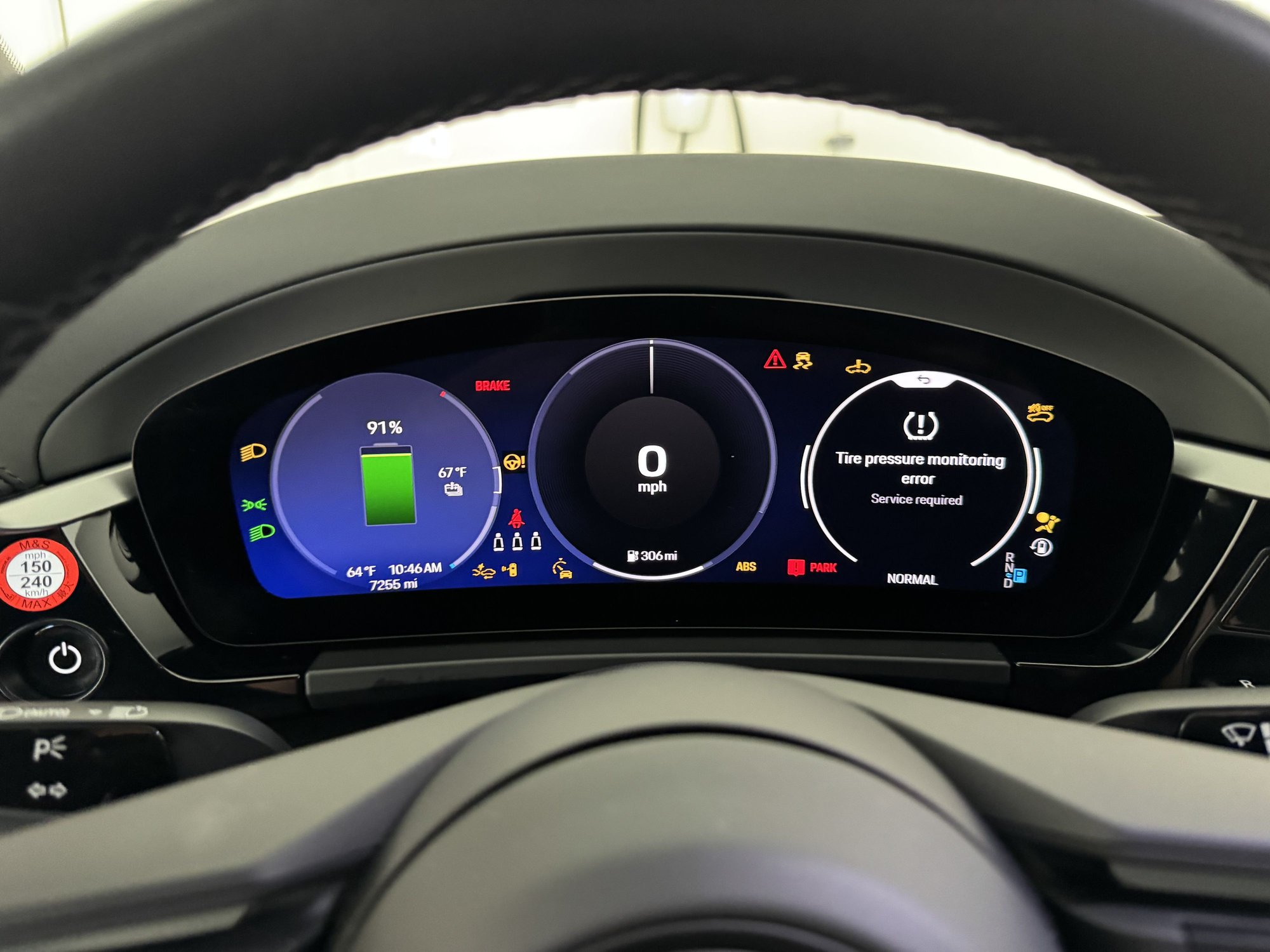

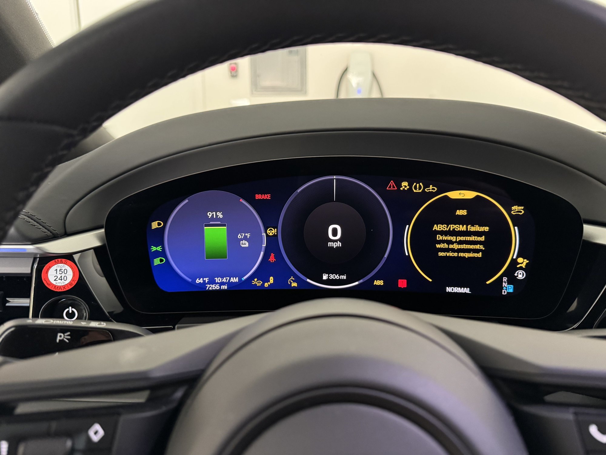

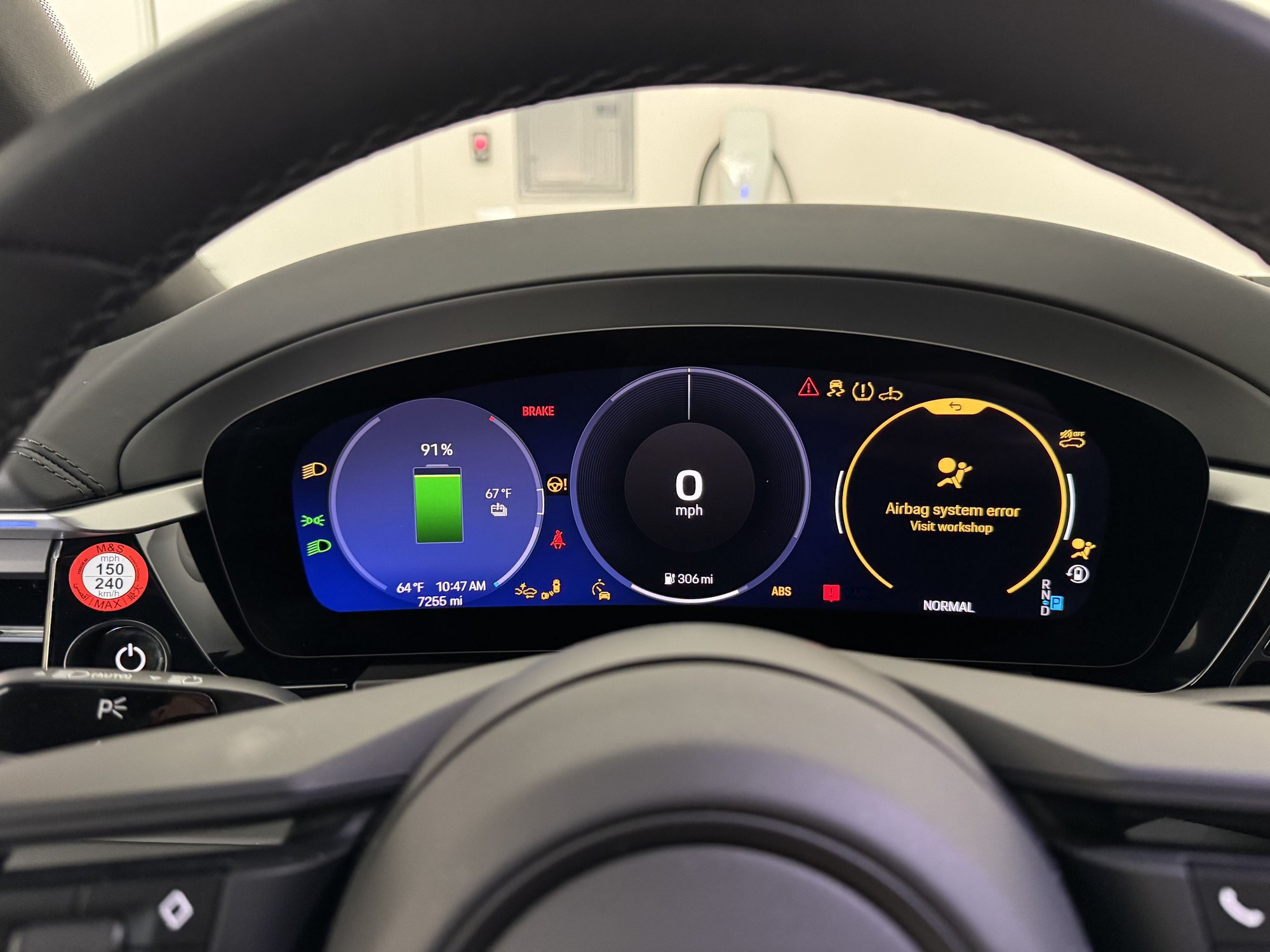

6 months old brand new Macan 4 EV with only 7K miles. Was about to head out this morning and it constantly show all the different errors. I guess it's time to visit Workshop.

Did that lightshow disappear after turning the car off and letting it sit?

That looks like a power glitch. If you shut things off, left the car, locking the doors. Then return 30+ minutes later, do the malfunction indications clear?.

try resetting your car. Hold down the volume button on center console (by your ac controls) for 30 seconds until car reboots.

Maybe your 12v battery is going out?
