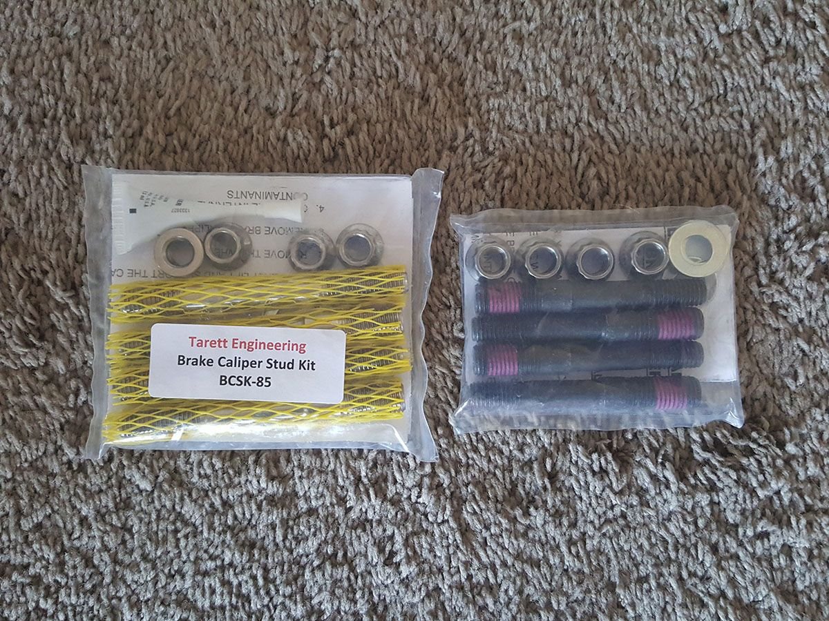

Originally Posted by DeerHunter
Looky what just arrived:
Now if I could get my car back from the detailer, I could do a trial install.
Why do the longer studs get those fancy yellow mesh jackets?
The black ones are PMNA Cup studs (for the front). The longer ones are stainless steel and I guess it's just for extra protection.
Also, anybody happen to know the correct socket size for the 12-point nuts?
The outer diameter is 12 mm. I may have to pick up a socket that will work with these.
