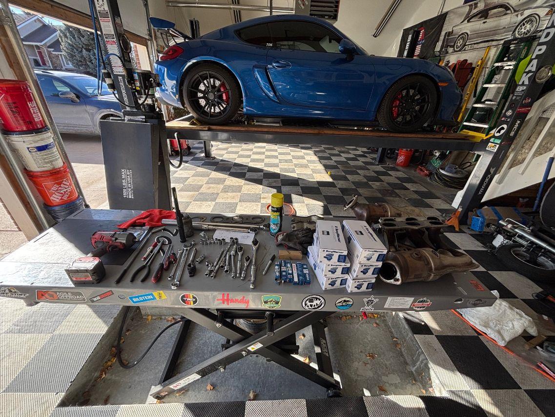

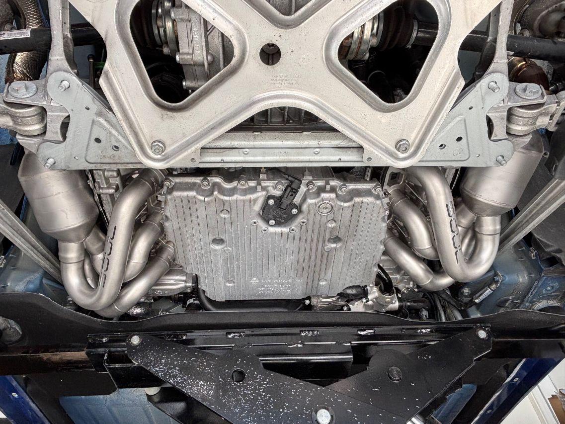

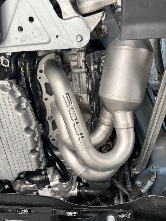

Ok, was back at it yesterday, the day before I removed the stock headers, replaced the spark plugs, coil packs and installed the Porsche heat shields. Soul headers are in! A few notes that aren't in the directions, I removed both diagonal braces. This gives you ALL the room to work and I'd highly recommend doing it. I removed the two brackets that hold the stock header mount, the Soul headers don't use them and they got in the way of the Soul header fitting on the drivers side and was uncomfortably close to the header on the passenger side. For the rear O2 sensors to reach the bungs, I had to remove them from their wiring hold downs. I did check where the wiring is, it shouldn't chafe or burn through, but I'll be checking it closely. I had to run out to Harbor Freight to buy a different external torx socket, I needed a deep one as it had a thinner neck, there were a few header bolts that sat really close to the header runner and I couldn't get my shorty e12 socket on them. A wobble, plus wobble extensions are necessary to install the Soul headers. I didn't need them to remove the stock ones, regular extensions and my regular e12 socket got it done there.
Here's all the tools I used
