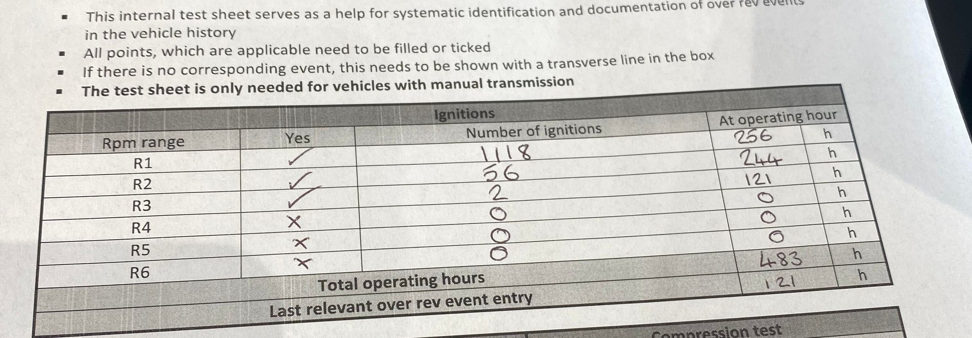

hi please could you let me know your thoughts on the
attached rev report - 2 in rev range 3, at 121 hours, car has total hours of 483 hours.
whats opinion on rev range 1 and 2? This is deemed fine right? Comes with full 2 year Porsche warranty from OPC

That's a good report. If I remember correctly there are 3 ignitions per one revolution of the crankshaft. You can get a range 1 report simply by hitting the redline.
