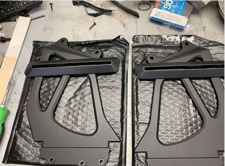

The packaging of the risers was top notch, each side labeled and sealed in a bubble wrap package, inside a large secure box, well sealed and complete with pry tools and the previously mentioned instructions (really can't say enough about the quality of the install instructions).

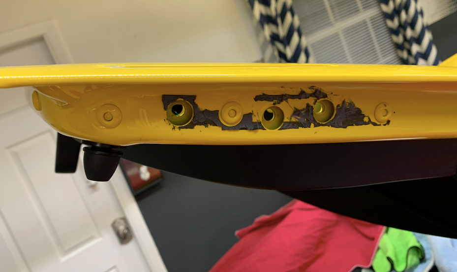

Couple tips on the install, have a friend help with wing removal, also the hardest part of the whole thing was removing the VHB tape adhesive that comes on the factory risers. A PRO TIP, USE TURTLE WAX BRAND BUG AND TAR REMOVER AFTER CAREFULLY HEATING WITH A HEAT GUN. ONLY USE THE ISOPROPYL TO PREP THE SURFACE FOR PLACING THE NEW RISERS BACK ON. the provided pry tools (which i couldn't believe they thought to include) are the only area that I feel are a little lower quality, I ended up destroying them pretty quickly and instead used my panel removal tools (I use them for interior panel removal).

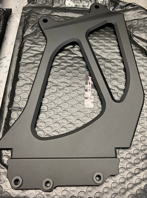

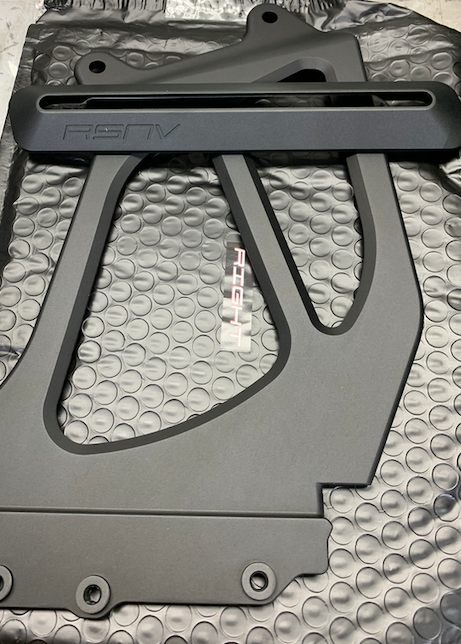

The quality of the actual risers is very nice and easily on par with the previously mentioned SA and far superior to the other available options, I have discussed with RSNV briefly about offering a "naked" version that would allow painting to individual preference, which i think would be an excellent offering, but the standard finish is of the highest quality.

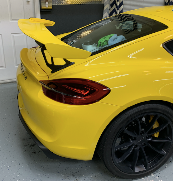

I find that visibility is a little limited when looking for cars coming up behind you from a distance (would be with any higher wing), but that detriment is easily offset by the benefit of much better visibility when reversing in to a spot.

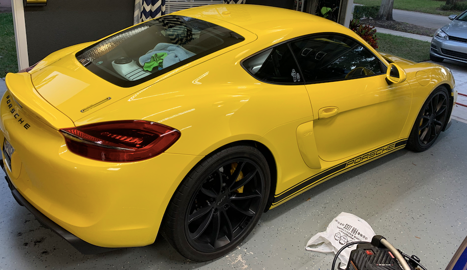

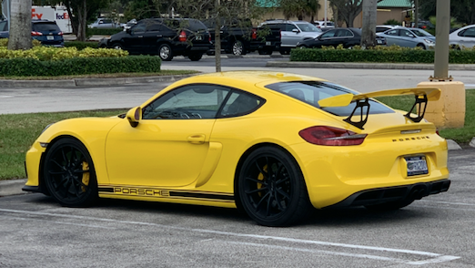

before
very high quality, great packaging
post install
digging this touring look a lot!
this stuff is miserable to get off, make sure to use turtle wax bug and tar remover.
I used 3m VHB tape and cleaned the pieces that cover the screw holes so i could reattach them, look factory as F.
subtle but taller, the height that porsche should have made it.
the whole reason I installed these was for my daughter, nicknamed piglet, to have something to lean on.

Is there any angle of attack (AOA) adjustment with the RSNV risers? How does the AOA compare to stock? Mounting the wing higher will increase downforce and drag given the same AOA, but it looks like the AOA is more aggressive too.

The stock AOA adjustment is on the wing rather than the upright, so if it fits the OEM wing then will have the same AOA adjustability.
The AOA compared to stock will require someone to use inclinometer on the RSNV risers vs stock (preferably on the same car in the same position before and after install so everything else is equal (tyres, wheels, pressures, floor, etc..)

Since the wing is sitting higher, wouldn't you want the angle of attack to be less?
As a guy that tracks his GT4, that's what I worry about with all of these different wing risers - how do they affect the aero balance of the car? They have got to throw it off vs stock, which worries me at track speeds.

Correct. You would need the wing riser AOA to be less than stock for the downforce to be equal as increasing the height of the wing will naturally increase downforce with everything else being equal (in most cases, you do get to a point where you will get wing stall but doubt it is the case here).
But the increase in downforce shouldn't be enough to overly upset the balance of the car and I would be surprised if you could feel the difference.
